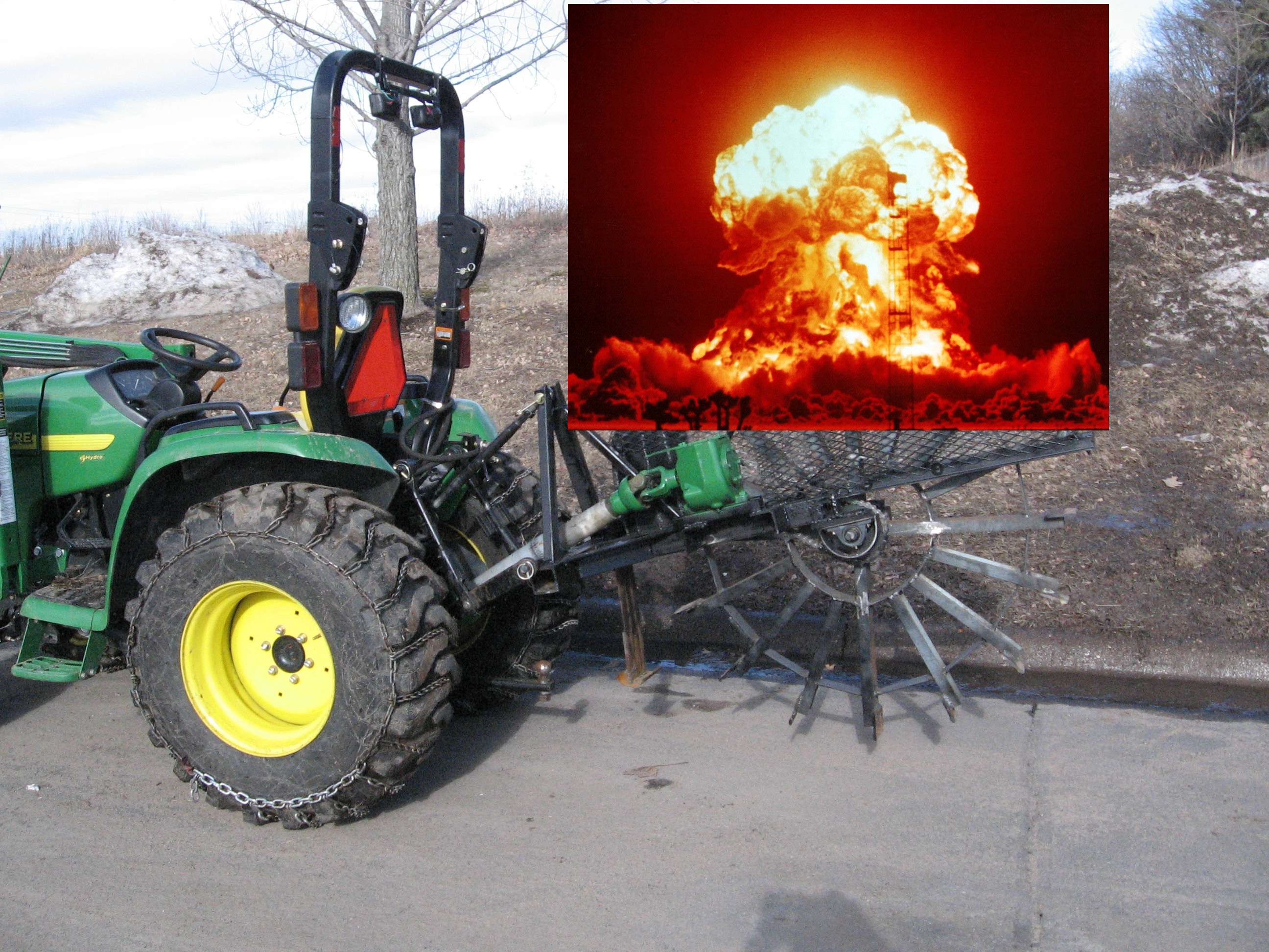

Tough crowd:eek: Great results on the initial efforts. Maintain a healthy respect for the cautions provided. Don't let complacency give the "thomases" the last word.......Can you come to my place and butb a trench from my garage to a small barn? Its only about 300' and there are no rocks or roots.....I think:rolleyes:
How much clearance is there bewtween the guard and the wheel? I'm just picturing my snow blower and the bolt shaped groove pressed into 5" or so of the steel fan shroud....I hit an errant bolt and the heavy guage steel has a nice groove in it about 5" long. It didn't take long and the blower stopped but it could have been worse.

Awesome tool and great results. If you are worried about hitting immovable objects, you could put on a slip clutch from a bush hog.

Ok you doubting Thomas'. Had a chance to hook it up and try it for a few minutes tonight, just before dark. Mostly because I know you guys want to know how badly it will self distruct!! :D
Well I only dug a trench about 15' long and 19" deep. It worked well except for the telescoping front guard. There is not enough slope at the bottom of it to keep from digging into the ground so I will have to weld on a bigger skid plate. Other than that it worked as I expected. Even piled up the dirt beside the trench. I'm surprised that worked.
Only ran the tractor at 1500 rpms which did not seem to put undo stress on the trencher. It did make the tractor work a little.

The attached picture shows how the dirt deflector was added. It was just a guess where to put it and how fabricate it. So I am very surprised that it works as well as it does.
I never expected this thread to get so long but it's good to see that it provided you guys with some entertainment. :)
Great job. That looks like it's going to save your back a lot of work. Now, about that welding machine in the shower stall, don't you know water and electricity don't mix!:D
