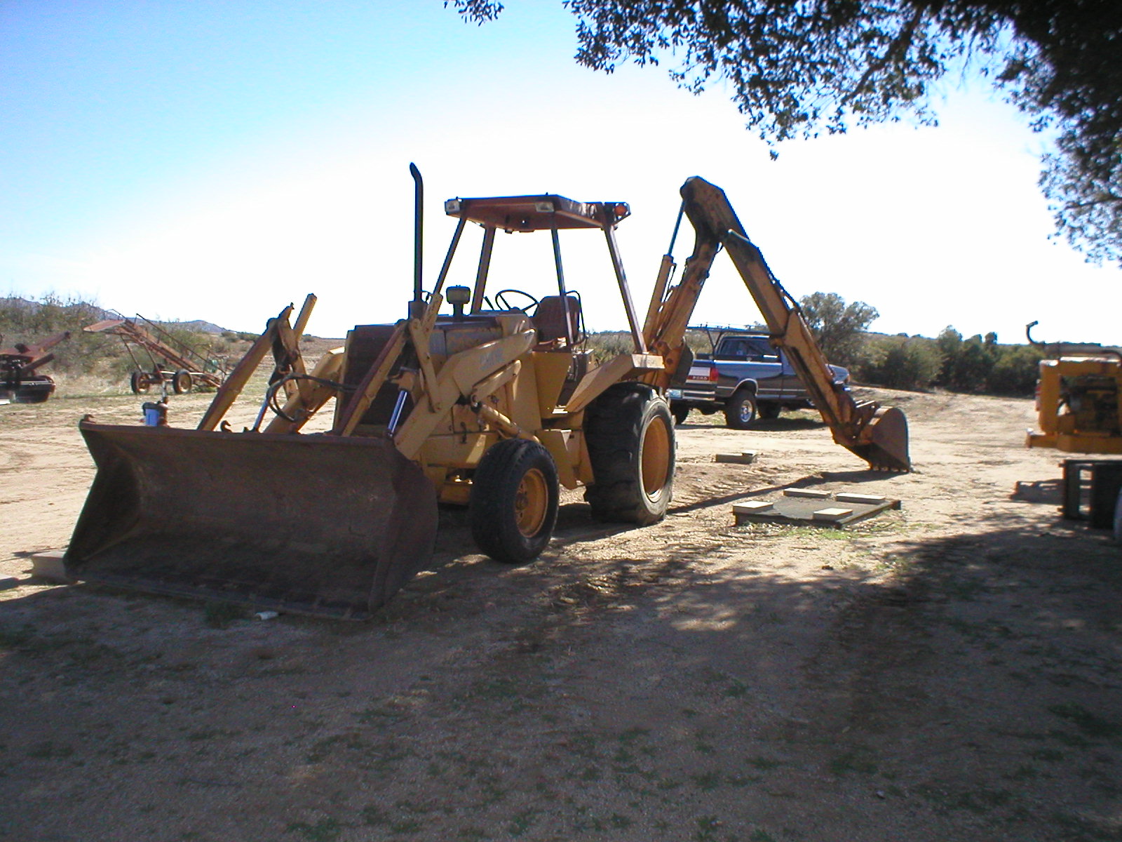

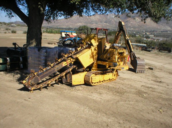

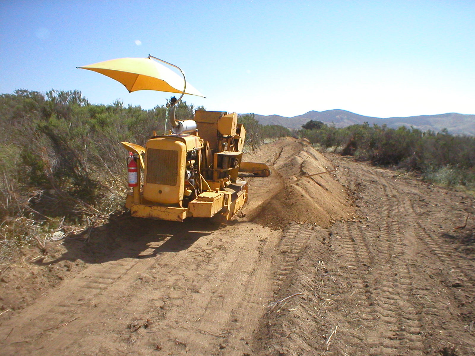

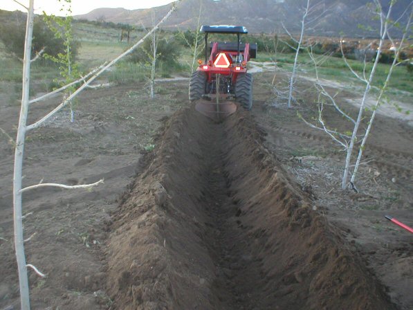

while what you have said is what worked well for you, what has you thinking that this is what the OP needs to do? We have over 4800 feet of 3" line buried about 54" deep. Over 1000 feet of 2" buried 18"-24" deep. No problems so far going on 12 years. I just wish that the other 10,000 feet of pipe that needs to be in the ground was. Now what we have done has worked excellent for us, but I would not even think that it would work for someone in a different location without at least knowing the persons location. I think that it very well may be just a bit over kill for the OP. I will agree about the doughnuts though, doughnuts go a loooong way towards good will. In fact I would go as far as to say that not only will everyone treat you better, but you may very well save hundreds of dollars with additional visits.

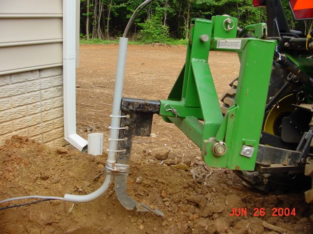

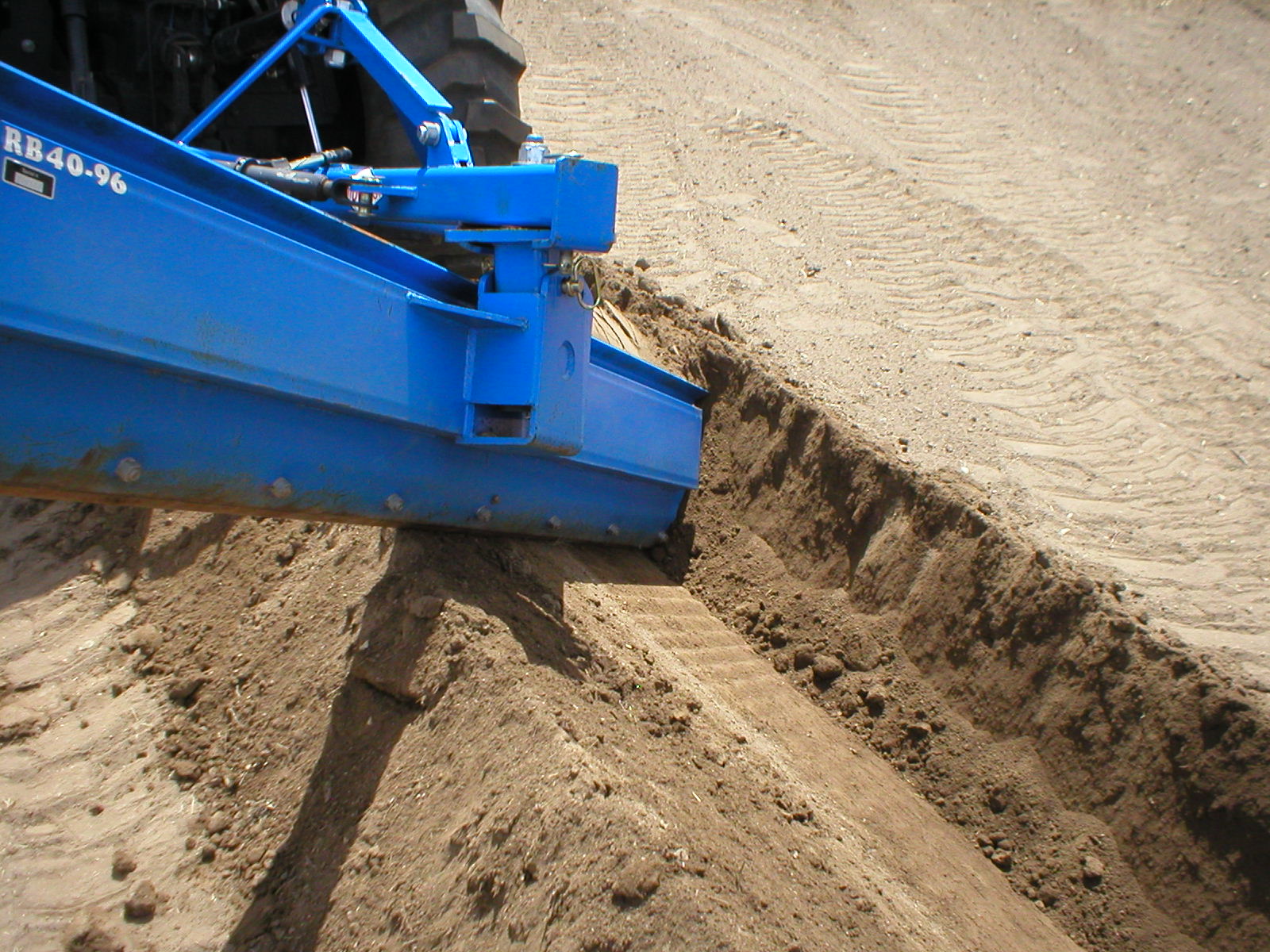

Here are some pictures of what we use for trenching, nothing faster than the ditcher for a nice quick 20" deep trench though.

You know? I just saw these pictures and had actually thought about trying this with my $1,599 frontier back blade that actually pitches a bit steeper than this photo. Seeing it actually being done gives me some inspiration now.... I have the offset feature, so I could offset it to miss my rear tire so I can straddle the ditch and really burrow in.
Is it better to straddle the ditch and run over the dirt with your tires or to have your tire in the ditch and straddle the dirt? It seemed like it was easier to have the tire in the ditch to me. Second time around the tires just follow the ditch. I guess if you can get the ditch deep enough in a single pass, it would be best to be cutting the ditch directly centered behind the tractor. Whatever works for a person, any of it has to be better than a pick and shovel. ;)
