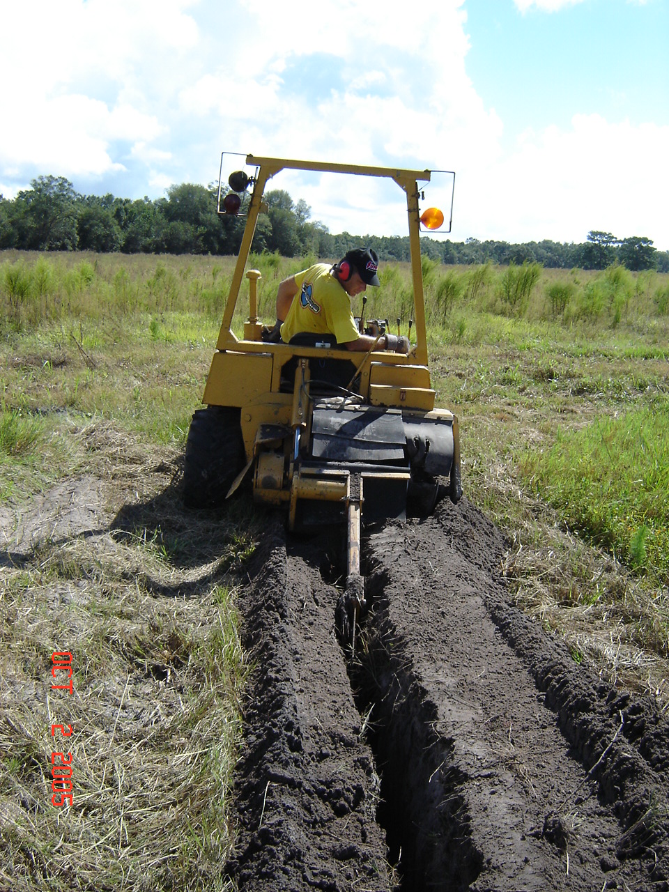

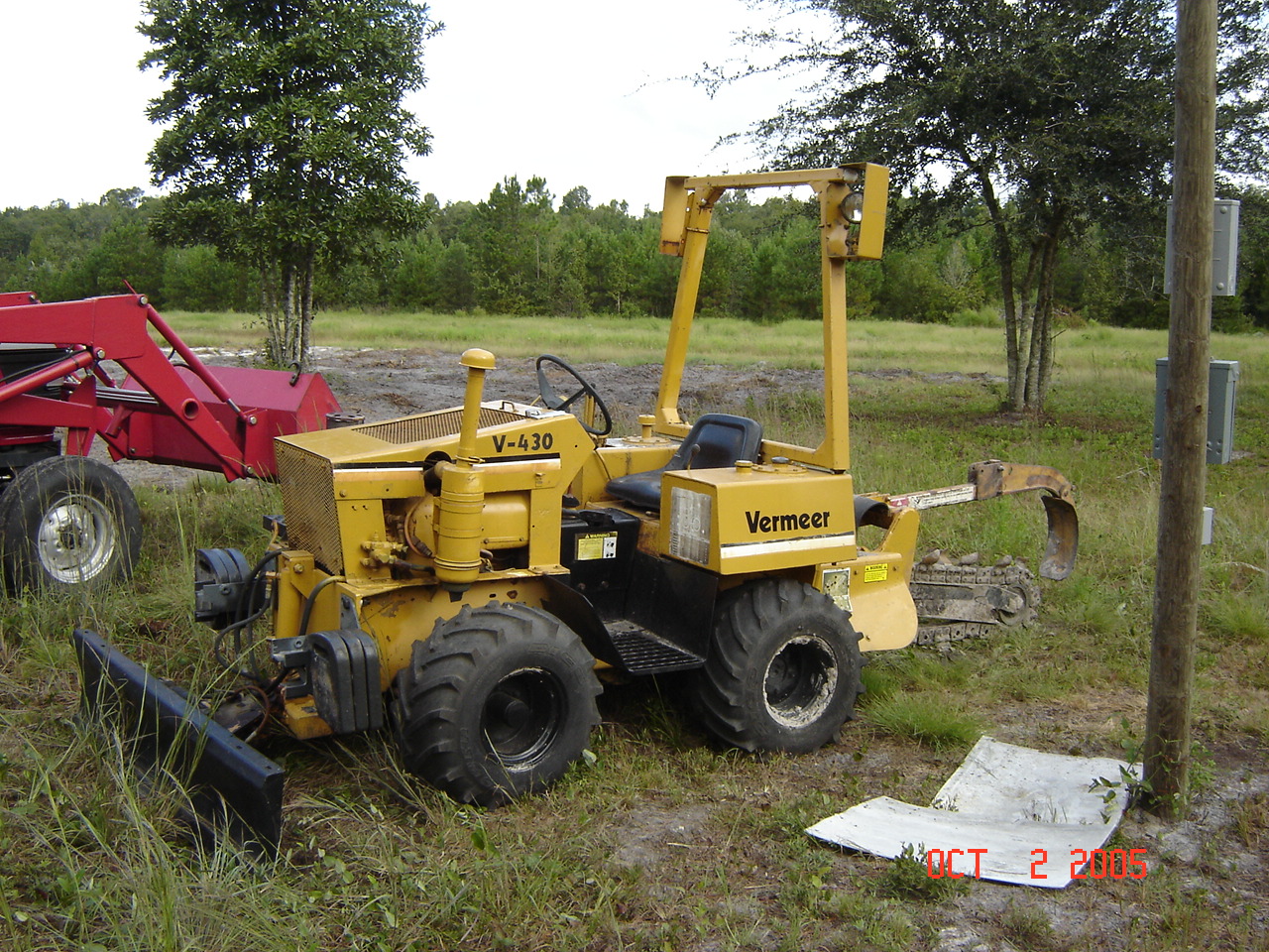

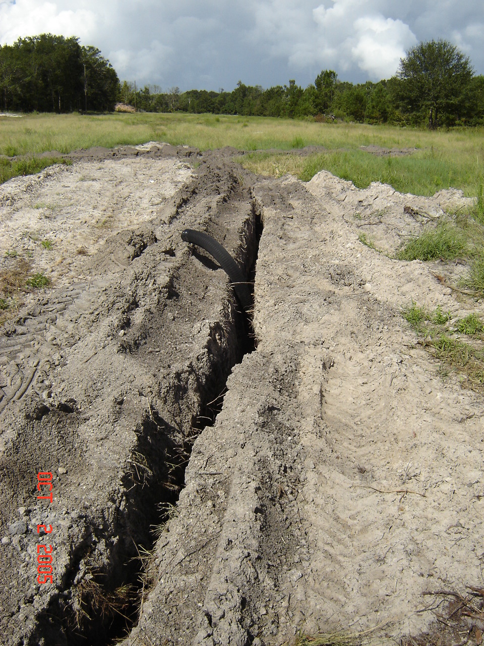

I don't know what part of the country you're in but I would definitely go underground so you don't have problems with wind/snow/ice bringing down overhead lines. I would rent a trencher (or in my case get my Vermeer out of the shed) and trench in either 3" or 4" plastic drain tile at 30" to 36" depth and then let the cable company snake their cable inside the drain tile. Down the road if you have cable issues or need to upgrade your cable, you won't need to tear up your field.

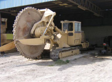

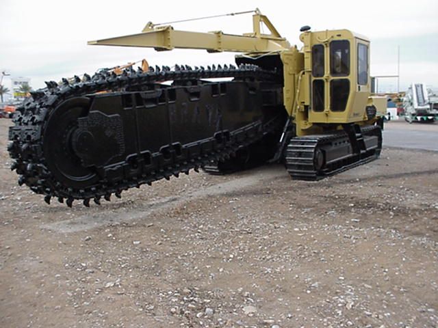

One of these units could do it. I would think just planting a few poles across the field would be easier. Dress the poles up as Christmas tree's or Scarecrows depending on the time of the year. 8' seems pretty excessive.
   / trenching 8 feet deep? #20
:cool:treemonkey I love that second pic, looks it would make a **** of a chainsaw. lol zman
