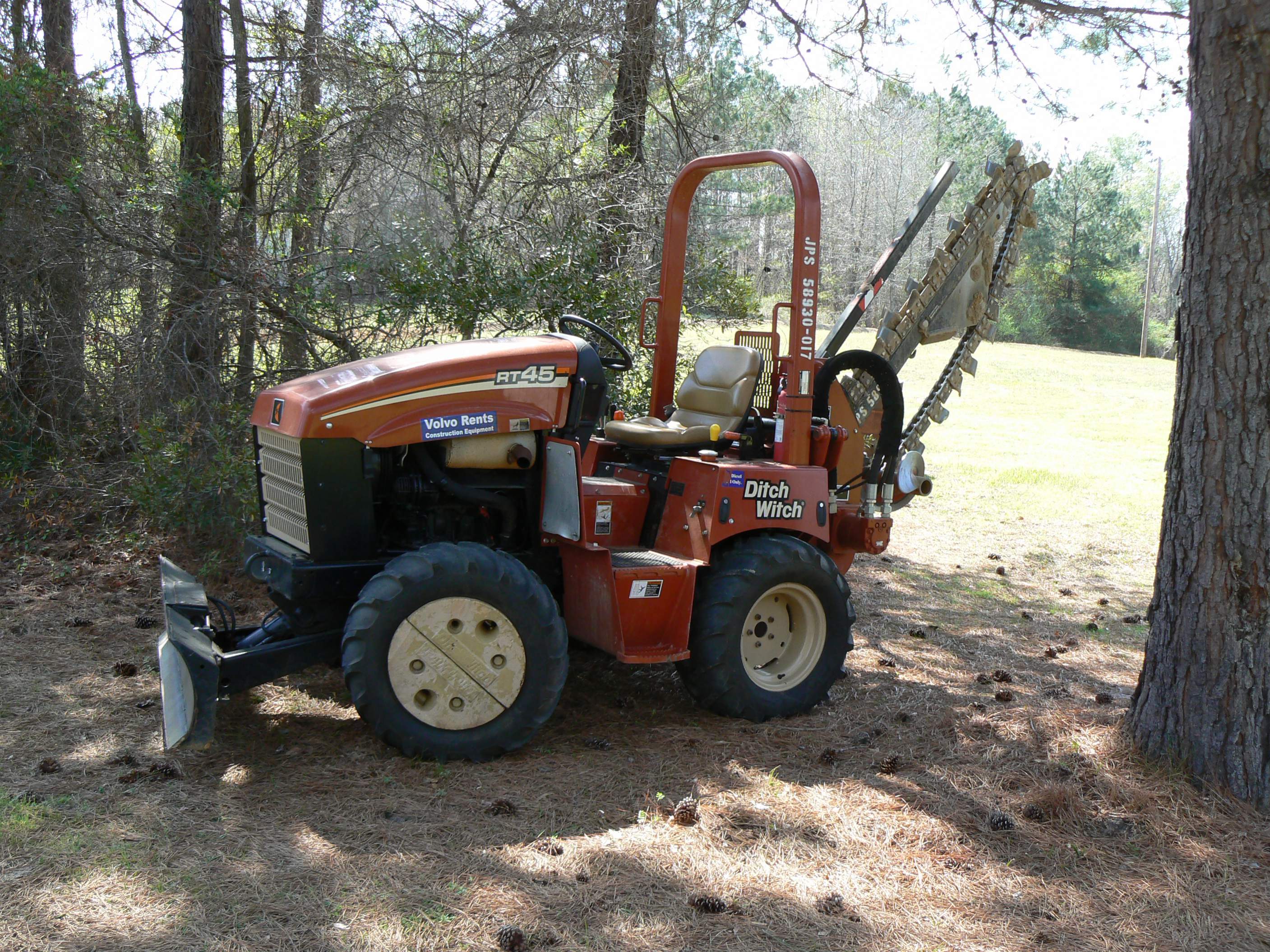

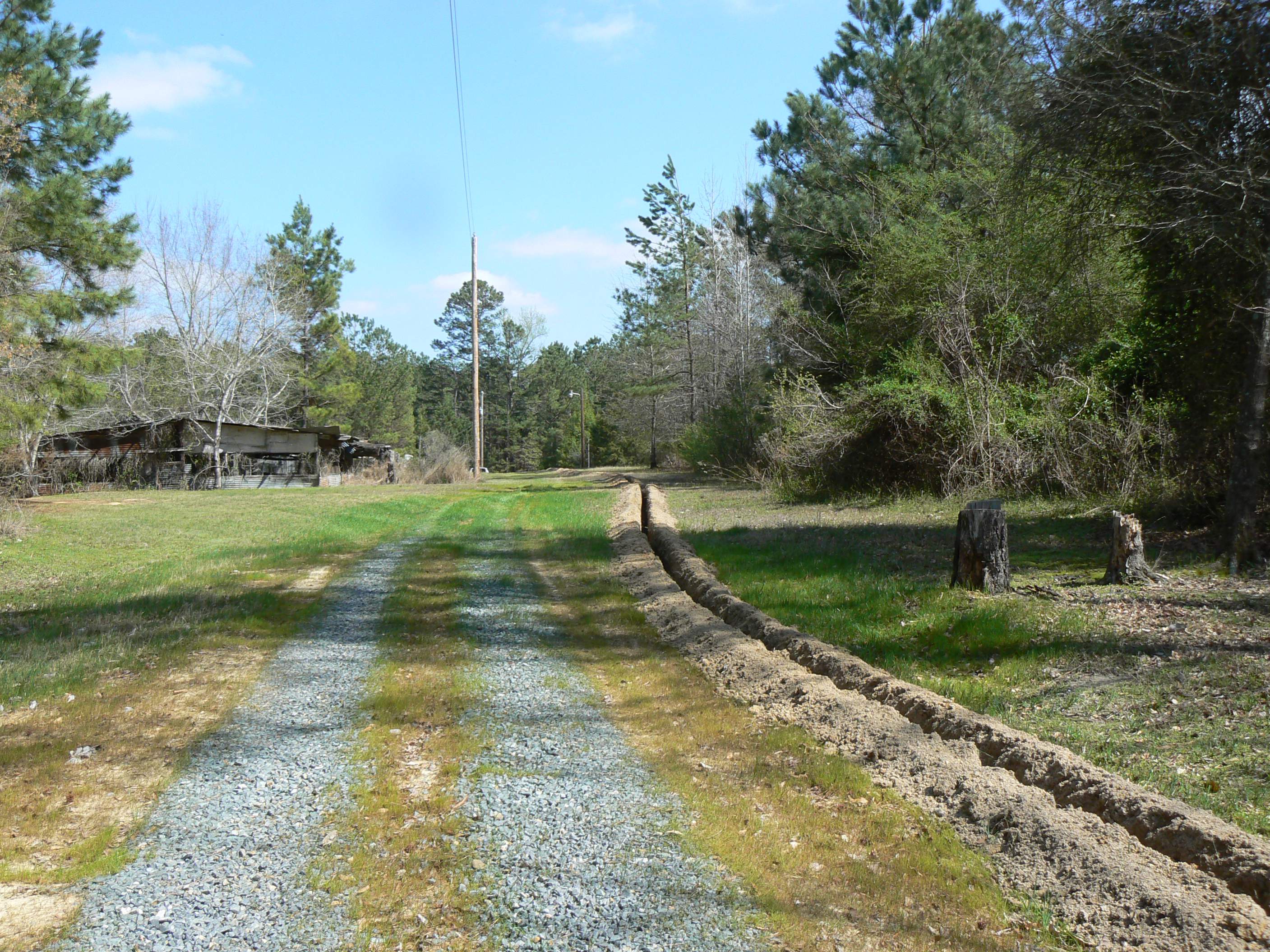

I believe you can do it yourself. I trenched 1,200' for a waterline in good soil conditions in less than two hours. Good Luck. P1000274.jpgP1000272.jpgP1000271.jpg

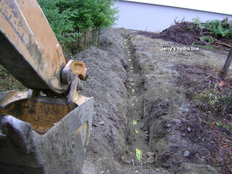

This was 600' very steep 4' deep sand included plus I had to move the pile in the bottom right hand corner bill was $600 I charge $100 per hr.
