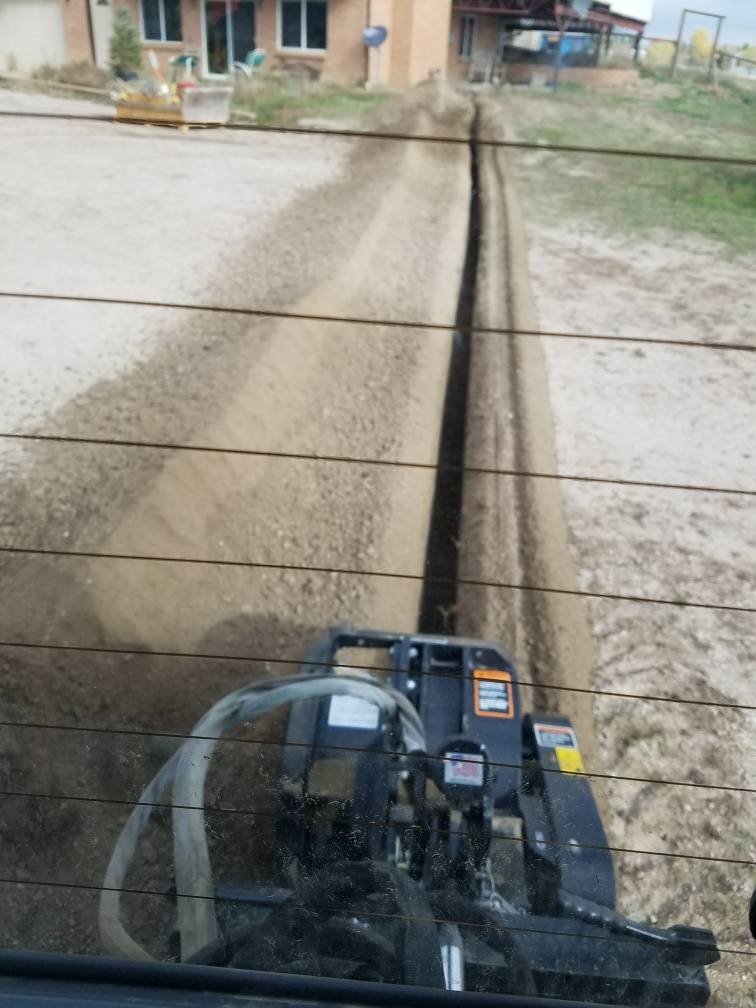

I rented a trencher and dug about 1300 feet of trench 3' deep for my water line. That was about as deep as it would go. That was hard clay and rock soil, and I did it in one day. Laid 2" pipe in it the next day and had "city" water before dinner.

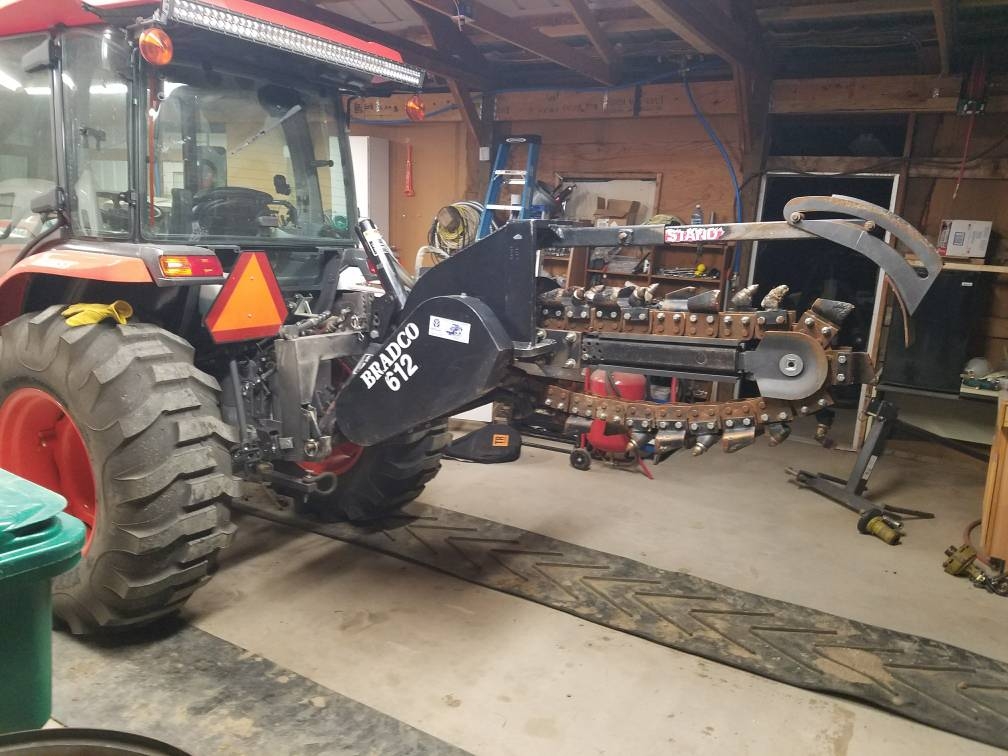

L4060hstc. 40hp & 6 speed Kubota HST+ tranny is barely slow enough. A geared machine wouldn't be slow enough & a normal HST may not be as well.
Bradco 612 trencher I got off Craigslist, some propane company stopped using it for installs. 3' by 6" blade. Due to angles it would dig a trench a little under 30" if I recall.
I've done a several hundred yards on a couple projects with it. Projects are done & I haven't used it in a few years so I need to take it to an auction or sell it. I also have an in with an ISP plowing fiber in all over the area if I need to do any more trenching. It got the job done ok. Not that much more problematic than any other trencher, but a 3pt on a tractor isn't as well setup as a real trencher. A fraction of the price though.

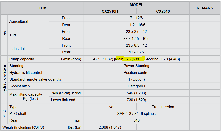

The Kioti CX2510 has a 11.3 GPM pump.
I'd think a tractor with hydrostatic drive would have sufficient GPM, but I'm no expert.

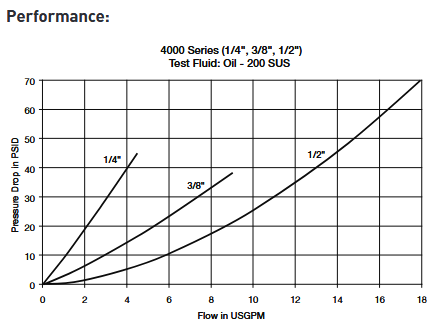

The tubing for the lines on a Kioti CX2510 is most likely 3/8" and therefor they cannot flow the full 11.3 GPM, Also the tractor might not have enough fluid to handle the continuous hydraulic load. If the 3rd function line uses 3/8" body fittings were the loader attaches to the tractor like many in that class do they are only good for 8 GPM.
Those 11.3 GPM is the flow of both pumps (steering + implement pump) which are different circuits and I don't know why they list it like that in the spec sheet.
The CX2510 has 6.5 CC pump for the steering and a 10 CC pump for the implement circuit (loader, remotes and 3 pt). At the rated 2600RPM, the 10 CC pump puts out about 6.8 GPM, even less than that if we account that most gear pumps are about 90% efficient.
   / Trenching with a Kioti #16
Yep, your right only 6.86 gpm. Had to look at the owners manual. Thanks for the correction!
This makes the decision easier for OP. The tractor cannot do it with a skidsteer trencher.
