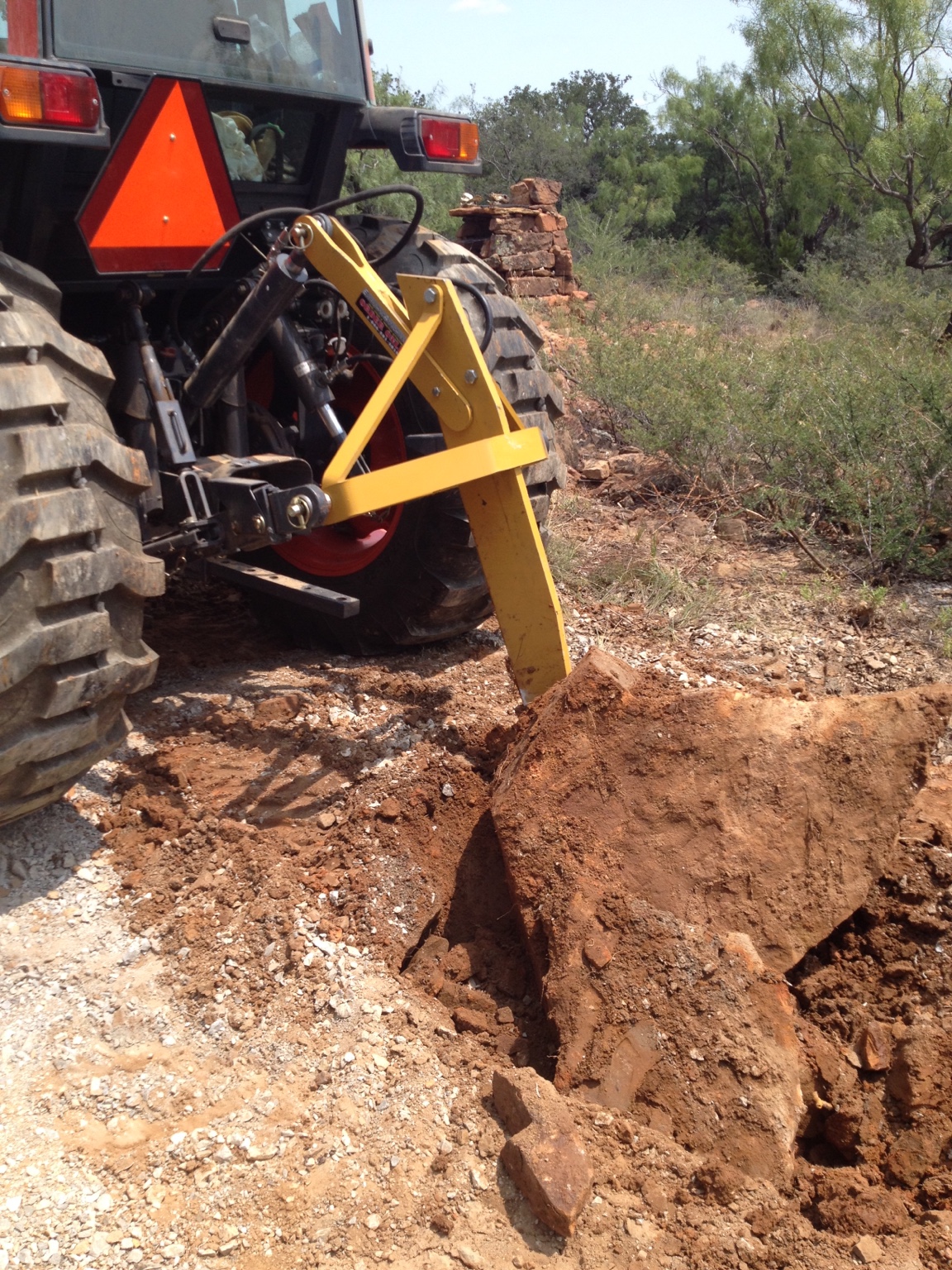

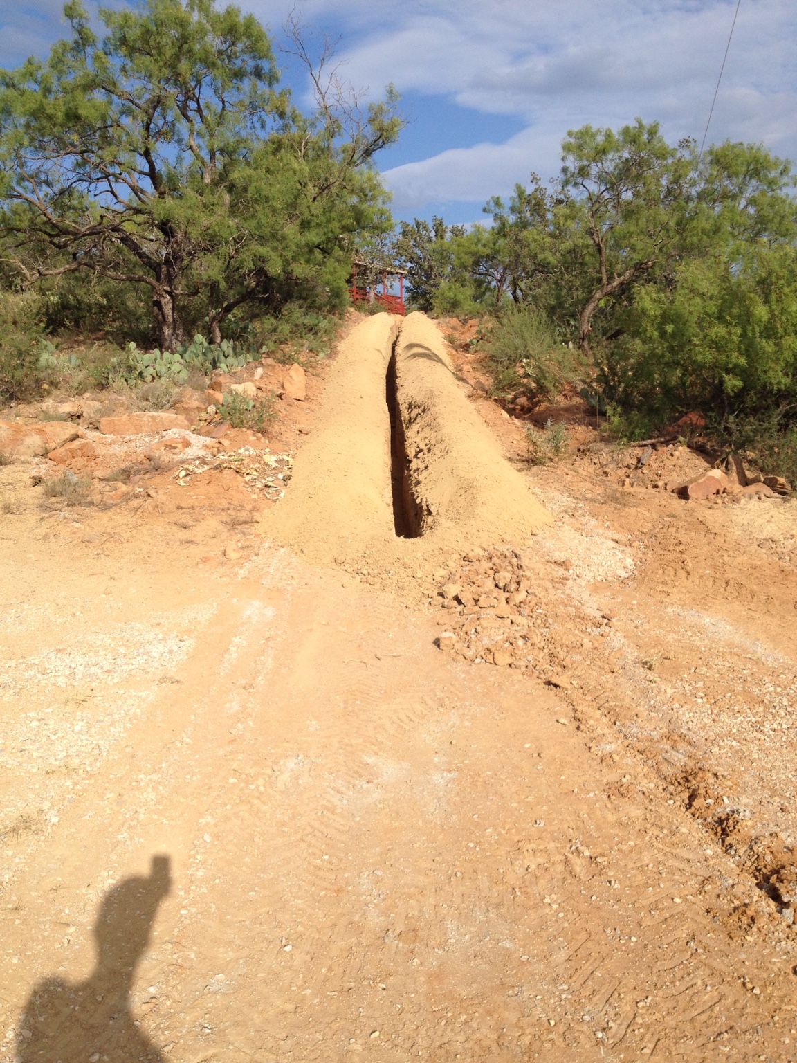

I trenched several hundred feet with a 45hp ride on trencher. Had rocks so I first cleared them with a subsoiler.
Had electrician do the electric then I did the water.
Was a lot easier to backfill with the trencher front blade but I had already turned it in by the time I finished it out so I used my box blade and pushed in by backing into at an angle.
