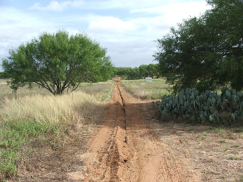

i did the trenching for the electrical service for my barn and well from the power company's pedestal to both termination points. i saved a thousand dollars off the quote and spent $680 on the trencher rental (i had to rent the trencher twice as it took much longer than i had anticipated). as has previously been mentioned this is hard, dirty work.
as far as cleaning out the bottom of the trench, i have a bad back which really doesn't appreciate doing things like shoveling while bent over. using a shovel to clean out a narrow trench just wasn't going to happen, so i plugged a big shop-vac into my generator and sucked the dirt out. it was kind of time consuming but it really did a good job. i don't have hardly any rocks on my place but did have a bunch of hard dirt clods which continually got stuck in the hose and had to be dealt with.
like i said: hard, dirty work. if i had known then what i know now i'd might well have paid the thousand bucks and smiled when i did it. i did save some money, i know exactly where the cable is, and i can say i did that myself.

The trencher I rented did a pretty good job in sandy clay. The screw blade piled the dirt on the sides. What did fall back in was easy to spade and made it easy to get a level bottom. As long as I could keep the dogs from playing in the dirt. But, I didn't have to go as deep as the OP requires. With electric, well and co-op water, I put in over a half a mile of trench.

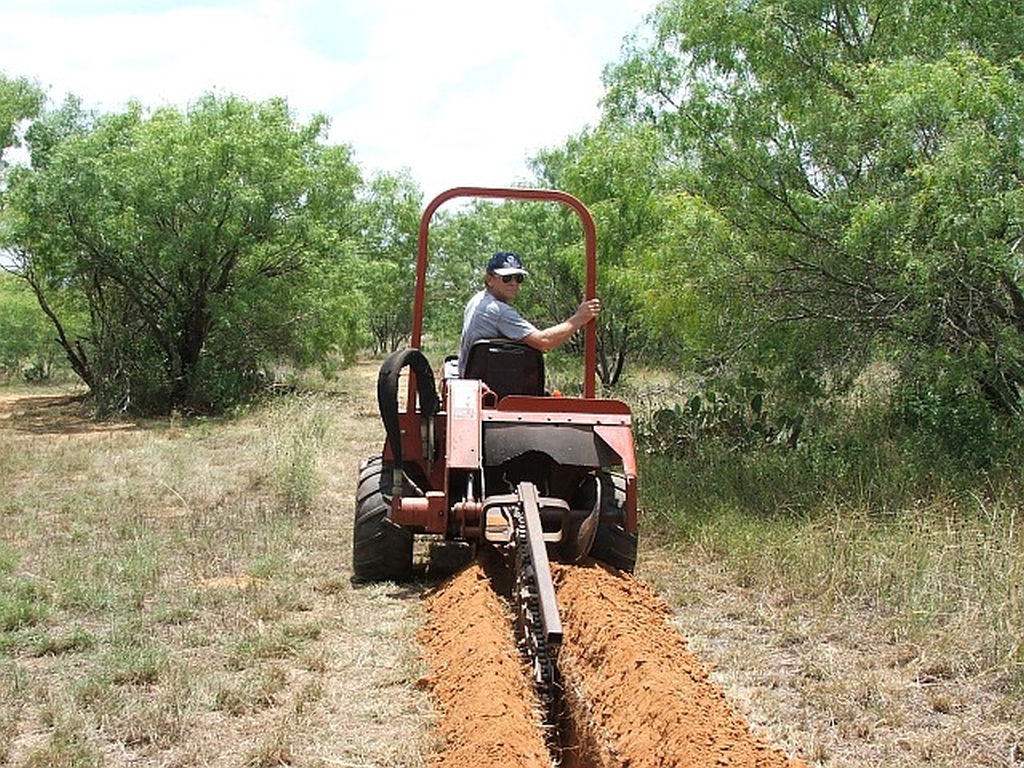

I've learned from years of doing underground electrical services that you need a trencher that will dig 12" deeper than the lowest depth you want. The chain will fill about that amount back in as you dig.
Yes, an inspector measures from the top of the pipe, not to bottom of the ditch. Lay a shovel handle across the ditch and measure from the bottom of the handle to the top of the pipe. That is the depth of bury.
No inspector is going to fail you because the code requires 36" and he measures 42". Deeper is better. Get that trencher that goes 12" deeper, like the man said, or you will be cursing yourself.
But please, do NOT try to do that much trenching with a walk-behind trencher! Get something in the 20 hp range at LEAST and make it a rider.
I did my electrical, cable, and telephone about a year ago. Only 70 feet or so, but three trenches. I rented a 14 hp DitchWitch walk-behind, and it about killed us. I gave up on getting the phone and cable as deep as I wanted them. It was just too much fight. A cantaloupe sized rock will STOP you. A 2" root will STOP you. Heavy clay (which is about all we have here) will make you cry. I had myself and two grown sons helping me, with each of them pulling on that stupid trencher with a cargo strap around their waists (and they are big boys!) and it was still slow going. A nightmare two days of VERY hard work, and I was not satisfied with the result for all of that.
