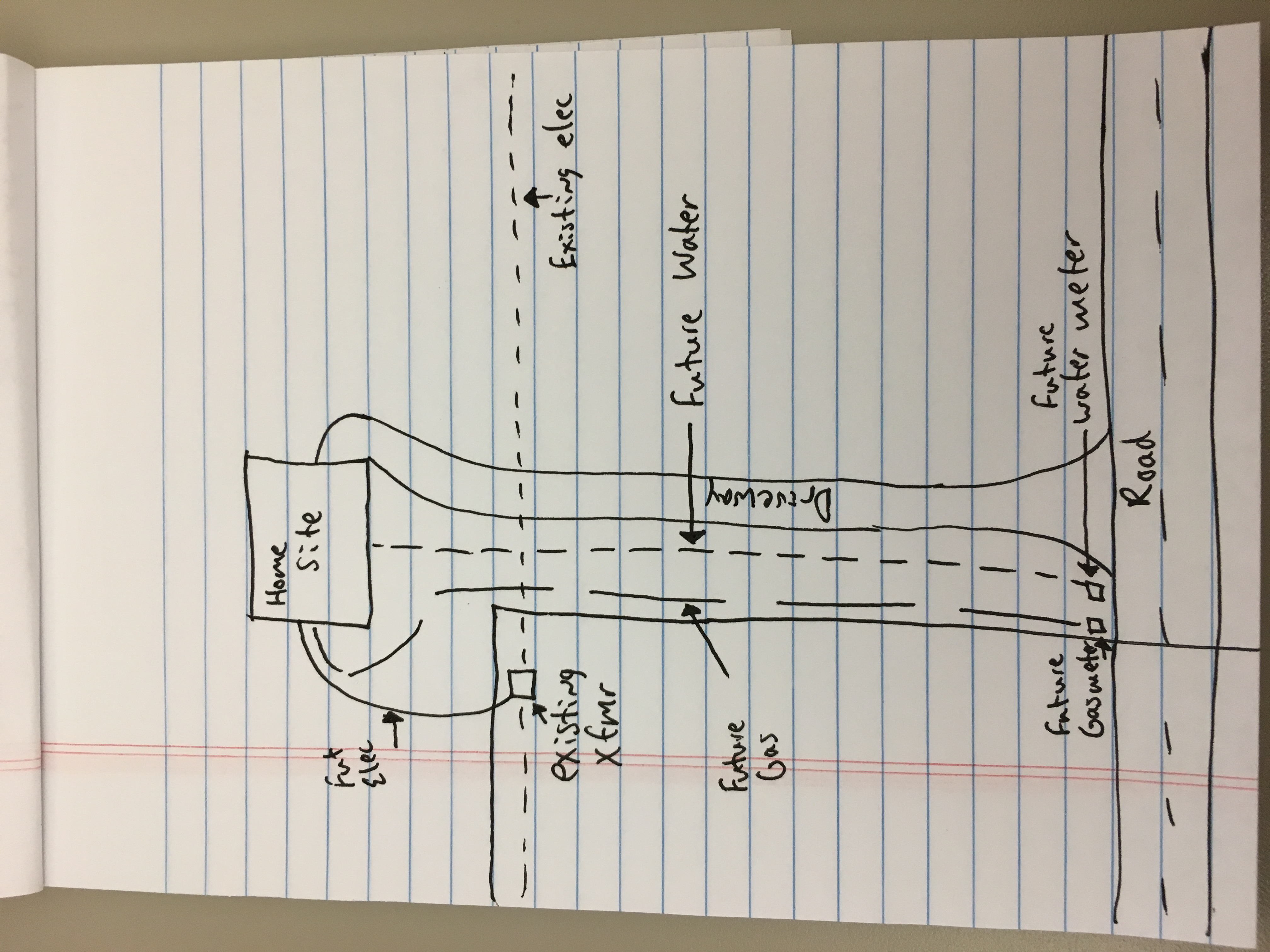

just to clarify the electric that will be crossed is already existing (buried 36" according to power company. I attached a picture (sorry it's quite busy with lines) of the situation.

Nic, from your diagram, I would begin by locating the existing electric line by hand digging to it.
In this area Kansas City Power and Light requires 30" of bury in a 2" conduit unless you have a 400amp service, then it's a 3" conduit. Just to give you an idea of what depth you might expect to find elec. But check the depth of bury your elec. company requires.
After having the elec. line visible start trenching there, and go towards the road. When you get half way to the road (or an open spot of you have growth) stop. Go to the water meter connection and head towards the trench you just finished. Dig directly over and past the trench going towards the road just so you have less hand work. Pull the boom out of the ditch, back up a tad, then cross over the ditch with the machine. Now take a sharp shooter, or better yet a trencher shovel, and clean out the crumbs of the overlap.
If you have good soil without rocks, dig the trench a few inches deeper then you need. Then just leave the crumbs in the ditch. It allows a good bed for the PVC line.
Do the same for the second line.
Once you have the line glued and in the trench be sure the line lays on the bottom with no "bubbles" sticking up. If necessary push the line down with a shovel, or 2x4, and kick some dirt on the line while it's being pushed down. Do this every 15-20 ft. or so.
All this information is based on using a ride on trencher. It will make the job so much easier!! Backfilling is a piece of cake.

IF you are crossing an existing line.....hand dig anything within 2 feet. DONT trust what they tell you depth wise. Things on the surface can change, or the contractors doing the job might not have done it to spec.
Let it be located. Hand dig within 2'. If you hit it outside of that boundary.....its their problem. IF you hit it within, you will get a hefty repair bill
