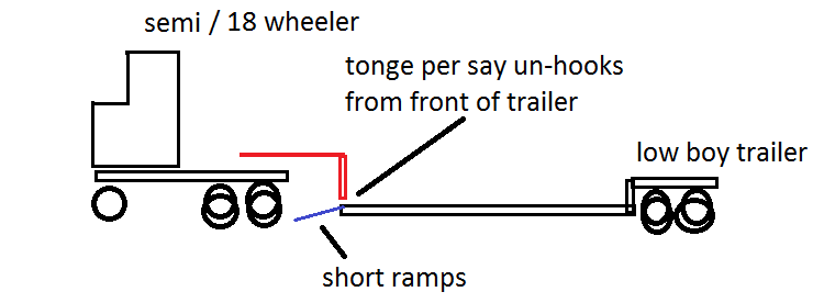

the company that delivered the ford 555c TLB TractorData.com Ford 555 backhoe-loader tractor information weighs near 14K same as your ford 9700 and mini ex you looking to haul. used something like below diagram. little extra work to load / unload. but offered a very low load up point and kept everything low while on the road. to gain those few extra inches of height for what ever you are hauling (to get under bridges) i would imagine costs a bit more... but if you are hauling equipment for say landscape business or perhaps lake /pond building business... it might give you a few more options.
once you get equipment to site, it is not like you will be driving trailer all over rough ground while equipment is on the trailer? more likely once you get to site you will be unloading on flat level ground. and then driving the various equipment all over the place on un-even ground.... assuming even if it means unloading equipment on the road itself. using some road cones / markers. to unload stuff. due to site does not offer a good place to unload equipment.

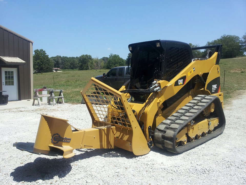

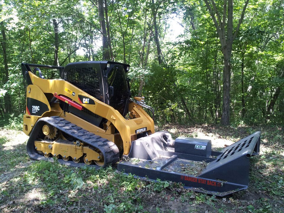

I'm dead set on a 16+6 possibly 8 tilt. I need length to get the saws, brush cutters, grapples, fuel tanks etc. cat1.jpgcat2.jpg
