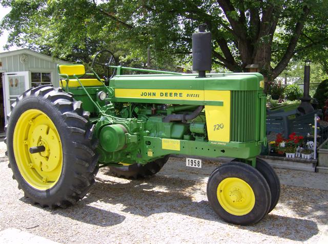

Just wonder how many people who criticize the narrow fronts have ever actually ever used them?
I grew up on this one, along with several others:
