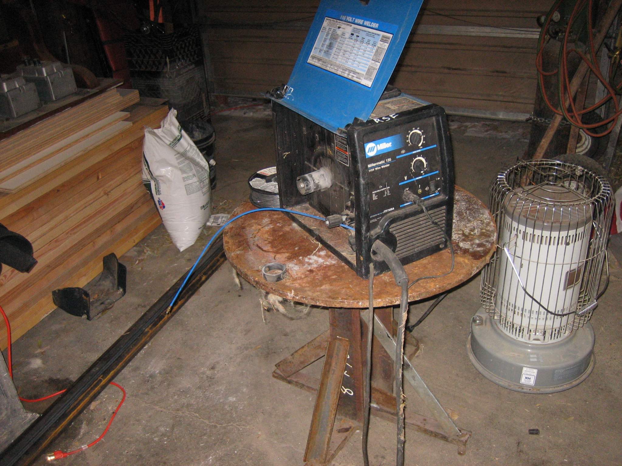

Here is the welder sitting on the welding table. I think that welding table is going to be awesome for my uses. You can see I don't have much room.

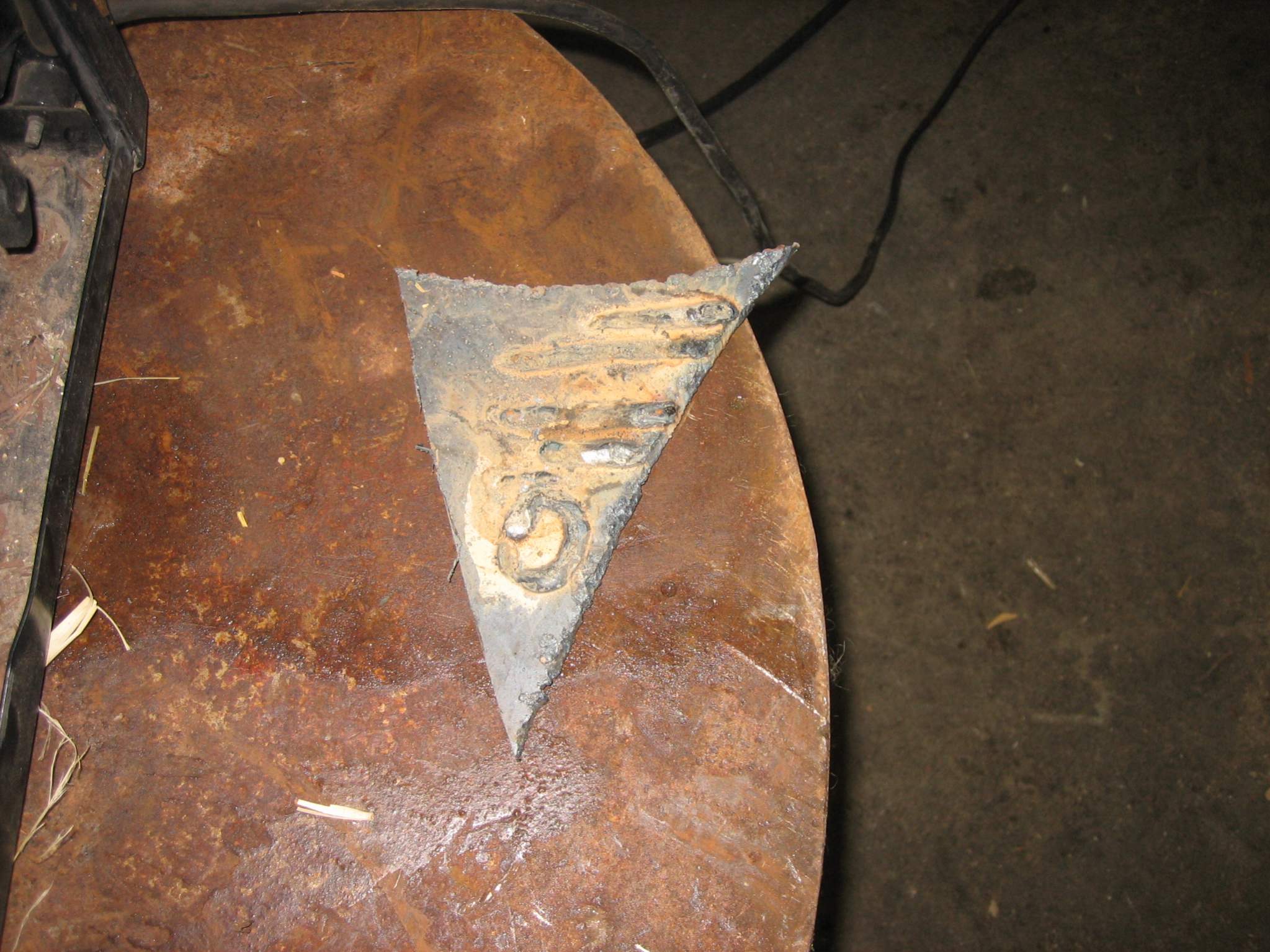

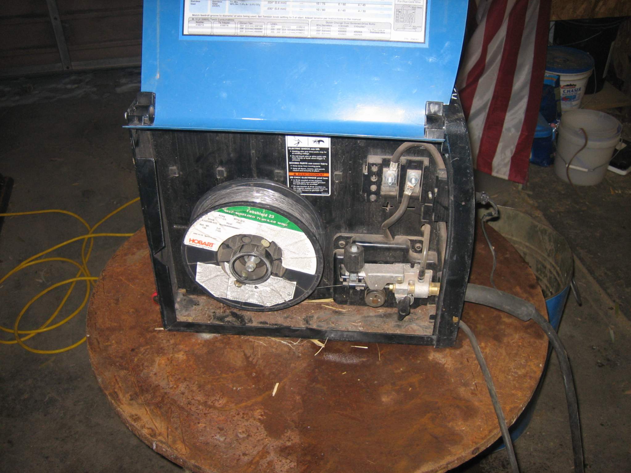

When I got into the welder it was a bit of a mess. In the end I got it put back together and welded a few beads on a piece of scrap. I think the feed is going to be a little poor until I get a new spool of wire in there, but it welds good. It's a Millermatic 135.

Nice welder bud, I bought my dad same one for christmas few yrs back. Put in a spool of clean wire, new tip, new cup and you should be good to go. If wire feed problem still exists look into a new liner, and go over the drive roller tension and just make sure its not slippin from a tight spool of wire. Good luck!!!

I had a Miller 135 a few years ago, very nice 110 MIG welder. I sold it when I got my 180, I wish now I'd kept it.
Try setting the wire feed tension around 3 or 4 (if my memory is correct) and clean the grooves in the feed rollers. The 135 has a reversible feed roller, one side is for .023 wire, the other side is for .030-.035.
You should have the spool tension just tight enough that the roller has to pull the wire off and the spool won't turn by itself.
