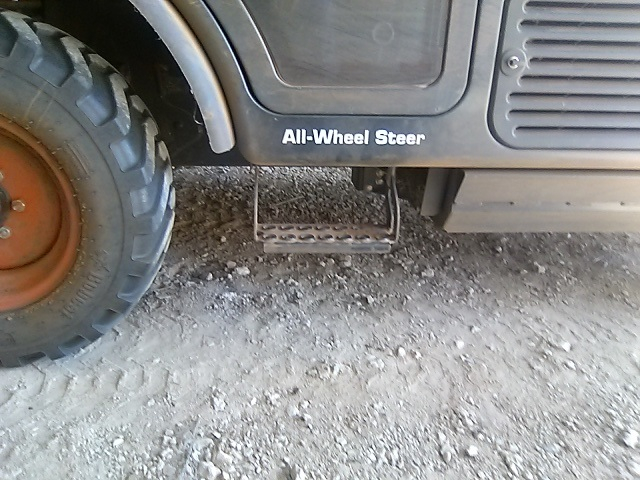

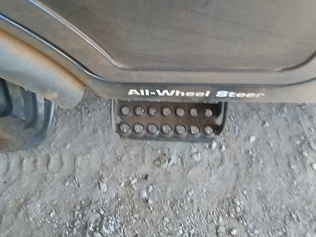

When I ordered my 5600 I ordered it with the 'Step Kit' (7135575) and when it showed up it had only one step on the driver's side. I guess $216 doesn't buy 2 small steps anymore. That's not what I was expecting. :(
DEWFPO
/ trivial question about the step kit #2
I also ordered the step kit and assumed it would have 2 steps for that price. However, I find the step extremely helpful in getting in and out of the cab. I wish the step would sit out a litte farther from the cab. I have mine set all the way out but wish it could extend a few more inches.
I agree, the step makes it much easier for me with my bad back and my 5'3" wife to get into it so when she hops in on the passenger's side she always reminds me it doesn't have a step. I also agree I'd like it to stick out just a couple more inches and it would be perfect (for getting out as well).

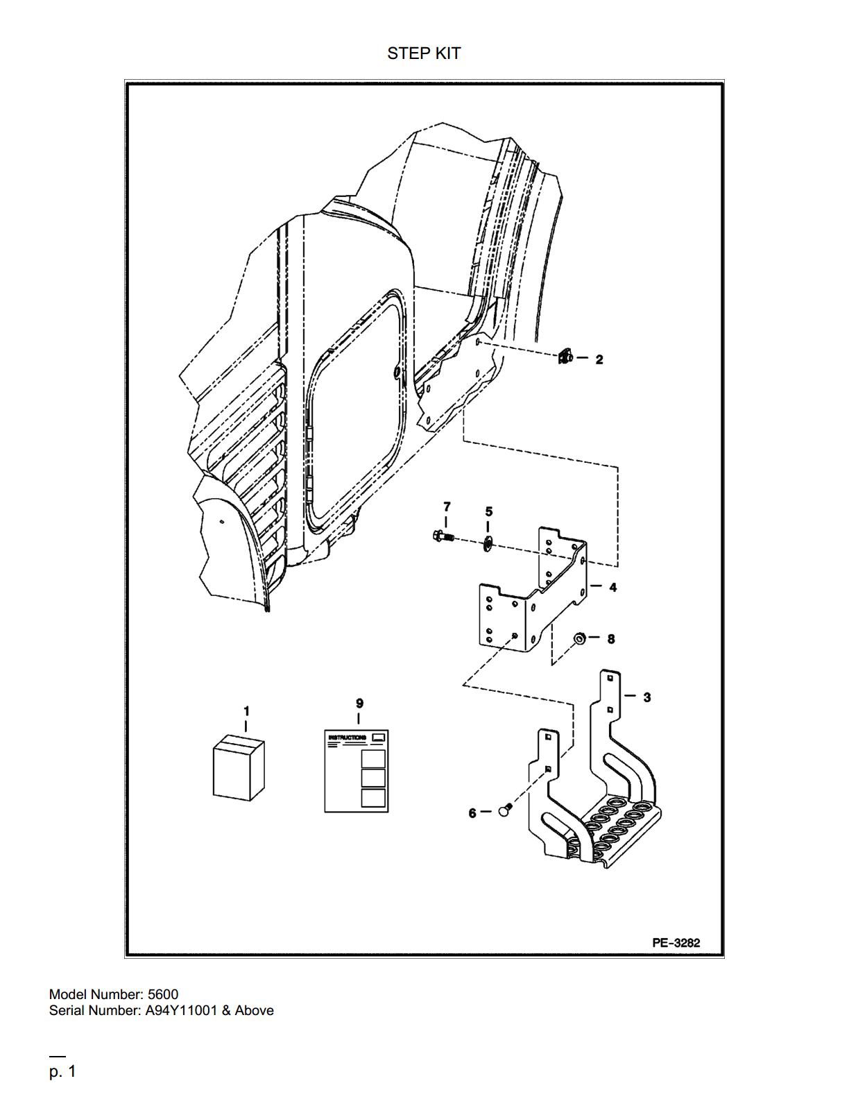

toolcat step kitjpg_Page1.jpgI know this is an old thread but I ordered a step kit (7135575) for my 2012 Bobcat Tool Cat 5600 (F-Series). I don't have a support member behind the rocker panel nor holes and the directions are just a simple assembly diagram.. do you have to drill through rocker panel to mount the step or is this kit not fit an F-series? Dealership said it would fit my machine but I certainly didn't envision drilling through the rocker panel and having those goofy sheet metal sliding nuts siting on the outside of it..

I just put these on my 15' Toolcat and the holes are drilled from the inside of the rockers. The instructions are not totally correct ( Typical for Bobcat) as my vintage machine does not have the body brackets shown in the instructions.
I made op a template and taped it to the rockers, it was a lot easier than marking the holes with a ruler.
/ trivial question about the step kit #10
But since you don't drill through to the outside, how do you get the nuts on?
It looks like the drawing is of the right side, so I guess it will fit on either side.

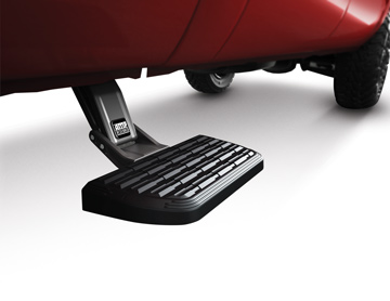

I have thought about putting one of these on the 5610, the BedStep2, as it should retract if something hits it: BEDSTEP2 | AMP Research
I have their BedStep on my truck bumper and it is awesome.

Here are the installation instructions for the step. This should have been in the box with the parts or dealer could have printed theses out for you. The holes are drilled through inner wall of cab only then clip nuts slipped over the holes for the bracket.
  • Toolcat step.pdf
/ trivial question about the step kit #12
thanks both came through for me.. Dealer e-mailed me and of course you guys always come through!! a bit of a pain to do as they don't give you measurements for the smaller 1/2" holes (outside ones) so I transfer punched them using the mount then made a template to overlay to do the larger center holes then took a carbide bit and squared off the holes so they fit nice.. thanks as always!!
