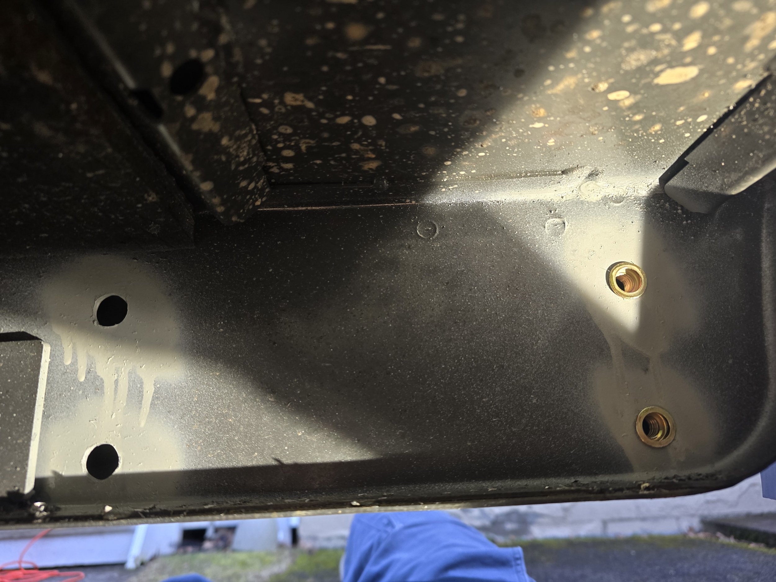

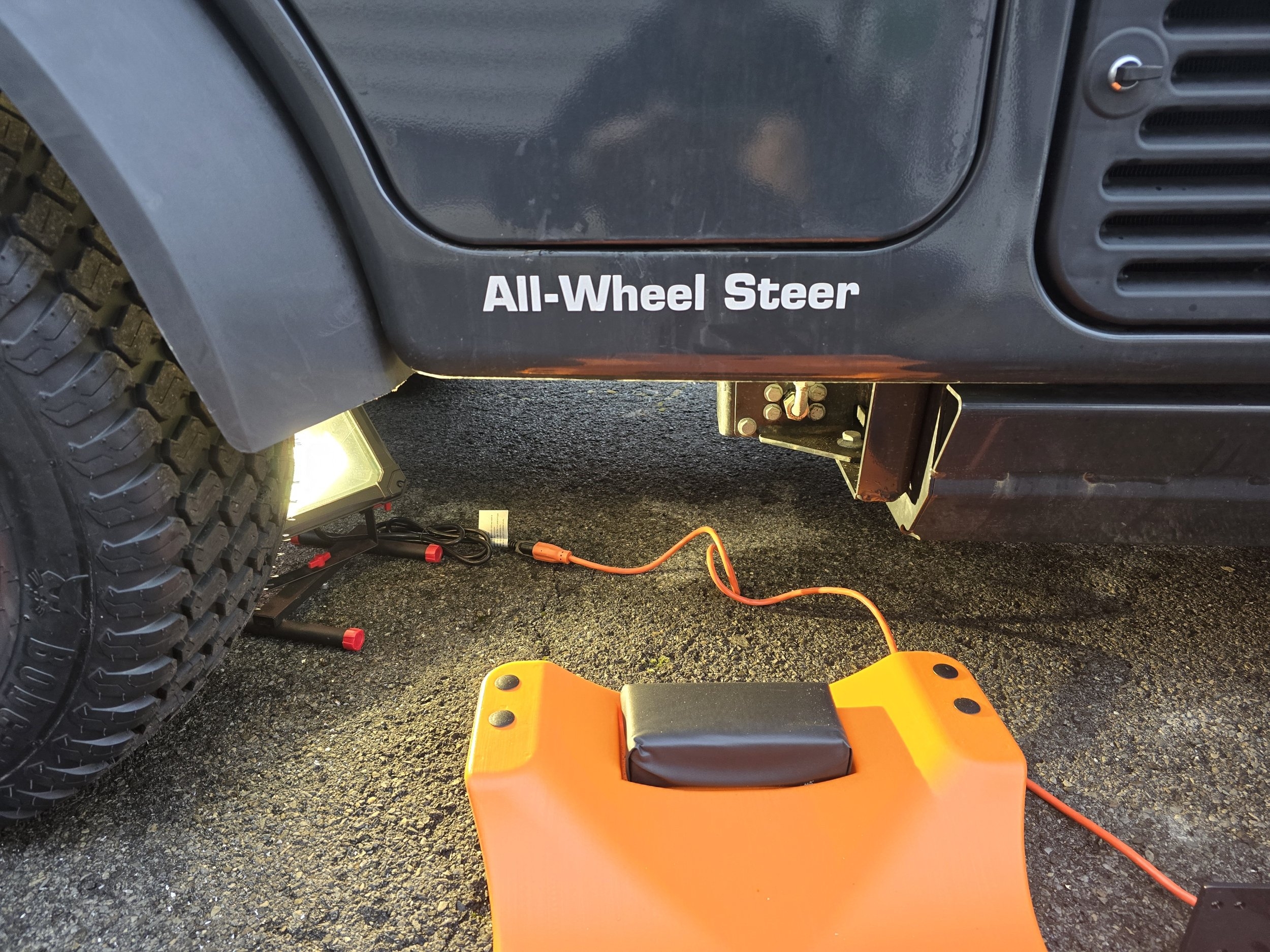

So today was the day to install the Steps on both sides of the machine
The passenger side was a much more difficult task with all the hydraulics in the way
I ended up just ordering 2 of the brackets and 2 steps
Instead of giving Bobcat $80 for hardware I did not want, I ended up getting it for 6$ at Tractor Supply
I used 3/8 Rivnuts instead of the Bobcat clips for mounting the brackets, and 5/16 for the steps to the brackets. All Grade 8
There wasn't enough clearance to use my Rivnut tool on 4 of the 8 rivnuts, so had to default to the old school bolt, nut and washers to get them secured which was a royal pain and time consumer
Happy with how it all came out and much much easier to get in and out of the machine now

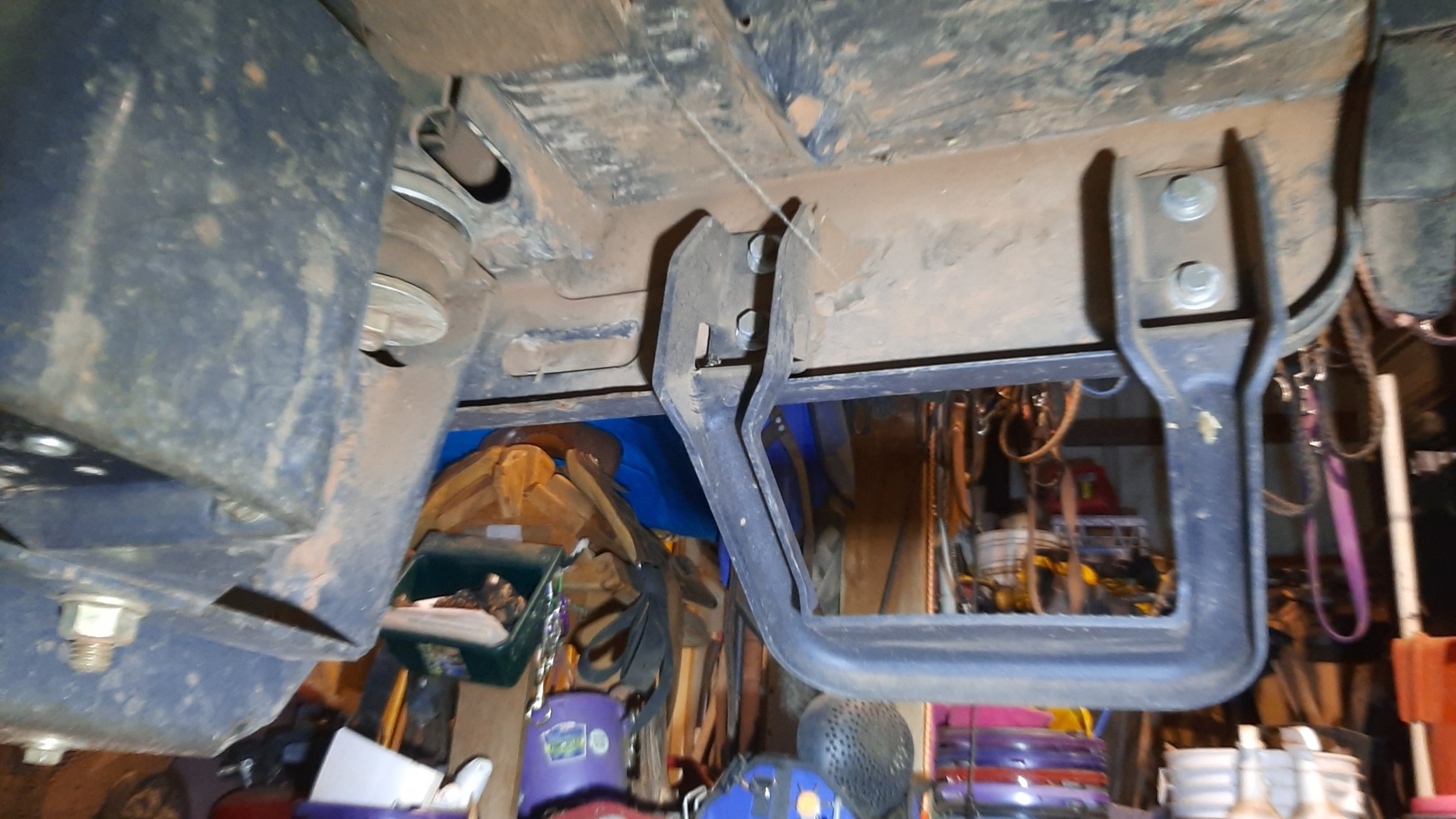

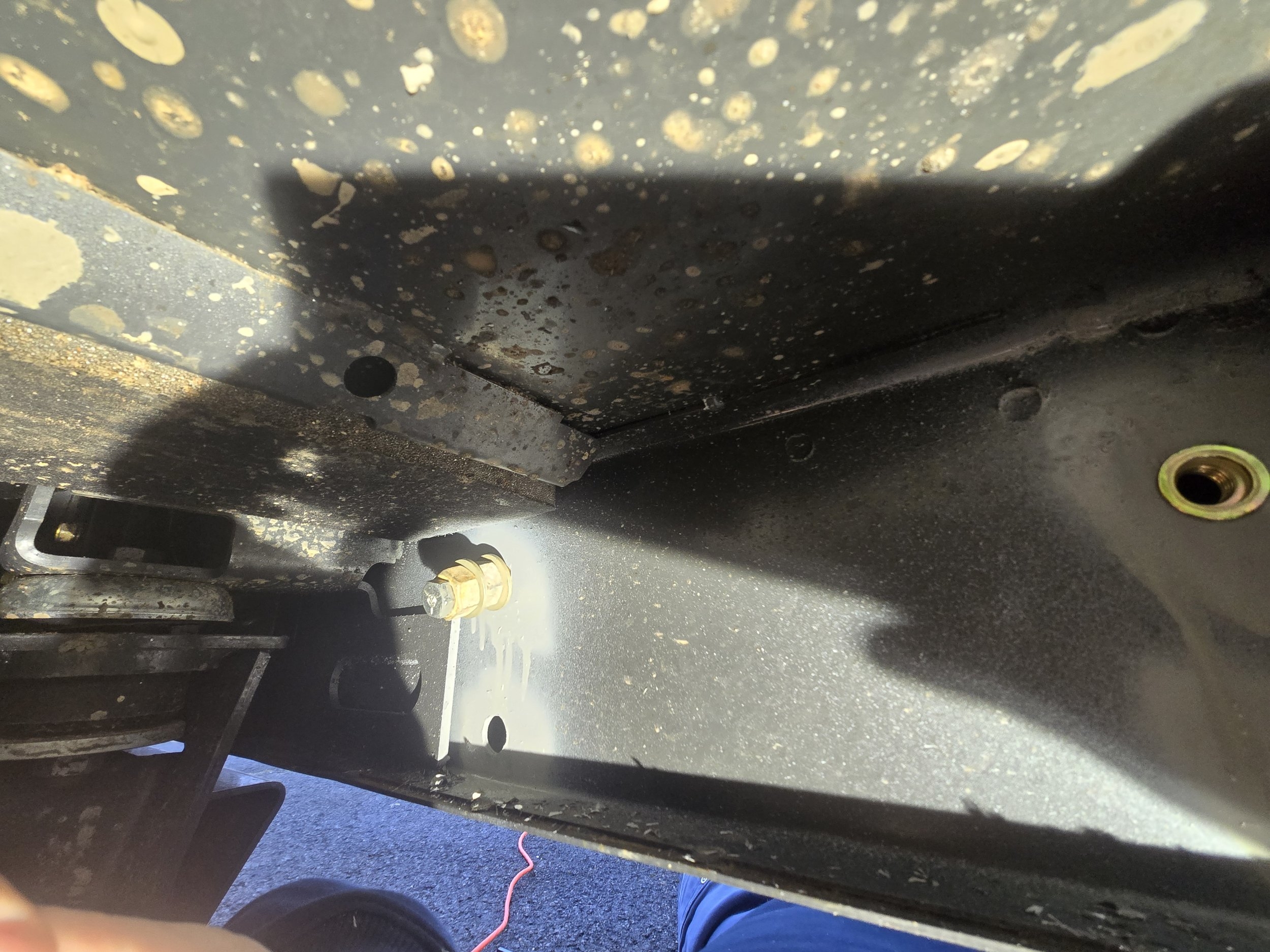

they look neat could you put a couple pictures of the underside mounting, thanks
   / ToolCat Step Kit #7
Sure, not much to show though.
I set it as far down and forward as it would go and it just fit. I didn't use any of the mounting hardware that came with them, just the speed nuts.
   / ToolCat Step Kit #8
that sure looks like it was made for the machine, will order up a couple next week
