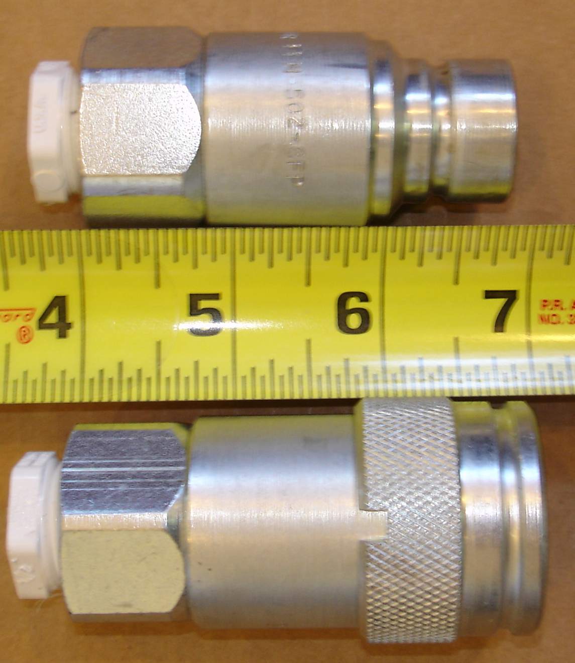

Here is a picture of the fittings I use. It is slightly blurry because I used a macro setting on the lens and got in really close to the fittings. The top of the hex flats is in focus, all the rest is slightly out.
You can see the plastic pipe plugs I used to close the back of the fittings. I did not say seal, because I don't want them to seal. There should be a very slight pressure leak here to relieve any pressure build up from thermal expansion. The only purpose of the plastic pipe plug is to keep dust, dirt and water out. I did not use thread sealant on the pipe plugs.
My tractor is set up with nominal 1/2" fittings, one male and one female.
Both the male and female internally seal when they are disconnected.
Thermal expansion is only a problem if the oil changes temperature between when you disconnect the implement from the tractor and when you try to connect the dummy fitting, which is why you should do it right away.
I normally carry the caulking gun I showed in the other thread on the tractor, and if there is any difficulty making up the connection with the dummy fitting, it is very easy to overcome with the caulking gun.

I don't think a hydraulic hose between these fittings would be of any help. It would make a closed circuit and it would still be easy to build up pressure in the sun. What you really want is either a very slight leak, to prevent pressure from building up, or a tee and an extra valve as you advocated before.
