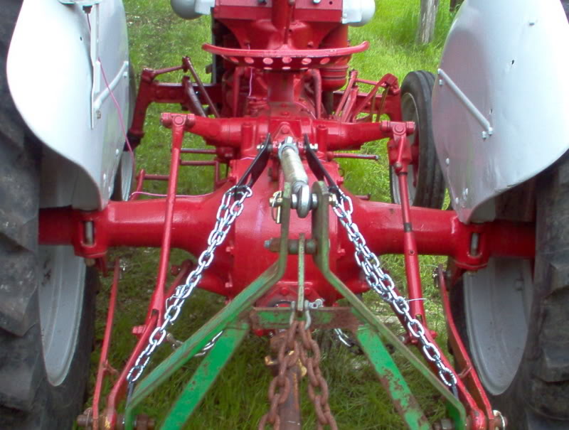

I have a 1951 Harry Ferguson TO-20 tractor, with a 5' rotary cutter (brush hog), and other attachements. I have had a very hard time getting my 3 point hitch lift to get to, and stay at, the right height. It is either too low, or it goes all the way to the top, and then, all the way to the bottom. The thumb screw to adjust minimum height doesn't help. I can't just raise the height slightly, or lower it slightly.
I've been told this is a common problem with this design. I've heard you can hook chains to the front of the brush hog to keep it from getting too low, but I've had trouble getting that to work consistently. I've also heard of an after market attachment to help this tractor better manage the height adjustment.
I recently had repairs and maintenance done by a dealer, but they said this wasn't an easy fix, and was always a problem on this model of tractor.
Any advice?

You need a set of Check chains - here's one link, I'm sure you can find them at other places
www.1tractorparts.com/ford tractor parts
Much cheaper than fixing the tractor and easy to use. After you get your chains lengths set, the implement can't drop any lower

I had to improvise installation of check/limit chains from my small Kubota B3300SU to my Rotary Cutter. As these chains were originally designed for the Ford 8N, 9N, etc. I think you will find they go right on your Fergie. Check/limit chains work fab supporting the front of your Bush Hog at the height you want. Zerco has been supplying these check chains since about 1960.
LINK WITH PHOTOS: http://www.tractorbynet.com/forums/...ta-b3300su-zerco-check-chains.html?highlight=

Sounds like you're trying to improvise a chain support system. It can be done, but it's much cheaper and simpler to just buy a check chain set.
If the check chain is coming loose, then you're not using a right check chain setup or you're doing it wrong.
You have brackets that sit on the top link pin on the tractor side, with hole/slots to hold the chain, your other two brackets slide on the lower hitch pins of your bush hog. You adjust by raising the bush hog and sliding the chains through the holes and drop them down into the slots until the bush hog goes down to the height you want and is hanging on the chains.
With the slots being up by the top link, you can raise the bush hog and when you want to lower it, just shove the lever all the way down, it won't go down further than the chains will let it and they don't come loose.
My hydraulic system works perfectly well, but I still use check chains just so I don't have to worry if I'm lowering it back down the right height. I pick it up, make a turn, drop the lever all the way down and make another pass.

You need to splurge $30 for the check chain set. Look at the diagrams in the LINK in Post #5, it will show you the connection points. Zerco and Zerco type setups have been tried and proved for 55 years.
You are correct that check chains will do nothing for your Three Point Hitch lifting all the way up.
I suggest you begin another thread focused on this problem exclusively, in the Ford/New Holland forum. Fergie people read the Ford forum too.
