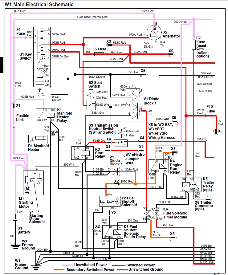

With just the little information so far, I would guess a strong chance of alternator problems. If you can somehow get it started again, can you measure the battery voltage while running to see if it is getting charged. To expand on beenthere's questions, can you do electrical troubleshooting? I attached just a portion of the schematic to show the battery and alternator connections.

sorry no tech. manual. I am doing the work via in person not over the phone. I consider myself a hobbyist mechanic. my father on the other hand is fantastic at woodworking but not mechaical things so i offered to help. not an expert but can usually work through a problem with the right tools and help. I can generally work through electrical schematics. I'll try to get it started today after work and see if its charging properly . Do you know what the correct charging v's/amps should be. also this model is ehydro. to me it just seems very odd that it wouldn't take a jump when this first came about and thats when we replaced the battery.

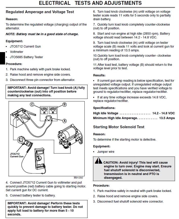

At 2850 rpm (high idle) the voltage should be between 14.2 and 14.8 volts. If a battery has failed internally and a cell is shorted it can prevent even a jump start from working.

Typically with use it is vibration and shock over time. An individual cell will collapse and short. Similar results can occur if a battery is allowed to fully discharge, or is overcharged. Alternators/voltage regulators can be the source of those problems. You should also pop the cell covers to see if each one has sufficient acid.
