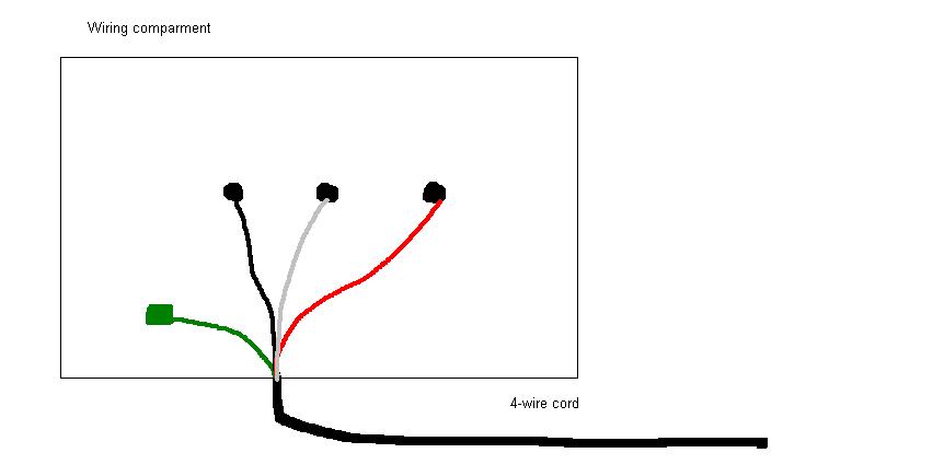

the use of the ground rod...... I realized after posting that the information is old, but I find it interesting that there has been no updates to this information. what is the correct use and placement of the ground rods.... could you please post a line drawing like the other one, showing how a drier is wired using 4 wires...... thanks for your information and help......
   / Trouble with Compressor blowing Breaker #59
The ground rod is NEVER to be used as the grounding means for any appliance.
The attached diagram is how a 4-wire cord is to be hooked up. Soemtimes there is a ground strap connected to the center terminal and goes to the dryer cabinet. That has to be removed to use the 4-wire cord.
Green goes to the cabinet
Black to one of the outside posts/terminals
Red to the other outside post/terminal
White(neutral) to the center one

My youngest daughter just bought a new dryer; been using an old one that was given to her by a neighbor. That neighbor had been using a 3 wire plug and changed to put the 4 wire plug on it when he installed it for her. When I pulled it out to install the new dryer, I found that the old one had that ground strap, and instead of removing it, he had just hooked both the white and green wires to that center terminal. /forums/images/graemlins/laugh.gif
