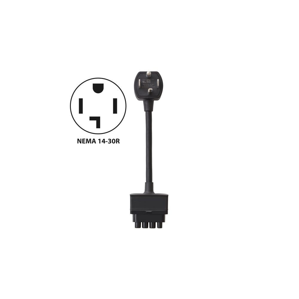

Ponytug, I found that dongle diagram and it's the prior model of charger. The 2025 Equinox OEM dongle goes into an approximately square socket on the charger brick.
Scooter, at $350 to $500 included in her new car price for this charger brick, I'll try to make it work. I've read it pulls 32 amps natively, which I think is too much for this old farm wiring.
The updated Equinox charger brick we have, has a 14-50 dongle so I bought the adapter to get from that to my 10-50 'dryer' outlet. This works great but I still want to reduce the amperage going through it.
Sorry I pulled the wrong part, but you want a 14-30 dongle for reduced current. The ones above look like they just adapts
the plug to your socket, but I do not believe it tells the brick to reduce the charge rate. True?

FWIW: The GM "cord dongle / shortie cord/adapter " contains electronic smarts that tell the car to limit the charging via an electronic handshake at power up what the outlet is capable of- it is part of the car charging standards. The yellow ones just adapt prongs, and do not have anything to tell the car that the outlet is less powerful.
All the best,
Peter
   / EV Charging - how to adjust charging amperage? #20
This would suggest that the 30A circuit requires the GM 30A dongle (shortie cord) for the brick to turn down the charge current;
E.g. this shorty cord for her brick;
And of course a new NEMA 14-30 outlet...
All the best,
Peter
That is for the "old" style Chevy brick. The new ones do not have that configuration. (Closed the page before I was done, fat fingers.)
You have found the correct information the "latest" Chevy charger does allow two currant choices when plugged into a 120 volt circuit using the my Chevy app. However it does not on the 240 volt operation, in that configuration it can and will pull a max of 32 amps.
