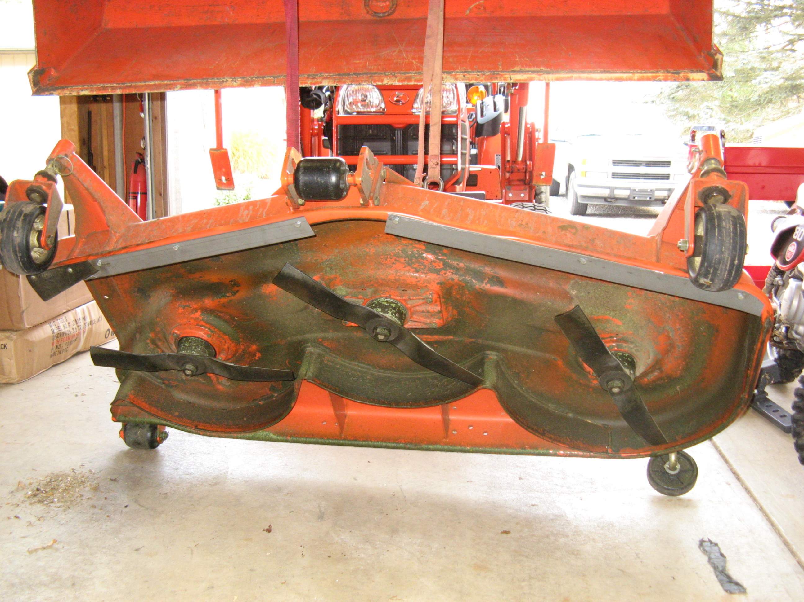

Some Kubota MMMs have "blowout plates" attached under the leading edges of the deck from the factory or they can be added later. The holes for attaching them were already drilled on the bottom edge of my deck. They do just what the name implies by keeping the debris picked up by the deck from blowing out in front of the deck. I know that they work for that purpose because I made some and put them on my 60" deck under my B3030. I need them for the vacuum system I use. Before I put them on it was hard to suck up dry leaves without having them blow all over the place. With them it makes the deck work much better at vacuuming up the dry stuff. They work for me whether I have the vacuum attached or not. It might be your answer.

I just found out from my dealer that many "standard" kubota blades are high lift. I know my low lift blades make a lot less dust than my high lift blades.

I just learned about "high lift" blades, which another poster claims are standard OEM for Kubota. These high-lift blades 'suck' more that standard lift or low lift blades. More suck obviously means more dust and debris.
