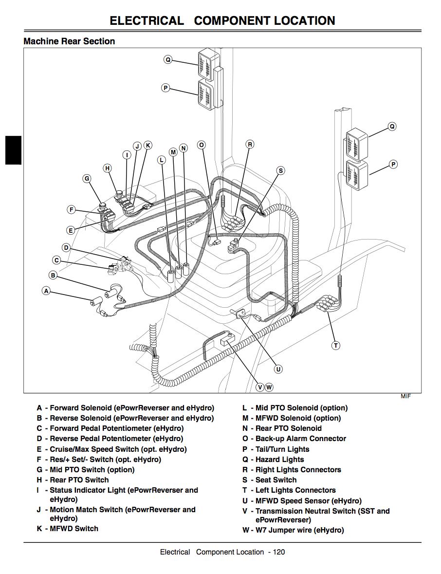

Where is this MFWD sensor on the tractor located ?
