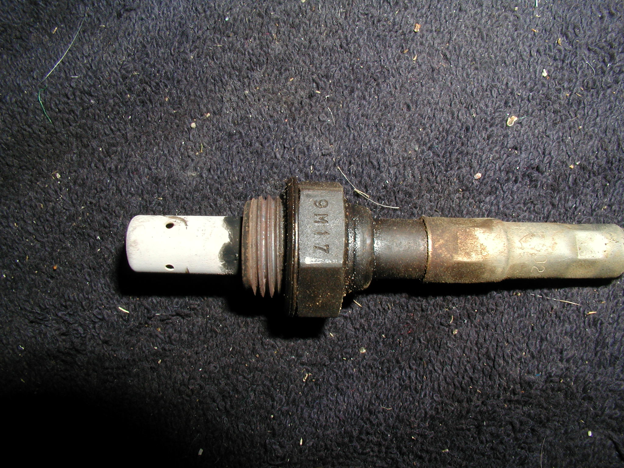

Well after reading more of your comments and doing some more research (gotta love the internet :thumbsup:) I think what I will try to do is pull the oxygen sensor just in front of the catalytic converter. That's basically opening a hole and if it powers up, I can replace the catalytic converter and call it quits.
I priced out a replacement catalytic converter at Canadian Tire and they can get on in a day or two for $350. That's not too bad I don't think.
If taking out the 02 sensor doesn't do it, then I have to go on with the investigation. And Soundguy, there are other sites out there that also suggest the TPS can be a potential culprit as well. BUT...the vast majority of everything I read, including some Dodge sites, suggests that loss of power in the 2nd generation Dodges like mine is frequently attributed to a clogged cat converter.
I will say, that I'm actually almost enjoying the investigation now though thanks to you guys and my other research. As I said at the onset, I'm not too mechanical, but I was under the truck today spraying so lubricant on the O2 sensor in prep for the test and was kind of enjoying it :ashamed:
Anyway, I'll be sure to post the results of my test once I get at it.

Ok, so I couldn't wait :laughing: I just had to try it.
I unplugged the O2 sensor, unscrewed it from the pipe just ahead of the catalytic converter and pulled it out. I think it looks ok. I've attached a pic of the O2 sensor.
Then I took the Ram out onto the roads and highway around my acreage. Wow! It is a very significant performance improvement! Came up to highway speeds quite easily and then cruised comfortably at 100-110 km/h with the accelerator half way down. Punching it actually resulted in the tranny gearing down and real power getting to the rubber! What a unique experience!! :laughing:
I had a board member point out to me in an IM that the O2 sensor hole should probably only be a partial improvement as some exhaust would still be trying to get through the cat converter. I think he is right and hope that means it may even be a little better.
Now of course I did get a check engine light come on since I had removed the O2 sensor, but that should go off once it is replaced.
So what now? Well, I guess I'll order the catalytic converter and a new O2 sensor. I'm a little hesitant to do that install myself, but then I'm getting more comfortable by the moment! ;)
Thanks to all you guys for your advise on this! It's great to have a place to go where the folks in the know don't belittle the folks in the dark :D I appreciate it.
I'll be sure to take pics if I take on the install myself and provide an update. Sure hope this is the long term fix!!!​

   / Troubleshooting Gutless Dodge 2500 #49
Uh-oh, is there a mechanic in the making!:thumbsup:
Not sure how the converter fits into the tailpipe section but suggest new clamps rather than trying to use the old ones. An angle grinder comes in handy for cutting the old ones off rather than mess around with trying to save them. If it's in a shop it takes a lot less time to junk the old and install new. There are also times the exhaust pipes just don't want to fit together. Expanders make that a lot easier.
And also be aware that the tailpipe might be pretty thin and then the muffler seems kinda dented and the hangers are getting to the point nothing can hang on them and???:)
   / Troubleshooting Gutless Dodge 2500 #50
So what now? Well, I guess I'll order the catalytic converter and a new O2 sensor. I'm a little hesitant to do that install myself, but then I'm getting more comfortable by the moment! ;)...
I believe your install will be virtually the same as mine, so if so, here are some pointers: The install is not bad at all; however, getting the old one off can be a real pain. I had a hard time getting the muffler separated from the catalytic converter. I left the cat attached to the exhaust manifolds until after I got the muffler separated from it so that the cat would be anchored and I could pull the muffler off of it. It took a lot of banging and pulling and twisting(don't do this part with the truck jacked up) before it finally came off. Also, make sure you have the truck up high when you go to actually pull the cat out. It is kind of long and odd shaped with the tubes that run up to the exhaust manifolds, and I barely had room to get mine out(if you have something you can cut the tubes with, it would make this part much easier). The new one is easier to install because it comes in two parts. Make sure you get the clamp between the cat and the muffler tight, I had mine come apart there twice before I got it tight enough. If it does come apart, it won't hurt anything because there are enough hangers to keep it from dragging the ground, it will just all of a suddenly get very loud. As Egon said, I would not bother trying to reuse old clamps. I would also suggest buying new bolts and nuts for the cat to exhaust manifold connections.
