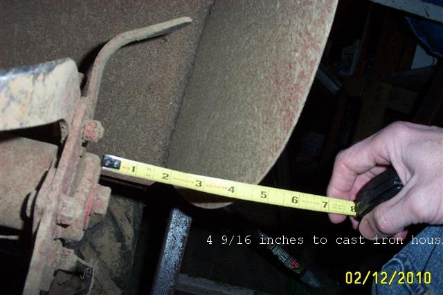

Could either of you post pictures of the side shields of your tine shroud? One side of mine is missing, and I think the other has been 'modified'.... I found a new tiller shroud, but it's ~250.00........ No thanks. I can get some sheet metal and fab one myself. I'm sure one of our neighbors has welding equipment. Just really needs to be spot welded. Or I could just bolt them on.
   / Troy-Bilt Horse ID #27
The tricky part may be that the side shield doesn't come straight down and appears to flare out about 1 1/4 to 1 1/2 inches roughly. I can't figure out how to measure it exactly. The side shield is 4 9/16 from the side of the cast iron tine housing, but keep in mind that the housing is inset relative to the top of the tine shield.
