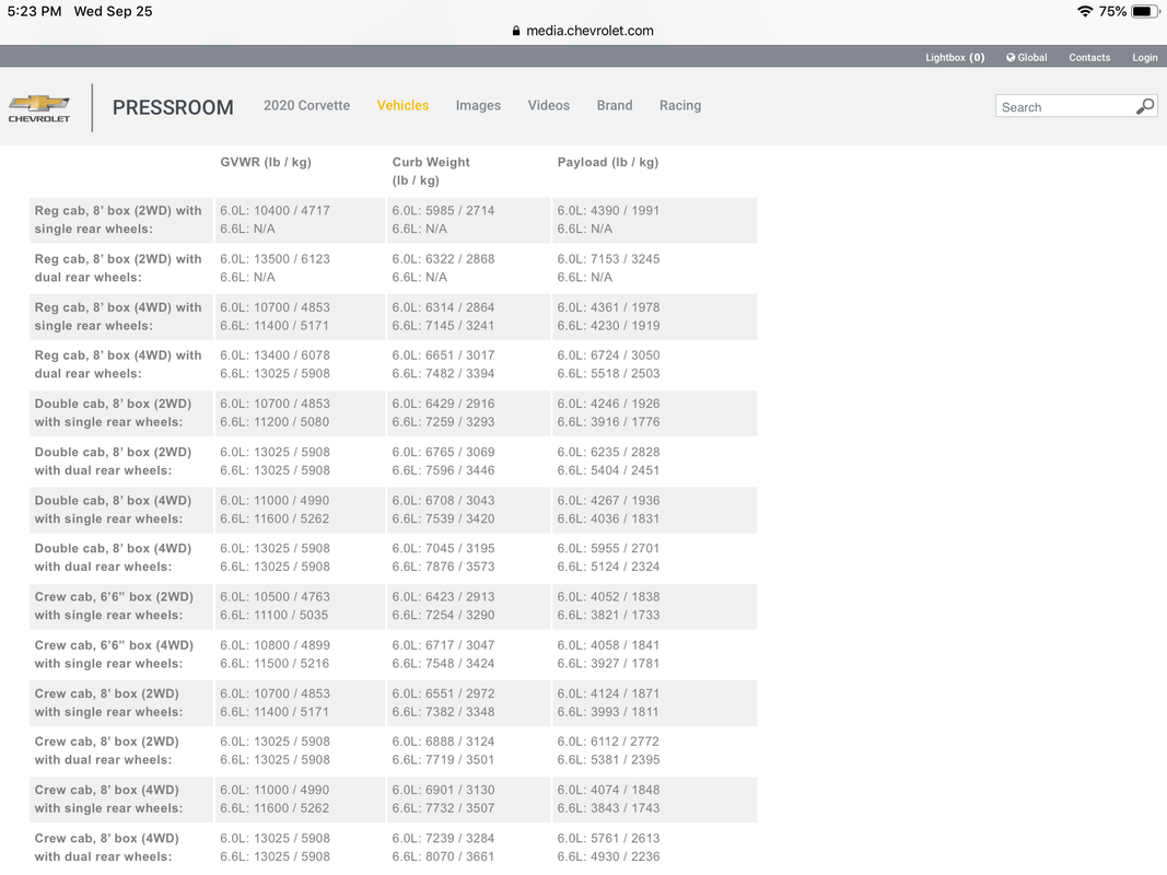

Here’s the 2019 Chevrolet 3500 specs. Remember, this is going to be base weights. Options will come out of payload. Also, this is 2019, so the 6.0L is the gas engine. Next year, the weights will be slightly different.

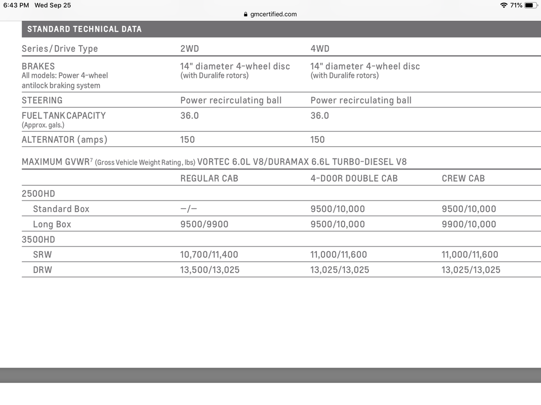

Here is the link to the specs of my truck. It is a 2015 2500HD crew cab 4x4 short bed. It has the Vortec 6.0L V8. GVWR is 20,500.

From the document you posted, your GVWR is 9,500-10,000, depending on factors. The GCWR, which you keep referring to as GVWR is 20,500 lbs. Huge difference. The GVWR is how much that vehicle can handle. For a truck and trailer, they will each have their own GVWR. The truck has to hold its own weight, the weight of passengers and cargo (in/on the truck), and the tongue weight of the trailer, all at or under the GVWR of the truck. The trailer must be at or below its GVWR when not attached to the tow vehicle. Some trailers list a higher GVWR to make up for transferred tongue weight, some do not.
This is important because legally, the GCWR is a made up number, from assumptions made by the manufacturer. The GVWR is a number you can be cited/ticketed/charged with a crime, for going over. If the GVWR is okay, axles and tires are the next common weight issues. In civil court, if you get sued, it will all be used against you. The Trooper won’t know or care, so long as the GVWR’s are not exceeded.
Here’s the GVWR, from the document you posted:
   / Truck and Horse trailer questions #18
Further down the document, you can see you have a GVWR of 9,500 and a posted payload of 2,950. Generally, this payload does not include options. See the door jamb for a closer number.
Even with these numbers, your truck probably weighs between 5,500 and 6,500 lbs. At 6,500, that only allows 3,000 lbs for passengers, cargo, and tongue weight. Say people and stuff in truck is 500 lbs, that leaves 2,500 lbs, for trailer tongue weight to max out GVWR of your truck. That truck can legally haul 10,000-12,500 lbs (25% tongue weight versus 20%) on a gooseneck or fifth wheel.

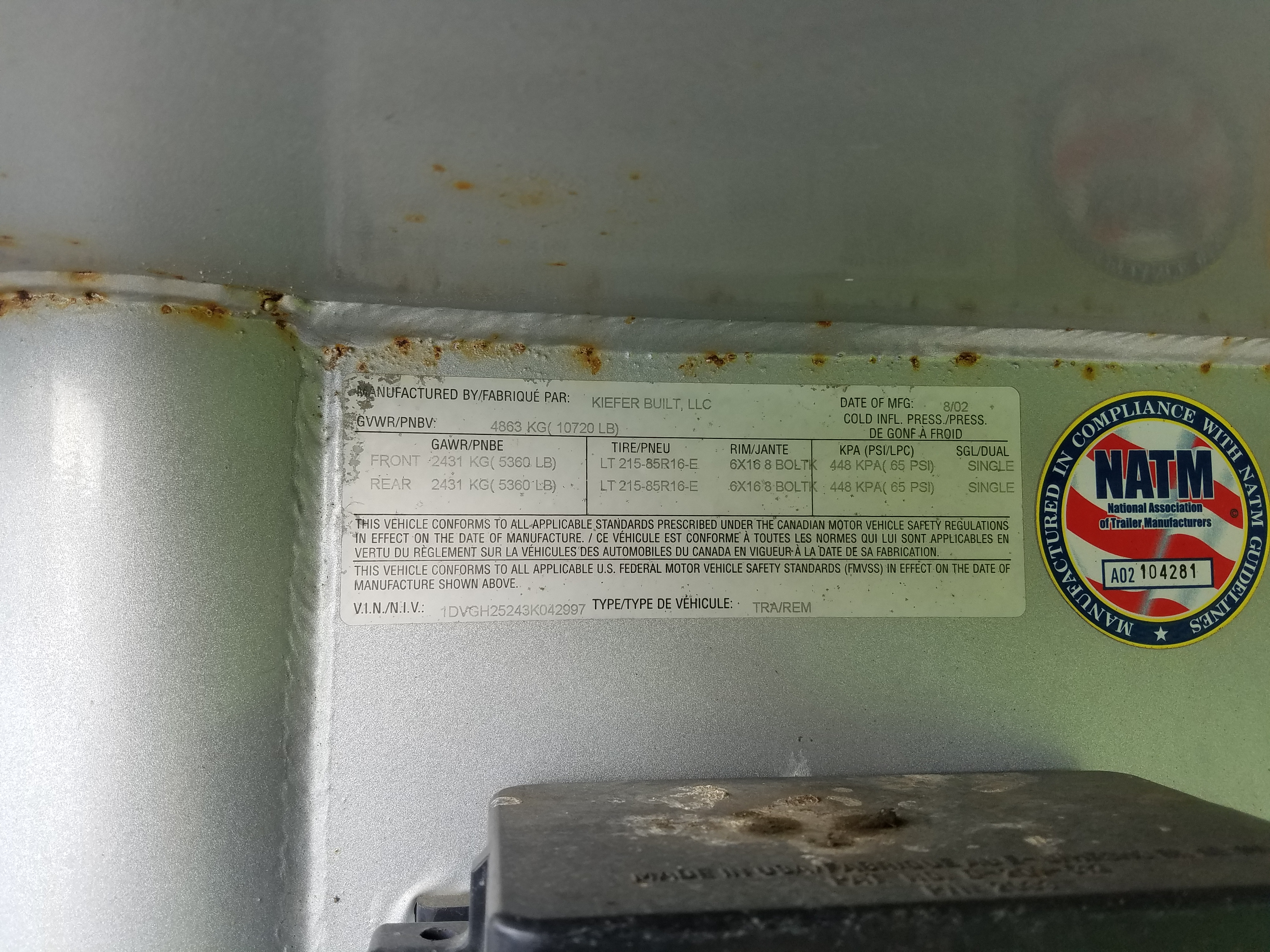

Thanks, that actually all just clicked. Treating the truck and trailer as separate parts and including the trailer tongue weight as part of the trucks individual capacity. I only see the weight issue being a legal issue if there was an accident of some sort if I was over weight. I know with my current set up I'm not over the limit or else something may have already broke. 20190916_162241.jpg
