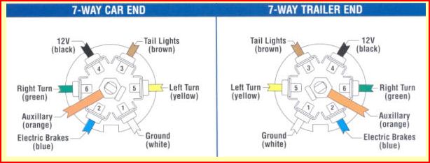

Which wire stays hot ?
Do you have a separate wire to charge batt ?
In the attached diagram it is pin number 4. That is the pin that is designed to charge the battery.
BTW, that diagram is the backside of both connections.
Now, ignore this if it confuses you, but you to give you an insight to how my warped mind works. To visualize wich pin is which when you are looking at the connection that we normally see (ie when we raise the cover on the truck receptical), the trailer version would match up to what you see when looking at the plug on the truck and vice versa.
Seems kind of dumb to me, but what do I know?
I don't know about that. Yes, it certain circumstances it can be a pain, but vice versa I may have my trailer hooked up for several hours but only drive a few miles. It will give it a good charge. Easier for someone to disconnect the 7-way umbilical if they are going to be hooked up for awhile than it is to hook up a battery charger to charge the battery. The solar chargers aren't too bad, but even with that, since mine charges the whole time I'm hooked up, I pull frequently enough that I don't worry about it.

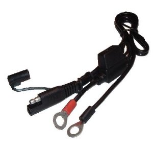

I hate having to un-do the U-bolts and take apart the weatherproof box to get the battery out. Also, I hate the idea that if I stored the battery indoors on a charger, I would have to take the time to put it all back together before using the trailer. So I put one of these ring terminal harnesses on it.
That way, I can easily put a trickle charger on the battery every once in a while to keep it topped off. My breakaway kit is not wired with a charger circuit, so I can't charge it through the vehicle harness.

Not all vehicles do. I believe Ford & Dodge do, but GM doesn't - or at least didn't at recently as 2008. Our 2008 Suburban and 1999 Silverado are hot all the time.
You are right, but this is only on the factory setups. Toyota and Nissan also did it right but GM took the cheap route and took out the relay. I have seen this more than one time.
Chris
Like I said before, I actually prefer it this way. I think GM did it the correct way. It also allows you to use the plug for other things back there. I have my diesel fuel pump rigged up to run off it. I can fill my tractor by plugging into the trailer pig tail. I also have a small water pump rigged up this way so that I can transfer water from the storage tank on the truck to the holding tank of the camper. I also have my yard sprayer rigged up to use the same plug. So, again I'm quite glad that GM did it this way. I would be mad if I had another brand and couldn't use it the way I want and probably would be rewiring it.
