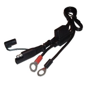

I hate having to un-do the U-bolts and take apart the weatherproof box to get the battery out. Also, I hate the idea that if I stored the battery indoors on a charger, I would have to take the time to put it all back together before using the trailer. So I put one of these ring terminal harnesses on it.
That way, I can easily put a trickle charger on the battery every once in a while to keep it topped off. My breakaway kit is not wired with a charger circuit, so I can't charge it through the vehicle harness.
Yeah those are great a real time saver! OReillys has the 2 wire flat ends as a pair for a few bucks. I have them on my Harley and all my mowers and cars that sit awhile. Plus I took all my HF float chargers and put the 2 wire flat ends on them makes it easier to hook anything up to any one of my maintainers. :thumbsup:
