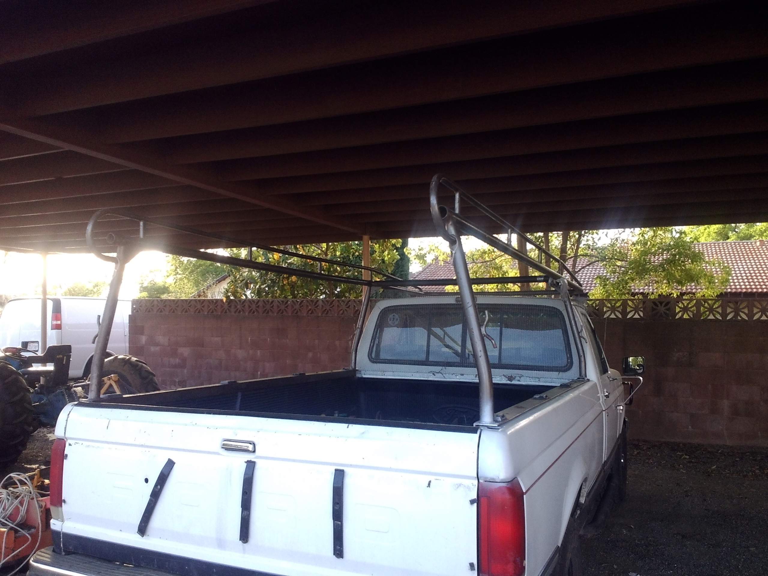

Several years ago, we bought and 89 F250 with a lumber rack. After not having a back bar and trying to make due, I think its time to bite the bullet and buy or make one. Any ideas for the diameter/ thickness of the tube?

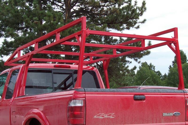

I am guessing you mean by lumber rack is the same as ladder rack, head rack,
first I would use square tubing,
probably about 1.25" and at least 10 gauge, probably use a light angle iron cap ing the bed.
and I would make some angles to weld in the corners, for some stability,
most likely a .75" square tube for the truss on top,

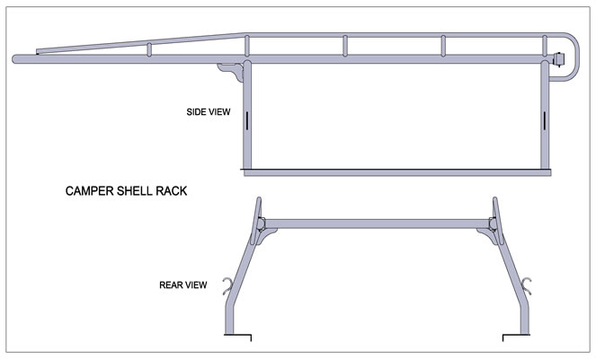

some thing like this, truck rack, California
here is close to what I would build, (red rack)

Have a shell on my pickup... many times needed to haul longer ladders...
wish I had thought of building a rack AROUND the shell like the link shows...
Will definitely do it on next pickup with a shell on it...

This is what is there right now. You would say 1.25" for the missing back bar? truck.jpg
/ Truck Lumber Rack #5
Use the same as the front bar... just be sure to fit & weld it properly..

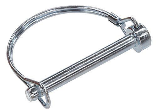

Yes removeable is the best, handiest. I'd make the rear crossbar with two smaller round pipes extending "forward". These are about 2 inches long and plug into the holes of your top bar. Insert the bar and drill a hole in each side. Then you don't need a wrench, or bolts, all you need is a couple pins like this.
It depends how much load you need to haul with it. If it's almost strong enough for what you do, (as is) then a pinned rear bar will make it stronger. If you intend to support heavy loads with it, you don't want any looseness at this joint, for that case will need a bolted and gusseted rear crossbar. This kind of stuff is difficult to assess on the internet.

When I was looking around, I found an old piece of gym equipment that had a steel tube, so I'll see how it does. Right now just u-bolts, but I might go with pins later. Thanks for the recommendation s.
