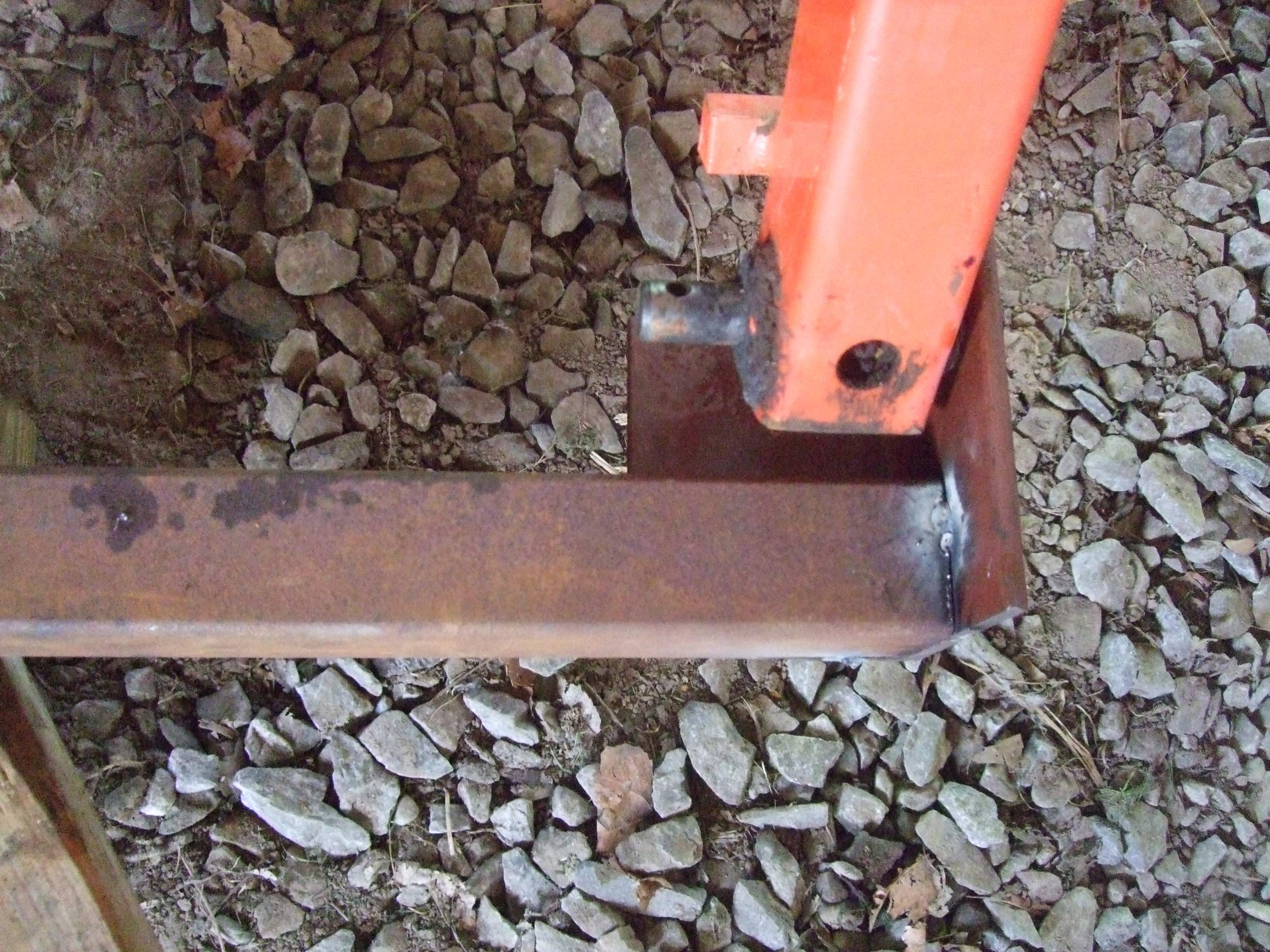

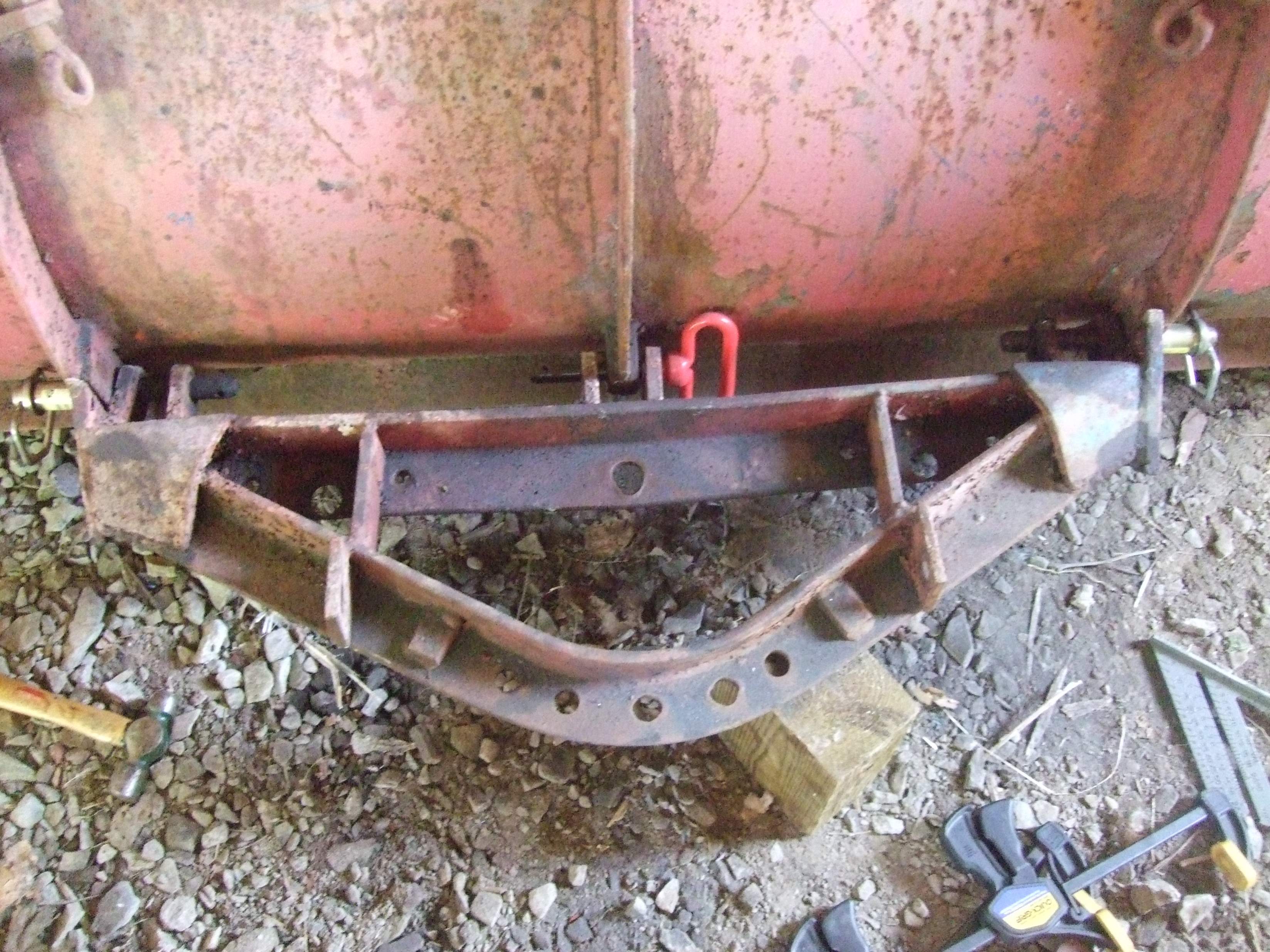

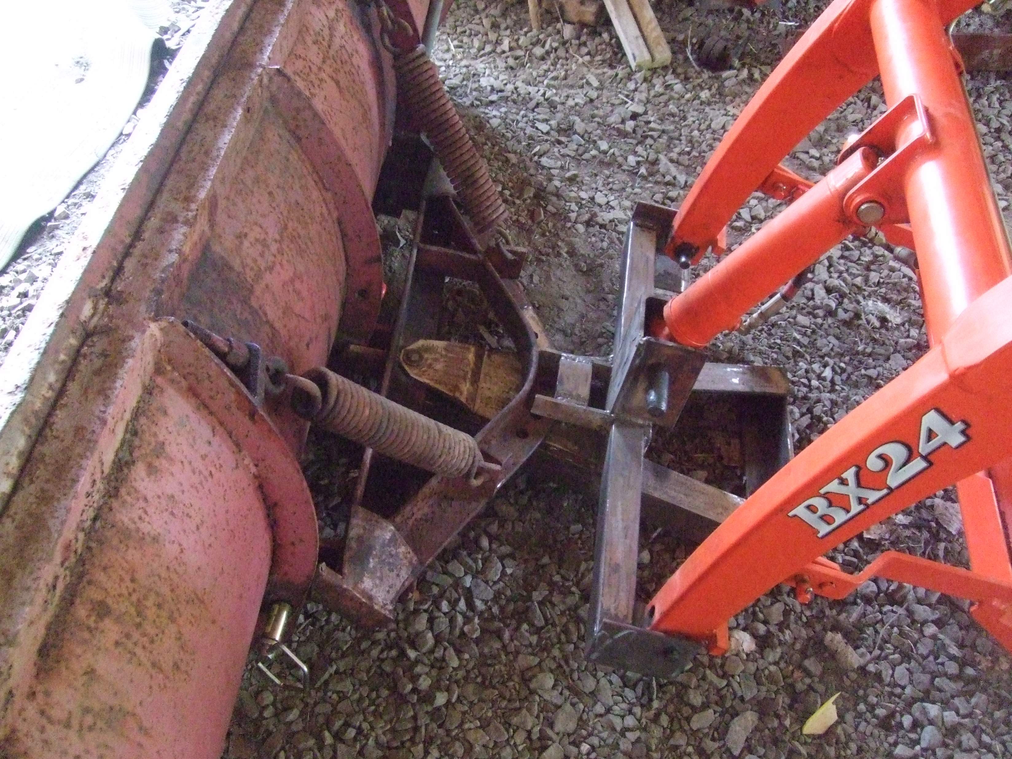

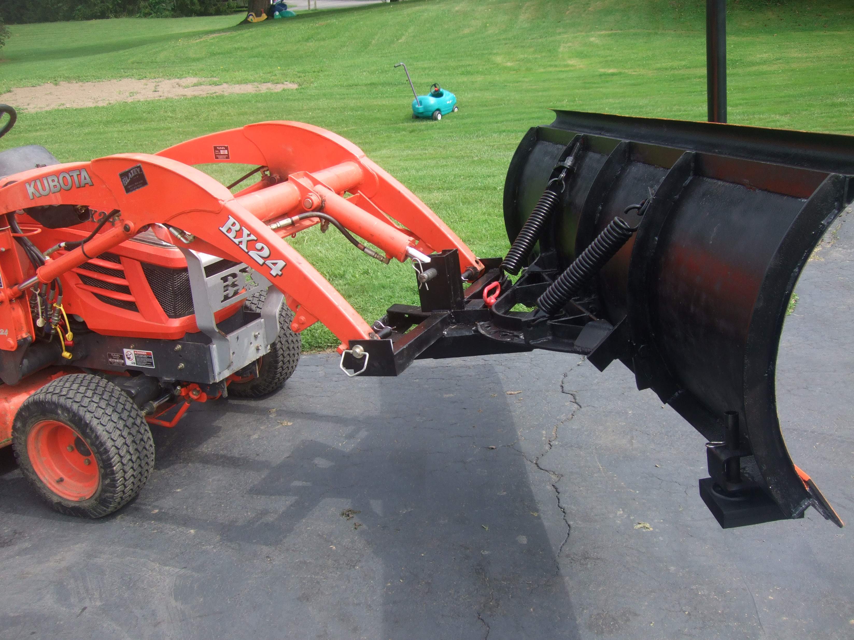

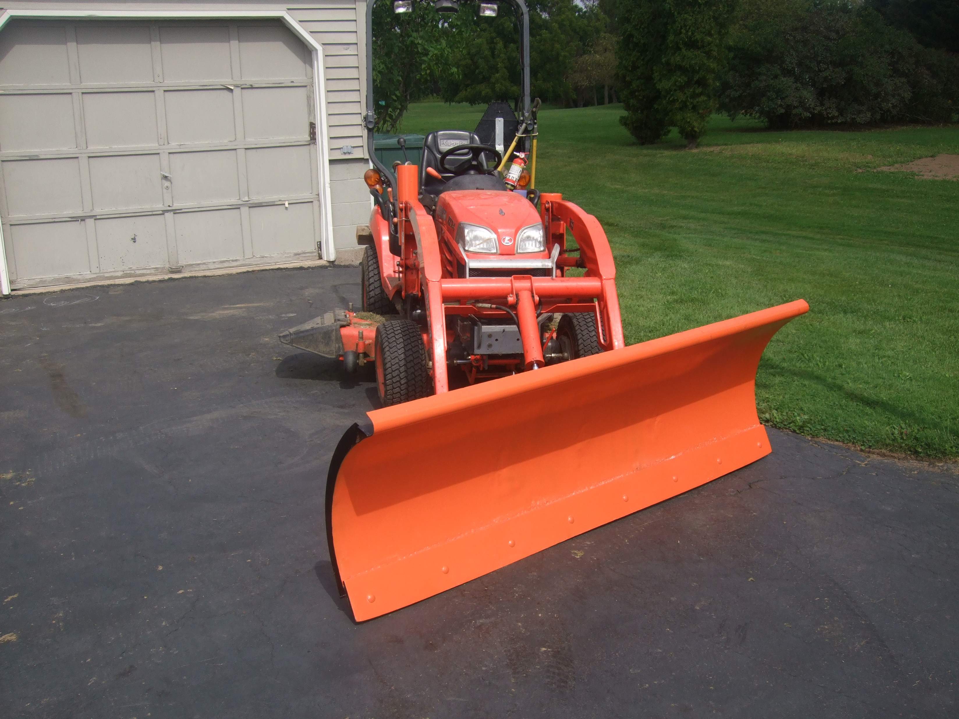

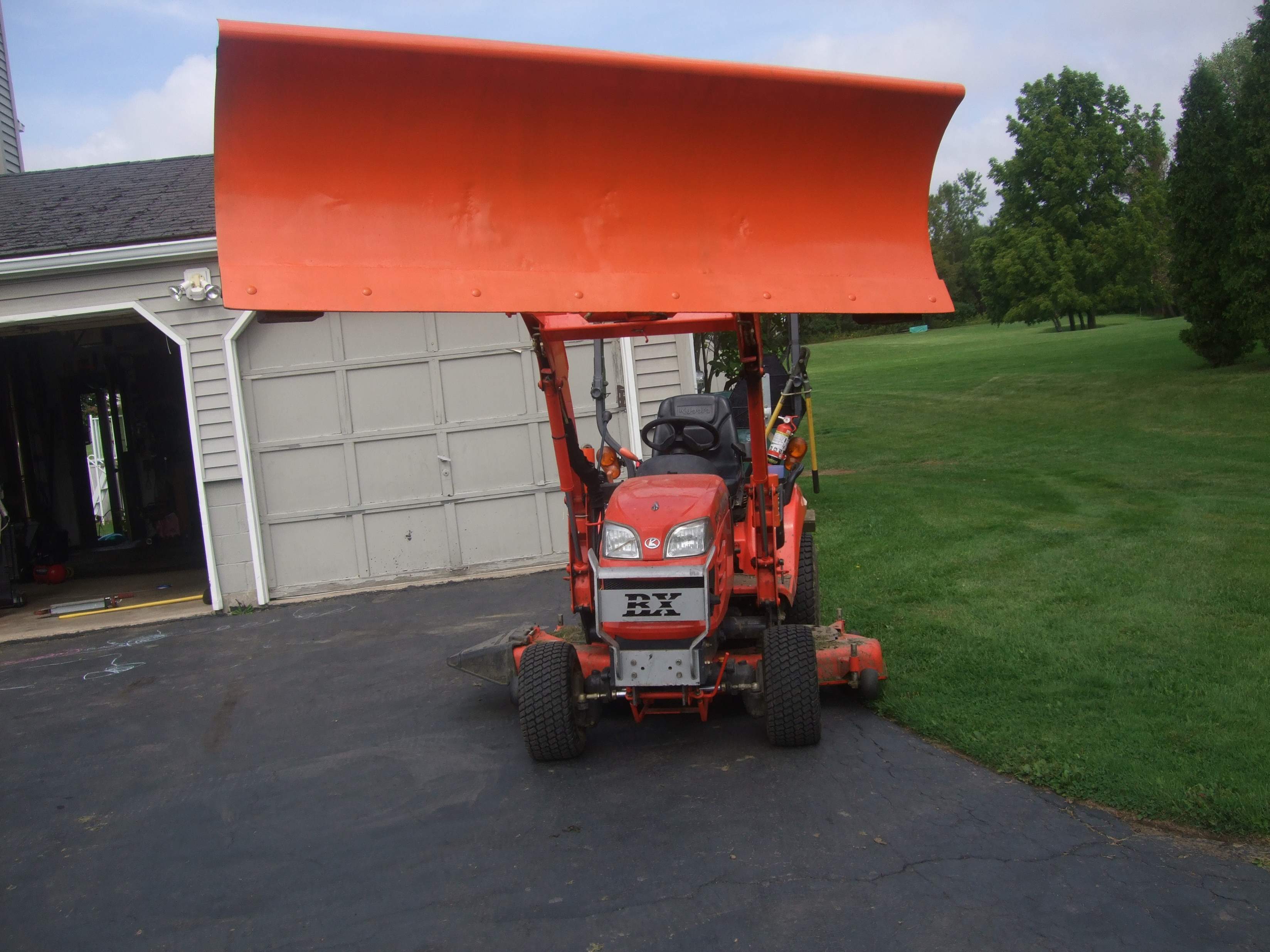

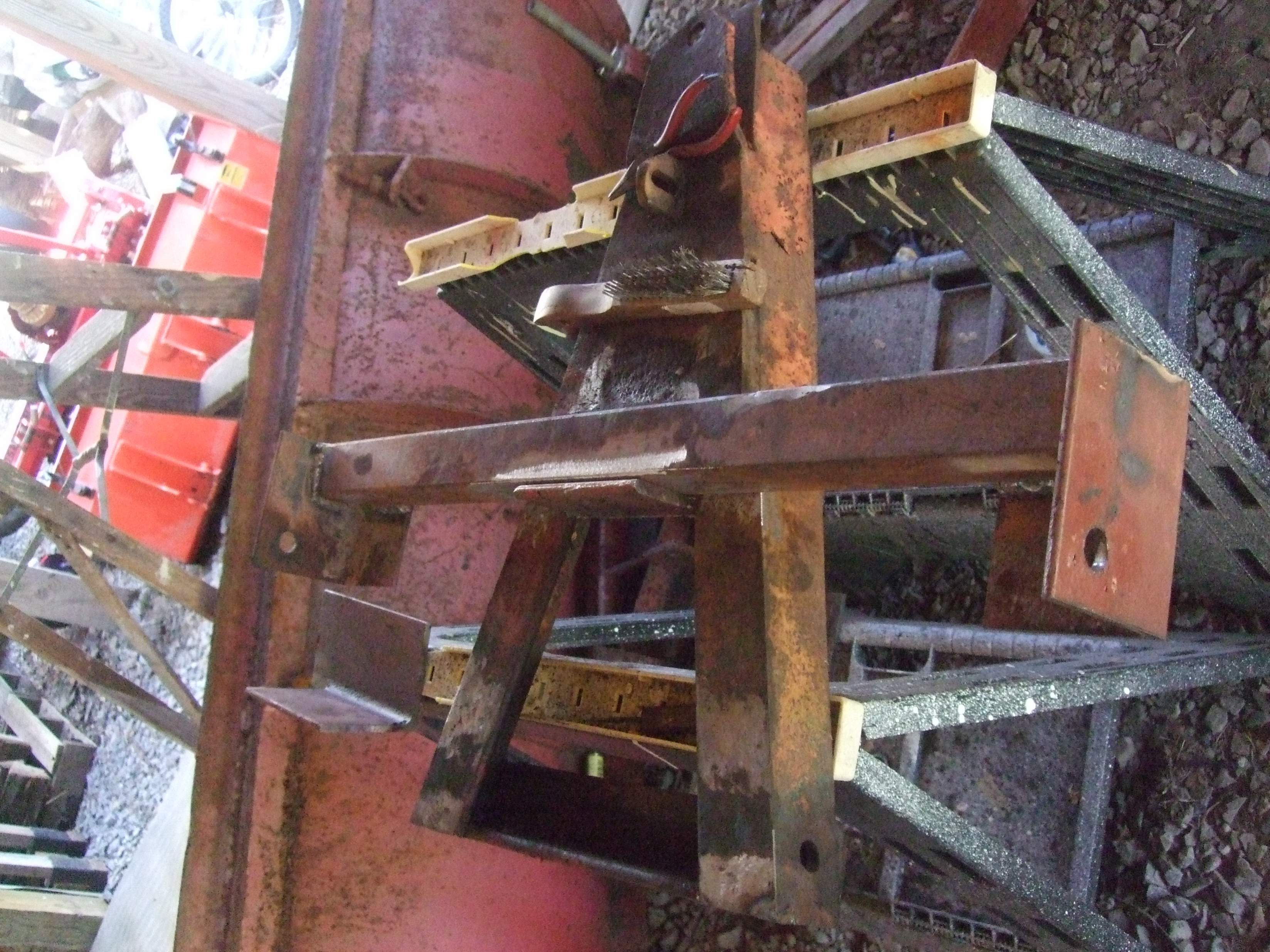

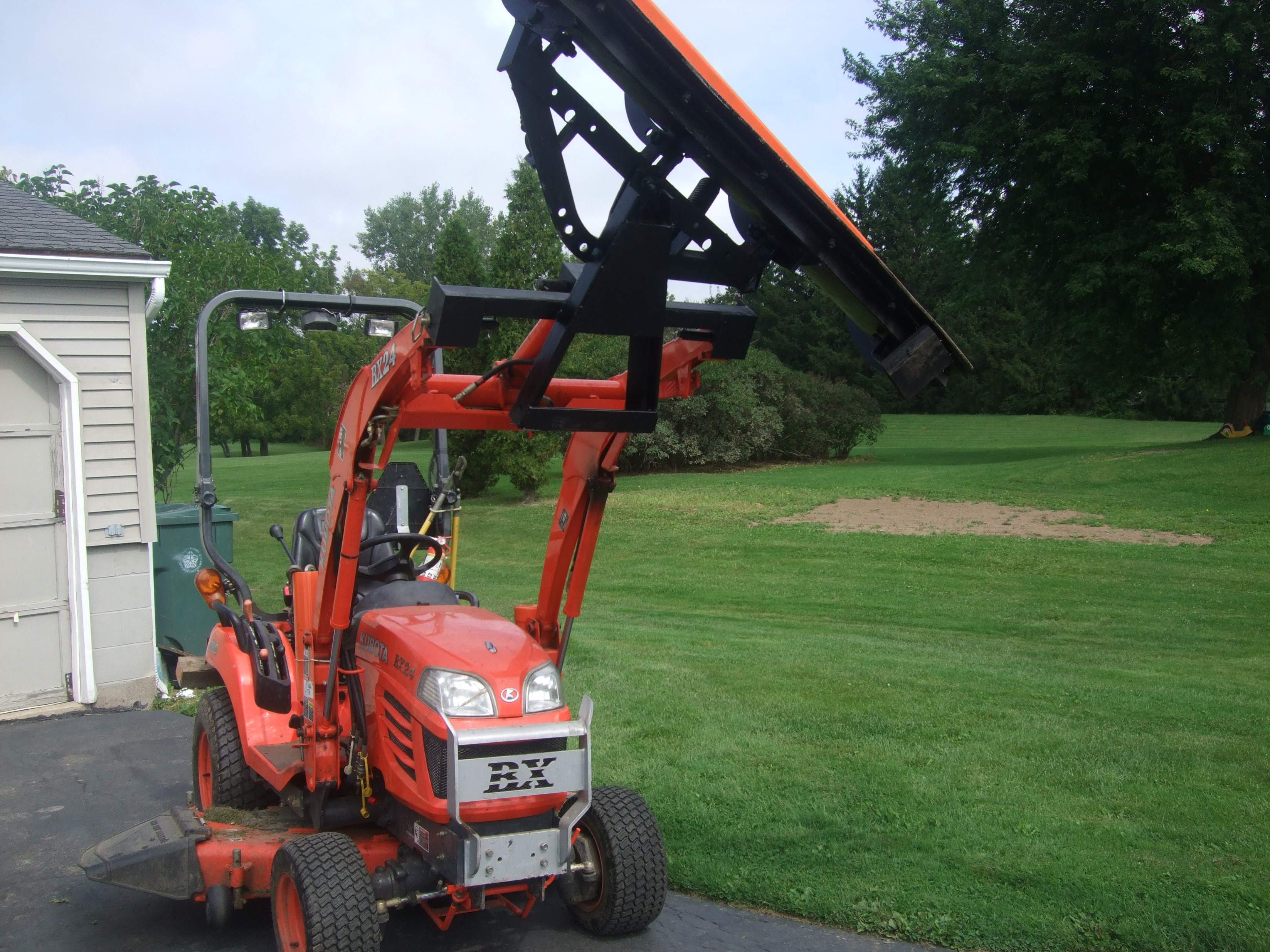

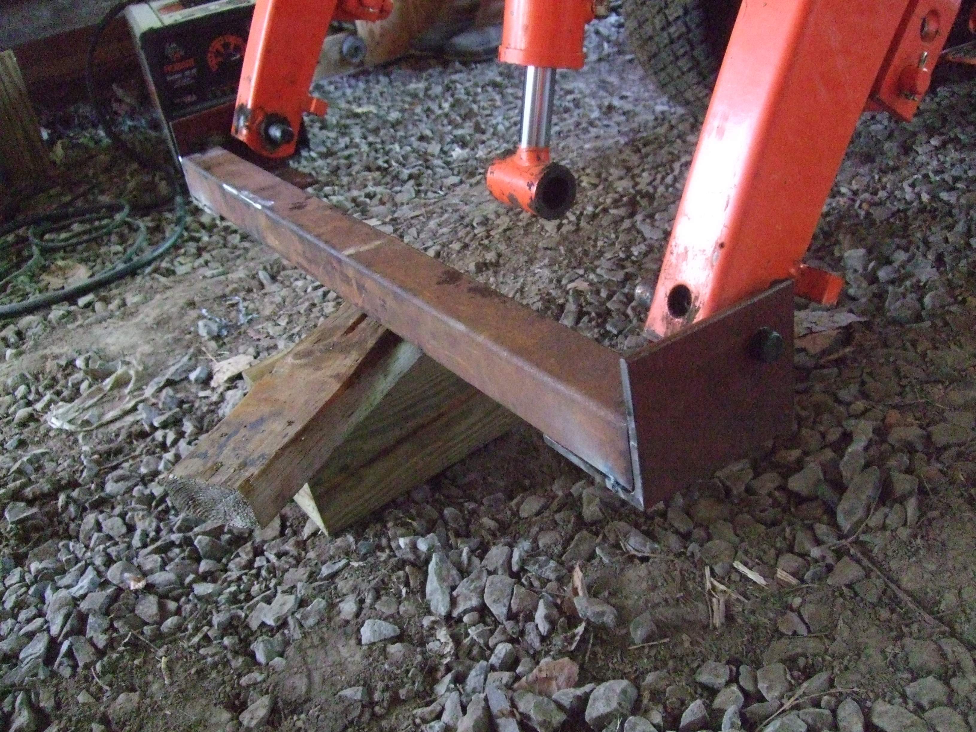

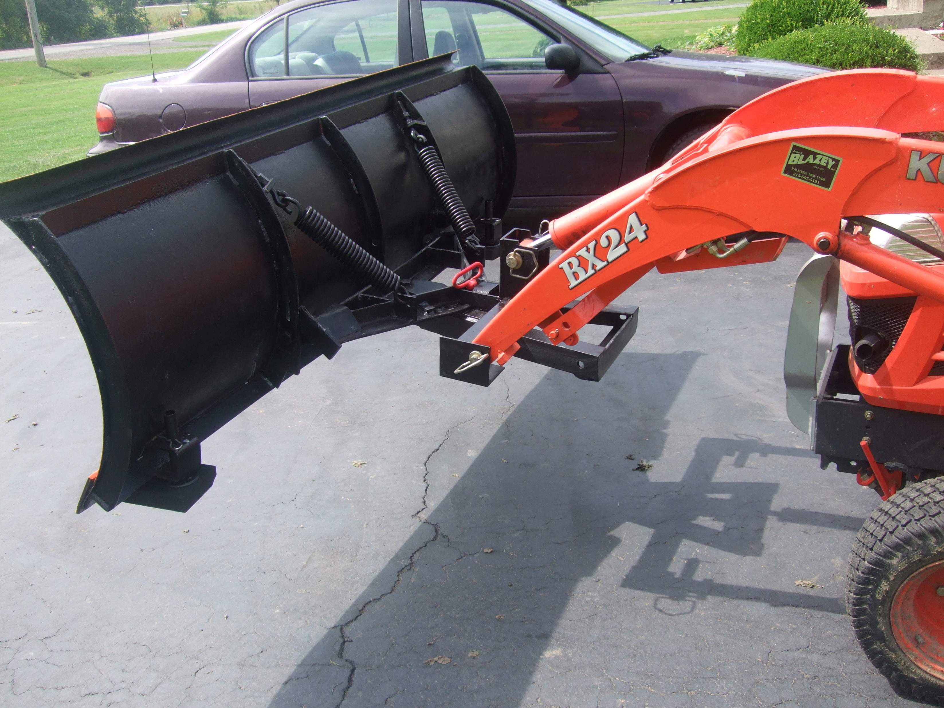

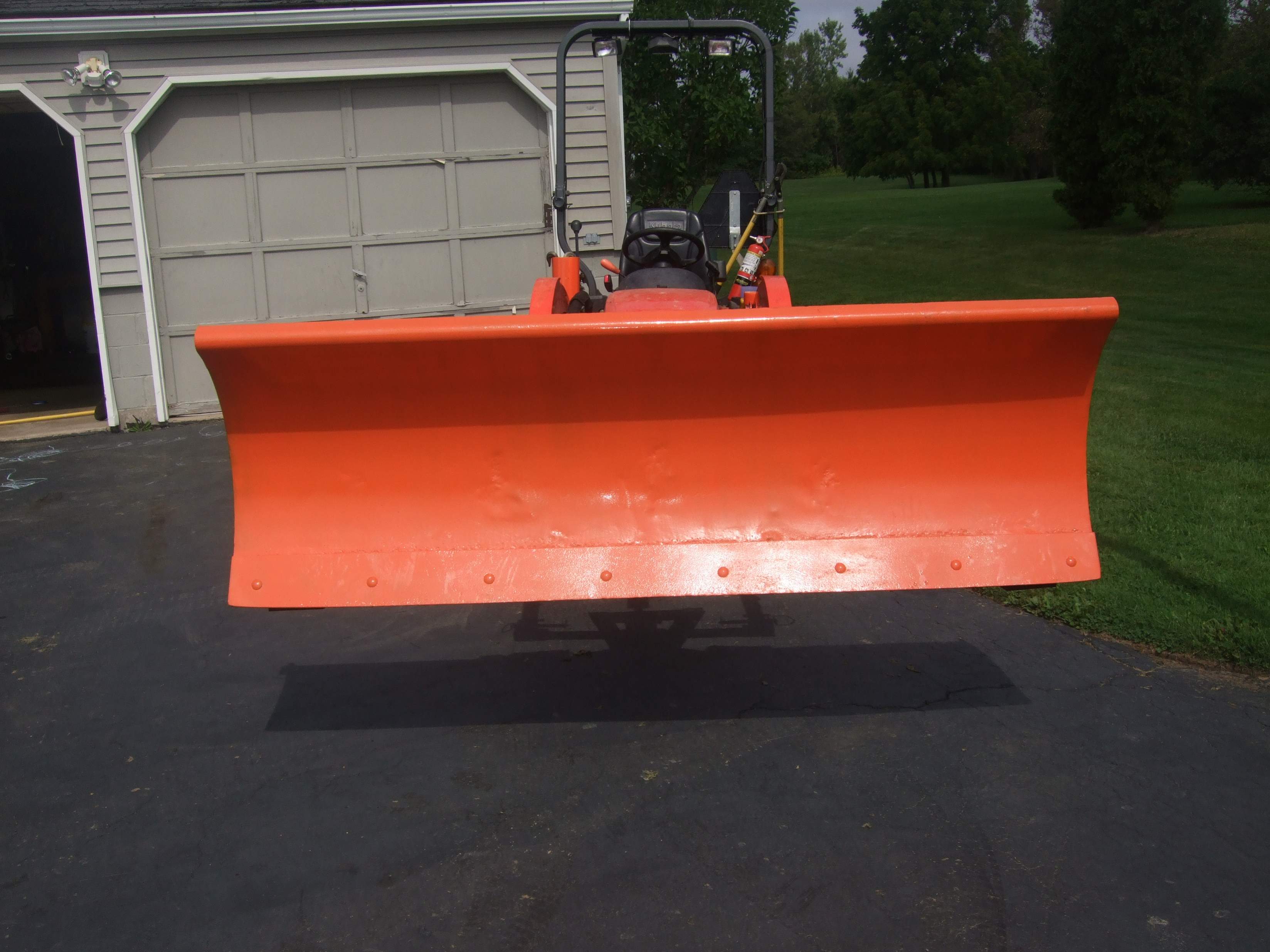

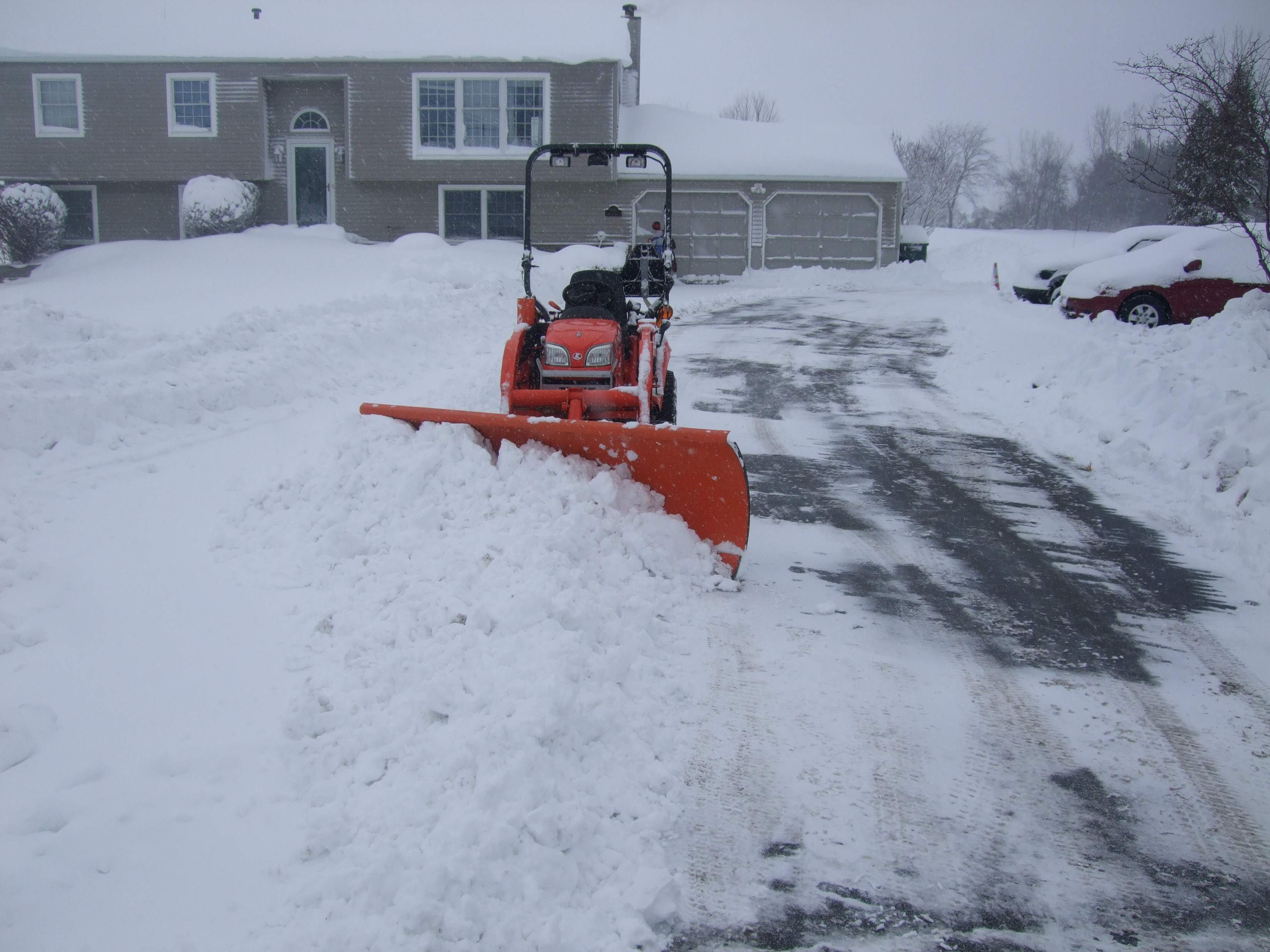

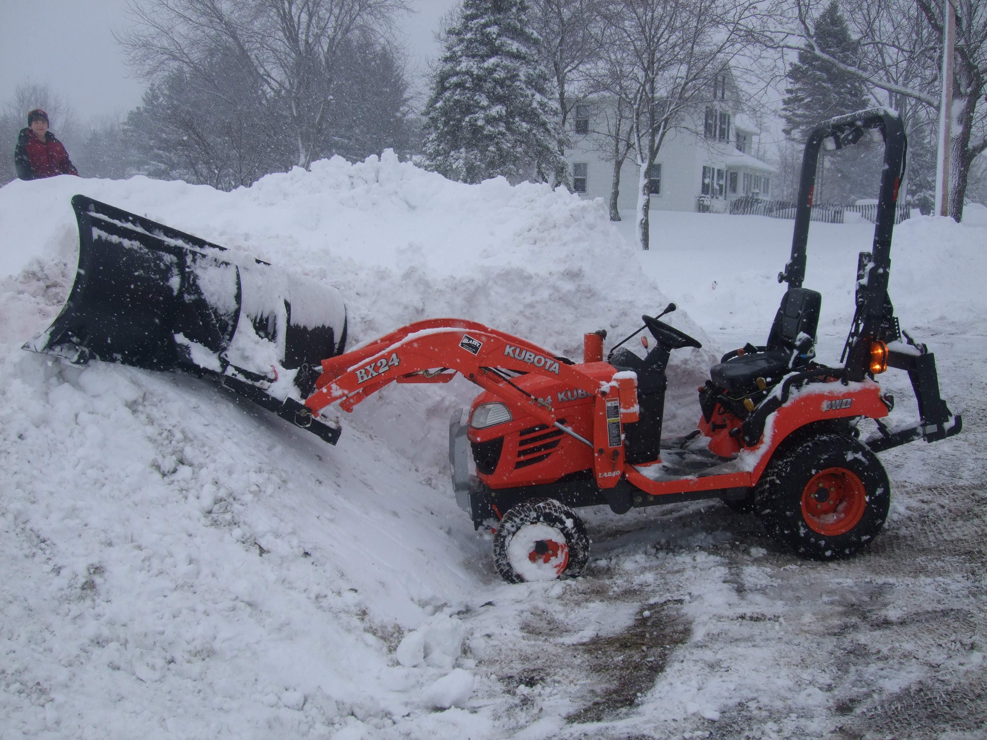

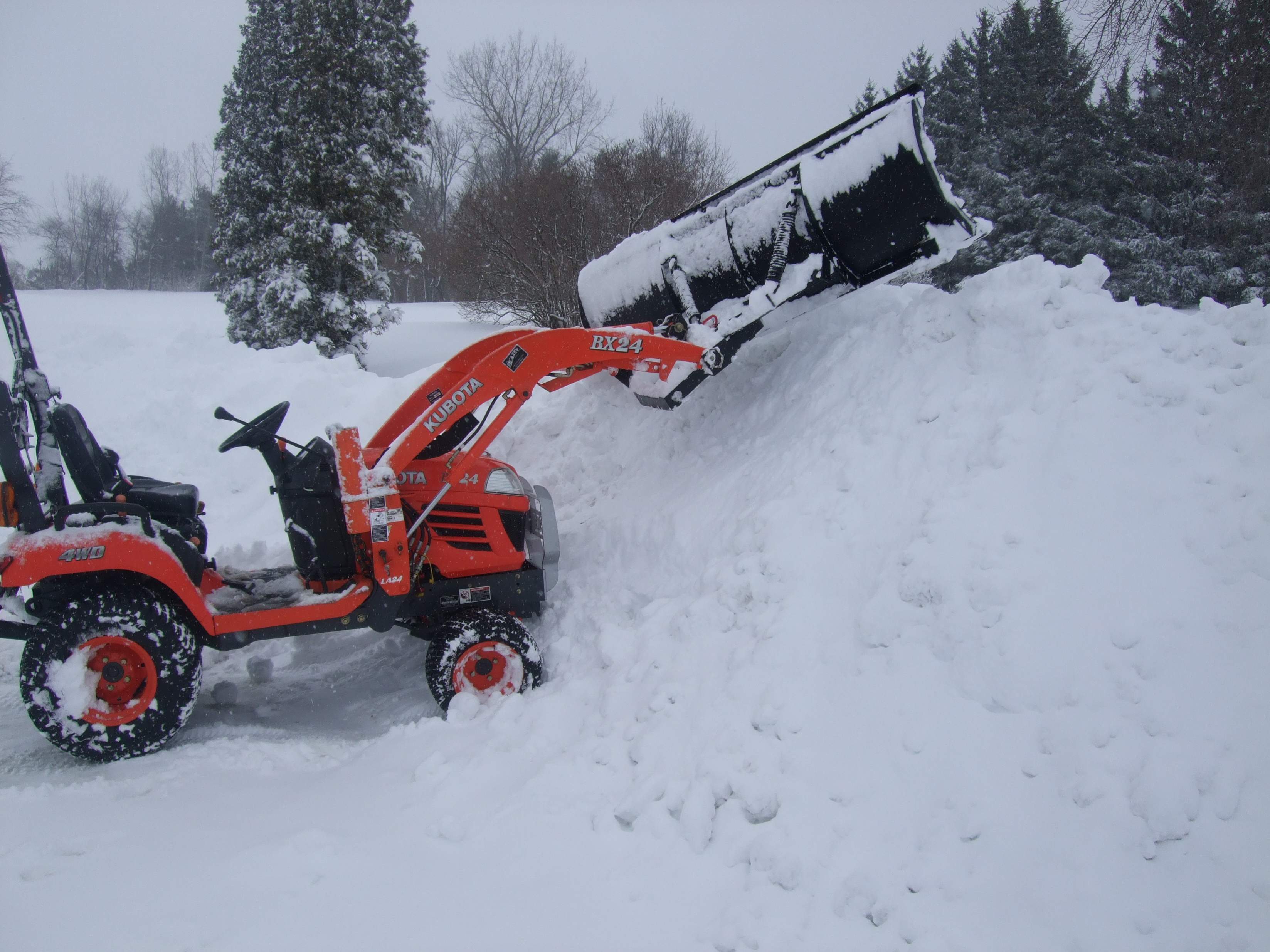

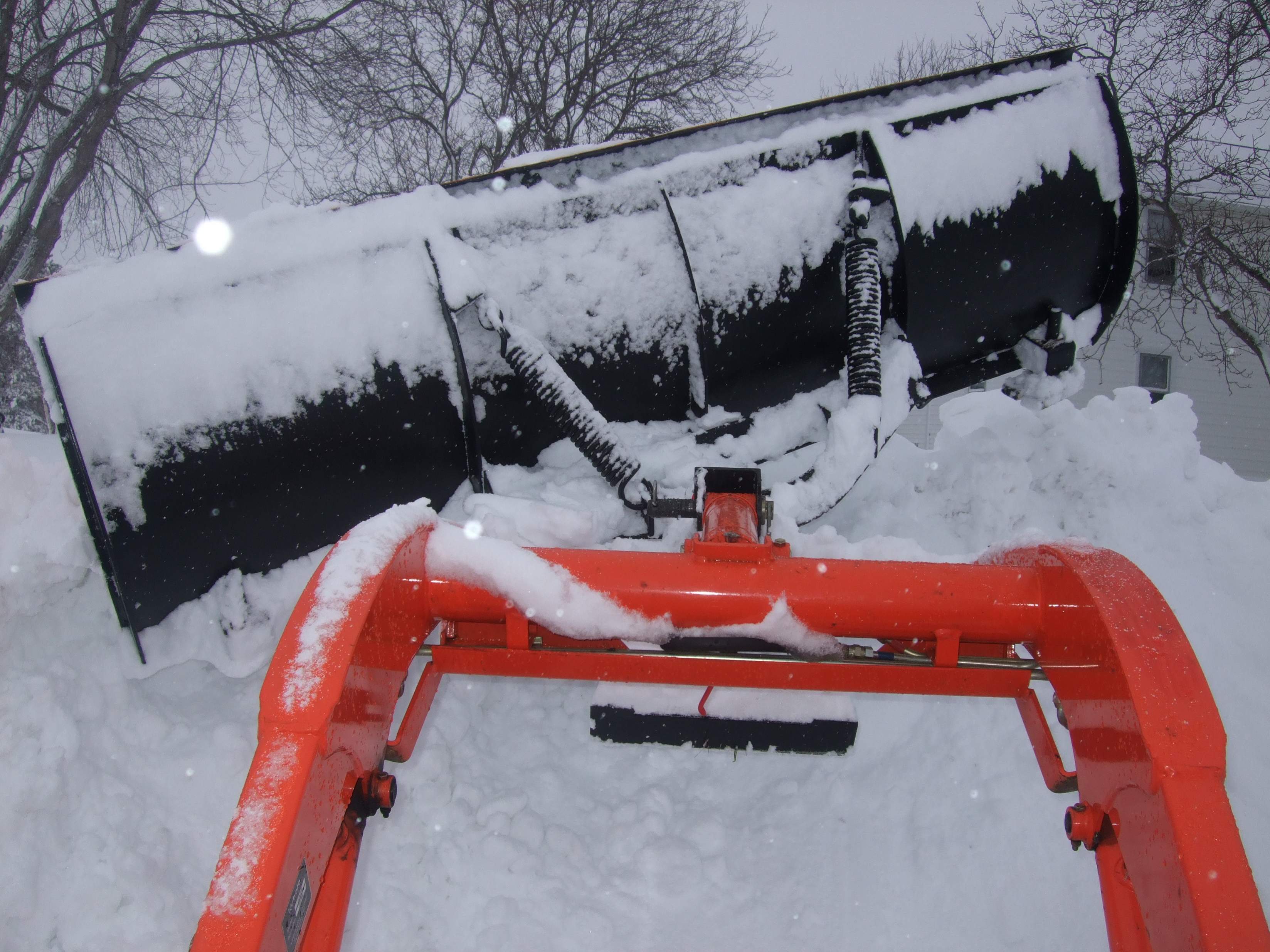

I'm bumping my old thread- I attached pics of my plow I put on the BX. So far I love it. It works great for my use and I love the fact I can push snow up the bank as high I can make it. I noticed that it works good in float and small loss of steering on blacktop, but on grass, it tends to trip the blade so I need to have a small lift if going forward on grass.
I really don't need the bucket as often I used to as The plow can hold some snow when curled all the way in while pushing up and over the bank.
