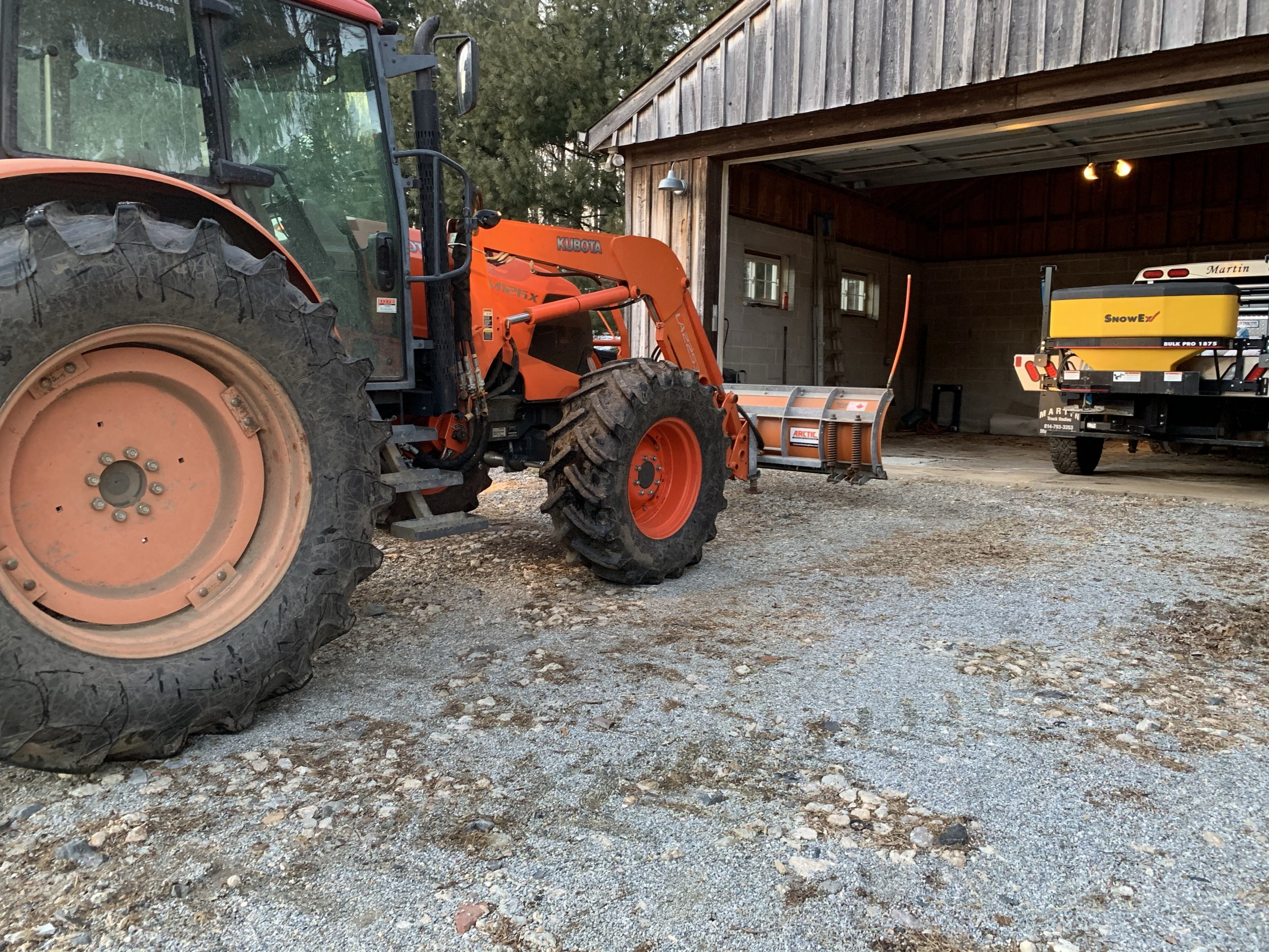

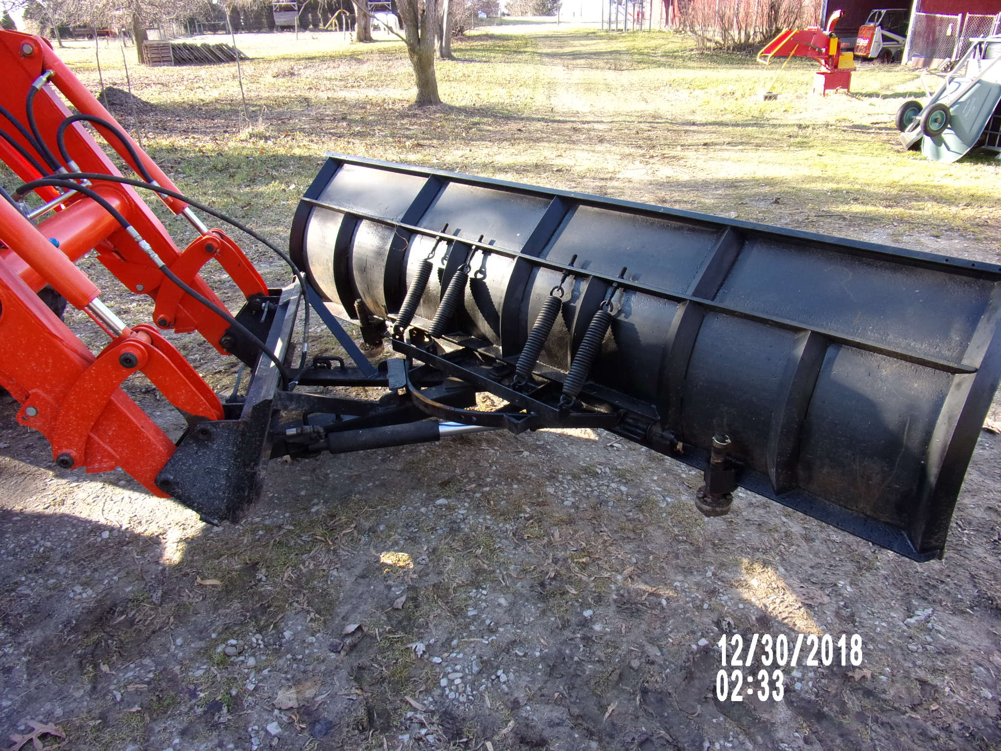

Got asked if I want to clear main roads in a development.

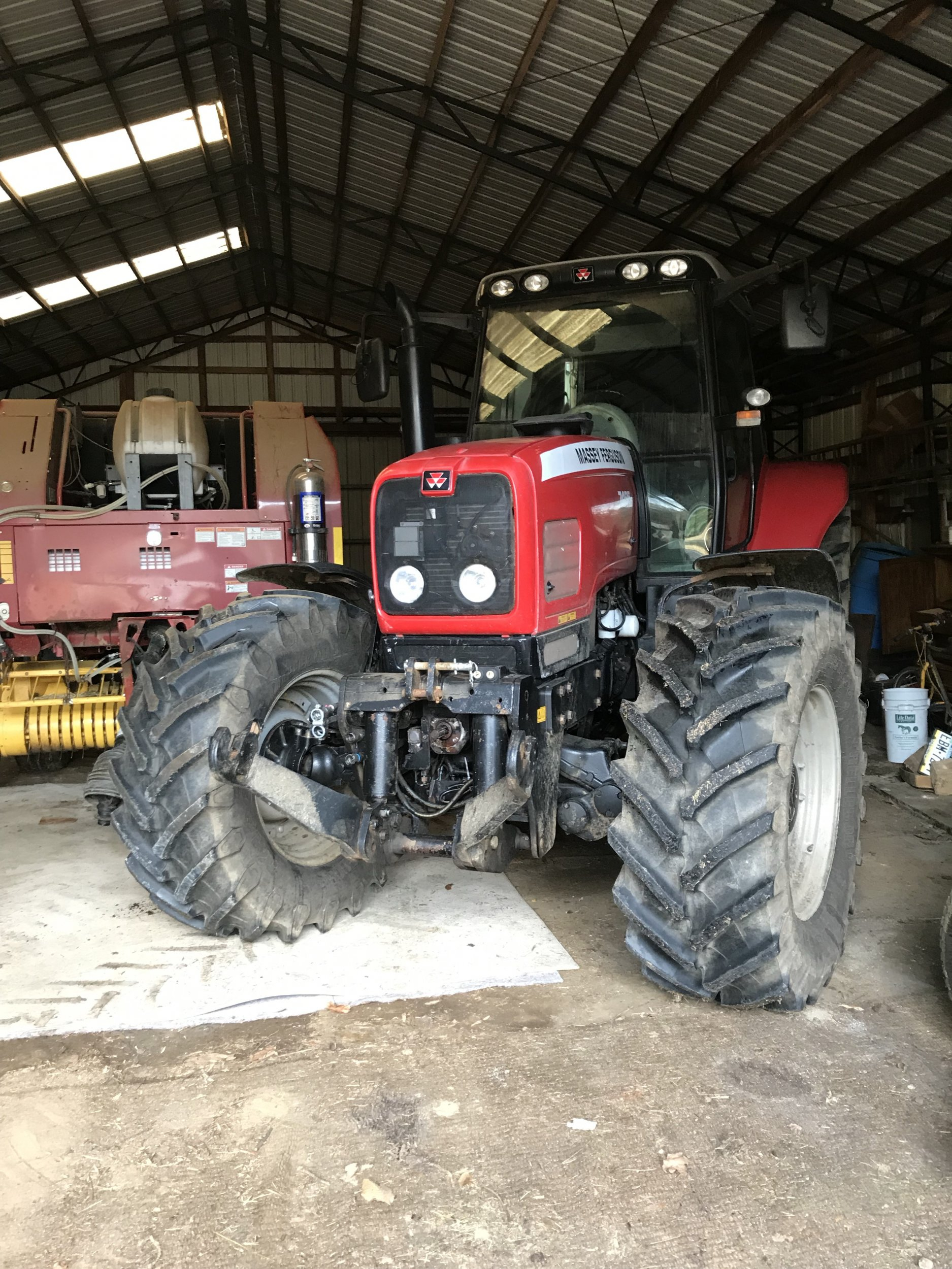

Anyone have a typical truck snowplow adapted to a tractor with a front 3 point?
I already have a plow attached to a loader on a tractor.
This would be farm tractor with front 3 point below.
Have hydraulics up front for power angling.
Thought a Western Heavyweight 9-10’ would be perfect
already have this Kubota with loader
and snowplow
This would be real expensive, but would be amazing to plow with.

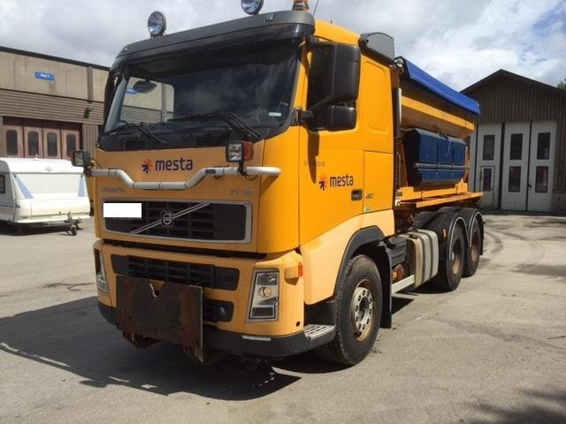

Isn't that the way it is done in Europe?

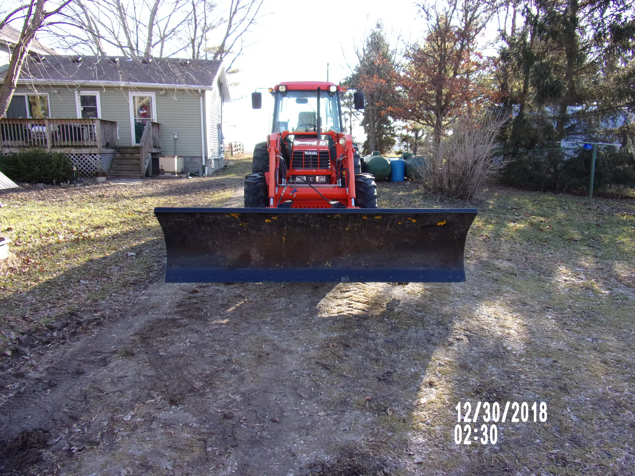

What I do. 10 foot repurposed power angle county plow on a SSQA plate on the front of my M9. One thing I do is I chain my fronts (not the rears) to reduce plow steer.

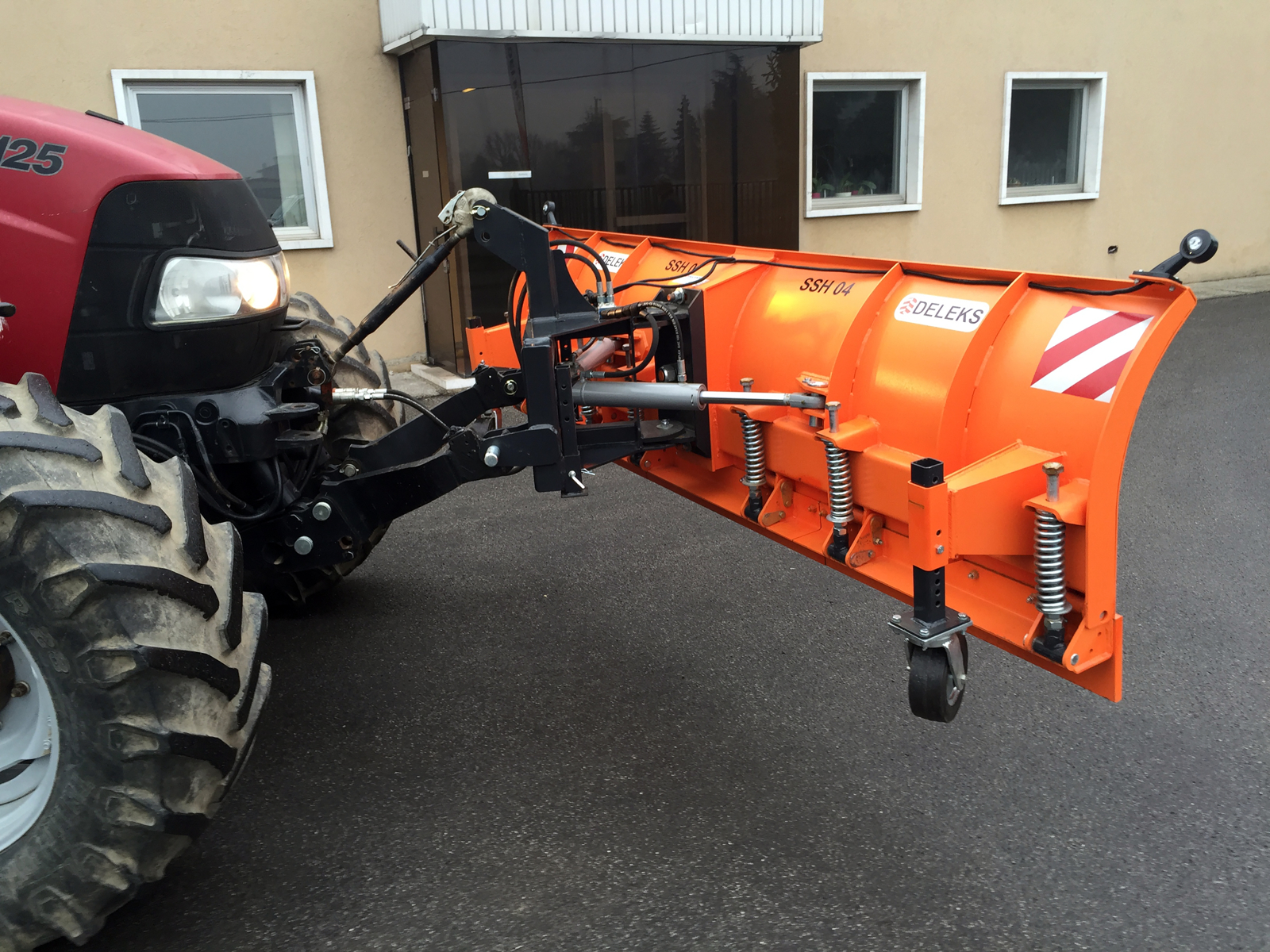

This almost the default way to do it, for heavy duty, fast plowing it often a subframe that is attached all the way to the back of the tractor, but many uses the front three point.

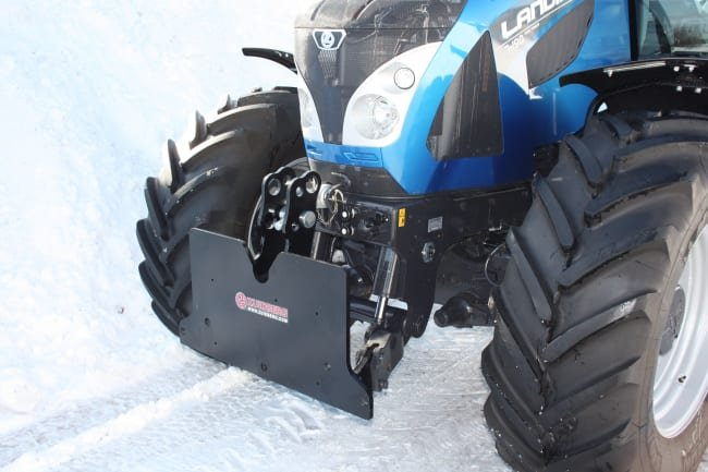

Just for those that is interested in the topic, this is the default connection we use on plows and snow blades, used on tractors and trucks.

Are you planning on some kind snow flap keeping snow from drifting over top of blade?

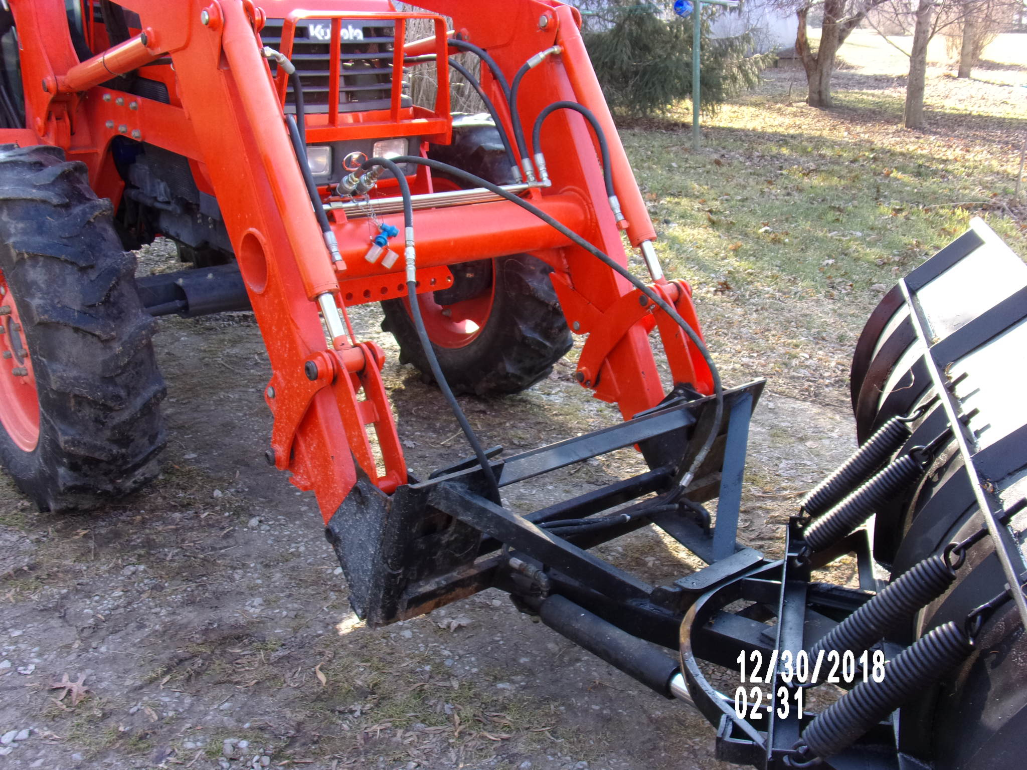

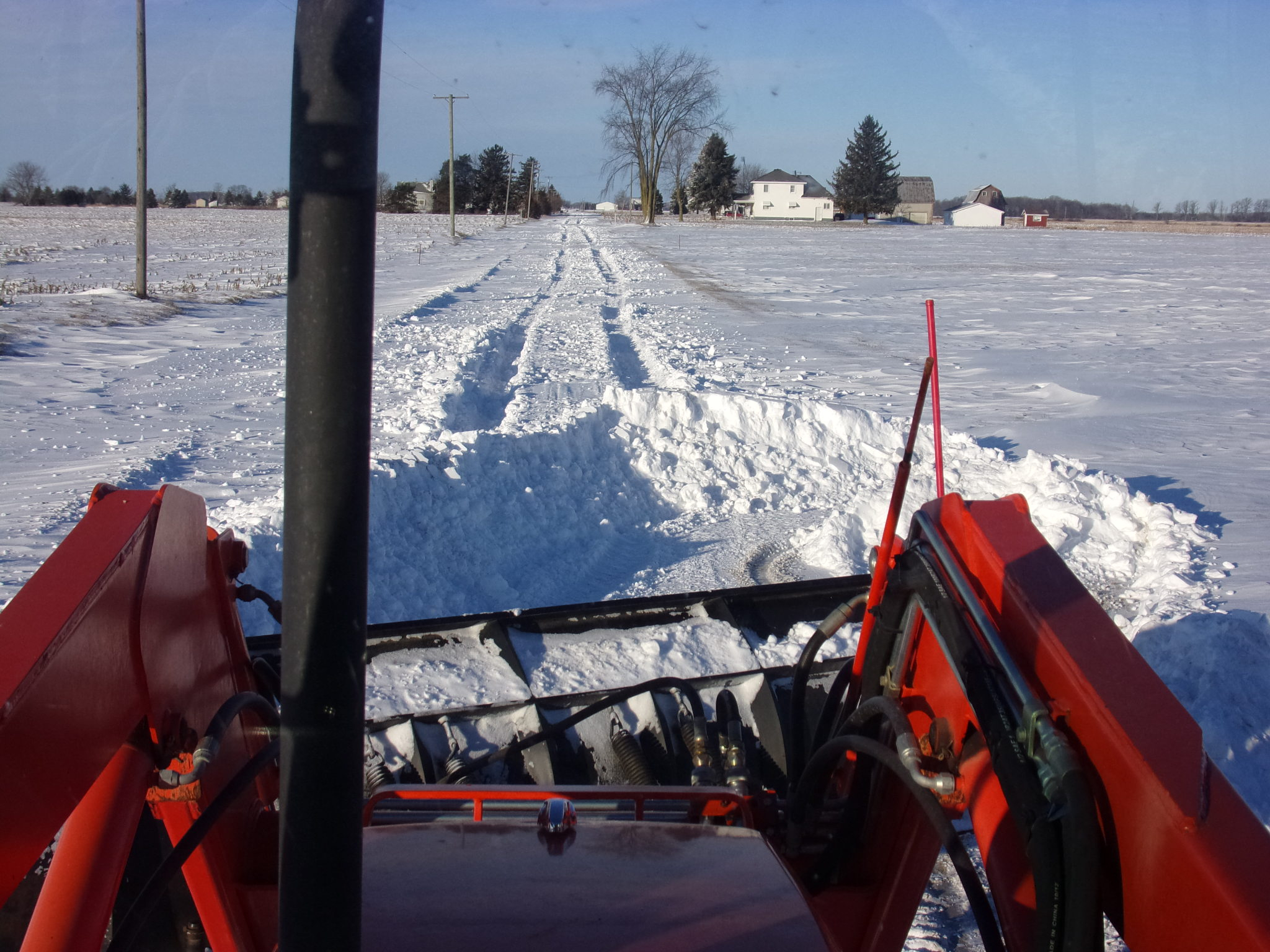

My frame mount.
I'd be very happy to have a front 3pt. I had to fabricate the frame mounting for the push bar (the "normal" pickup mounting)
With the plow up tight to the tractor, steering is not a problem with heavy snow and makes for a much shorter rig but I'm doing driveways.

I want to mount it on a front 3 point hitch, not a subframe. Haven’t found anything ‘Murrican made. Looks like it’s a European made item.
