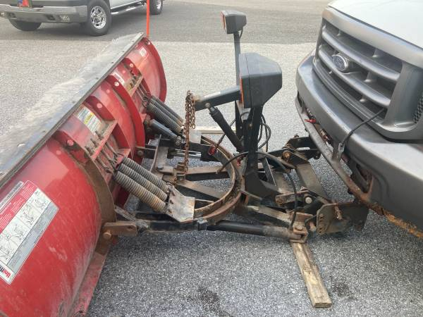

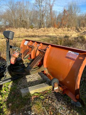

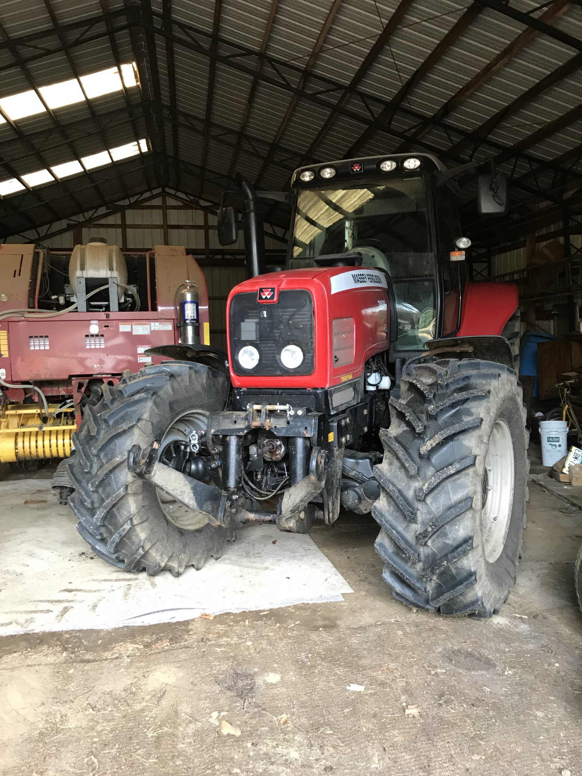

Not having any luck finding larger 9-10’ trip edge plows.
I have found (2) different Western Heavyweight plows. They are fairly priced, but they are moldboard trip.
I think for what I am doing they would be serviceable (development roads).
One is 9’ for $1,000
Other is 10’ for $500. Paint pretty faded, frame is rust haze.
Both have good cutting edges. 10’ has wheels, which I kind of like.
Im leaning towards the 10’ because it’s bigger and closer distance (80 miles). The other is 150 miles, but a little prettier. It’s also 1/2 the cost.
I don’t think the 9’ angled, will cover my tracks
   / Truck snowplow on tractor front 3 point #52
For $500 if you get a year out of it you'll still be way ahead. 👍
The added width (10') I would think of as a minimum especially for your tractor and plowing developments.
This would get you in business pretty cheaply and if you decide it's not for you or help any future plow upgrade decisions.
I'd dream up a mounting for your front 3pt. that would work with any truck plow. This would always have value to someone else if you jump out.

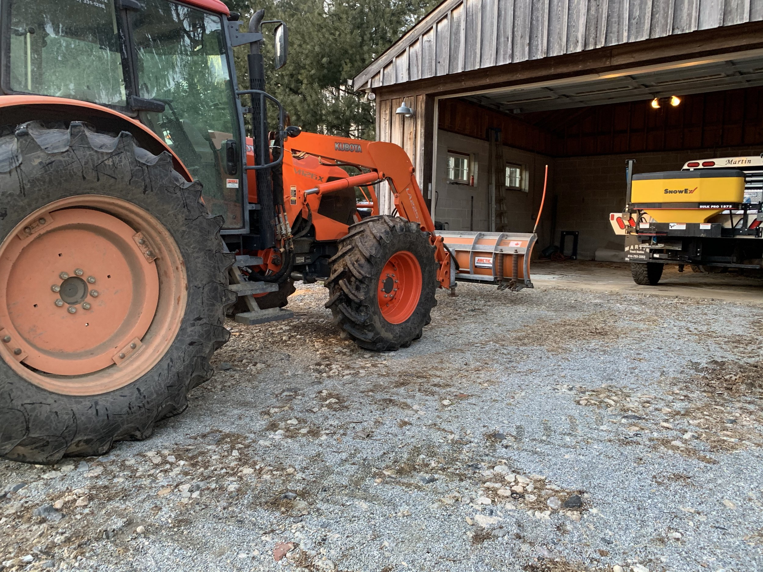

I already have a SSQA plow with a trip edge for my Kubotas. It can be adapted to a 3 point, but its a little small for a 200HP Massey.
I‘m already in the plowing business 30 years. I was given a possible opportunity to be the “road man” in a large development as a sub for a large landscaper.
Currently doing farm driveways and a few residential driveways with my Kubota and Arctic plow set up.
The Massey/Western Heavyweight set up could also be a backup for the Kubota.

I think a simple triangular or inverted T would be simple enough to build, catching your 2 lower pins and top link. The bottom obviously being where the push plate that accepts the 2 "ears" on the plow.
Were you thinking of a rigid setup - raising the plow with the 3pt?

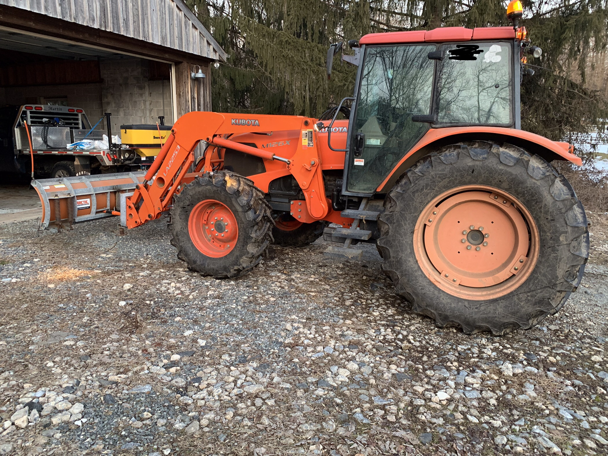

Got asked if I want to clear main roads in a development.
Anyone have a typical truck snowplow adapted to a tractor with a front 3 point?
I already have a plow attached to a loader on a tractor.
This would be farm tractor with front 3 point below.
Have hydraulics up front for power angling.
Thought a Western Heavyweight 9-10’ would be perfect
already have this Kubota with loader
and snowplow
This would be real expensive, but would be amazing to plow with.

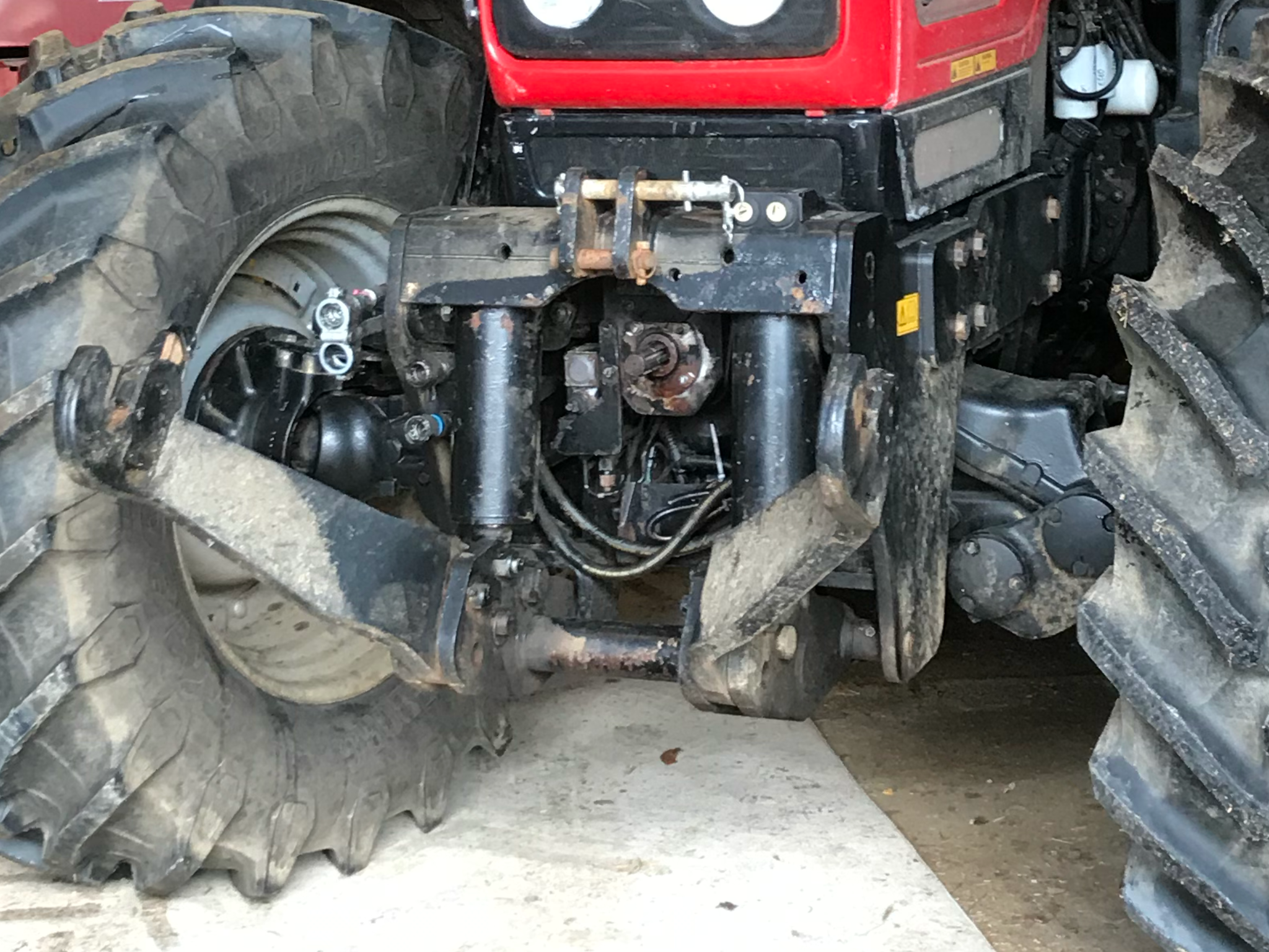

Cant help but think you would be better off removing the lift arms and dabbing up a “mount” to make the plow like the 3rd pic. Even though the lift arms are substantial, I got a bad feeling they wil end up pretzel shaped.
#56
Assume you mean the lower lift arms on my front 3 point?
Not worried about them. They already handle a very heavy 11’ front hay mower easily. Much heavier built than the ones in the 3rd pic. I think they’re 1&1/4” thick.

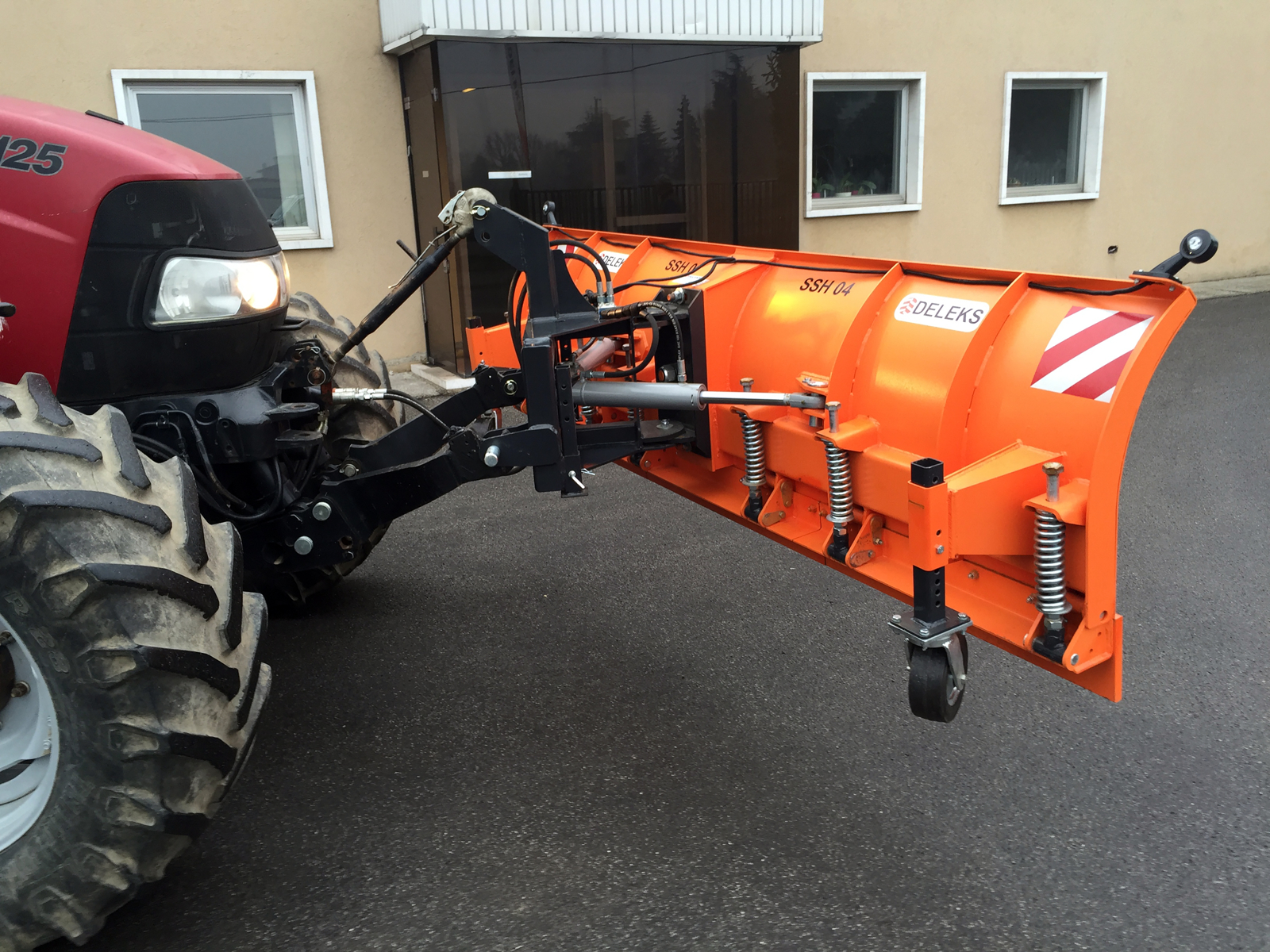

I do like the trip edge on the Deleks plows
