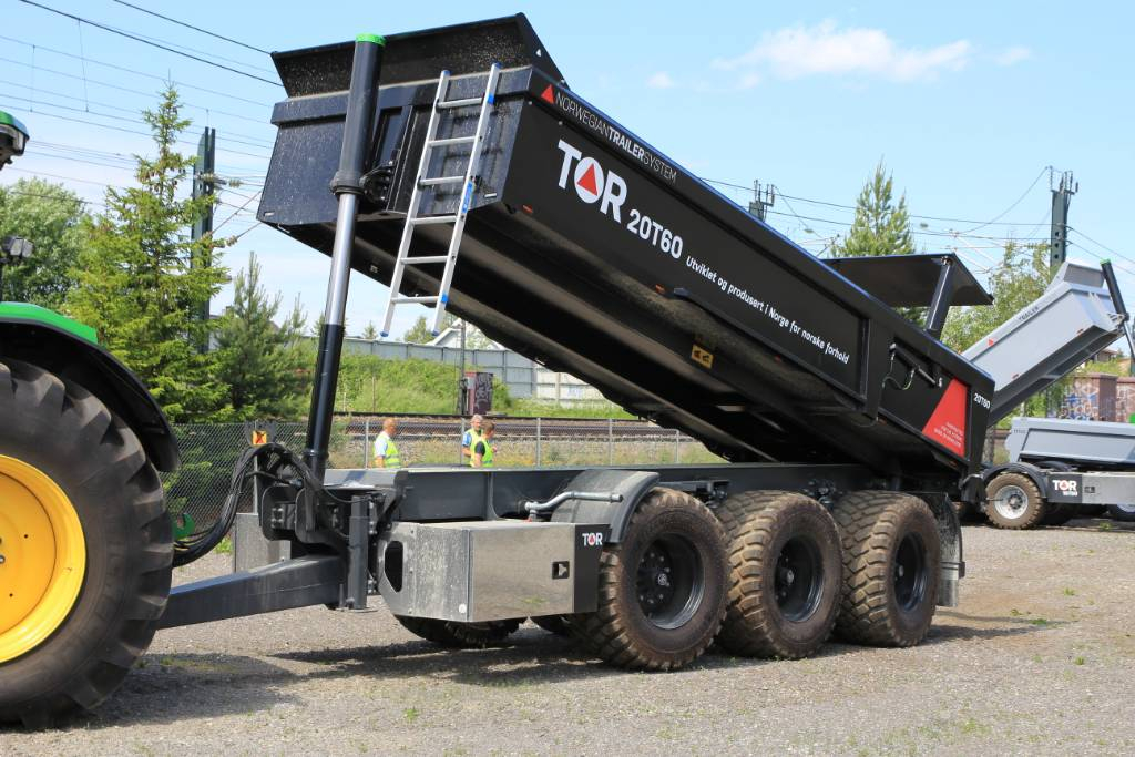

A small and nice 50km/h trailer, 20T pay load.View attachment 726852
Very nice dump trailer.
My Krone 4x4xc has a steerable axle and brakes.

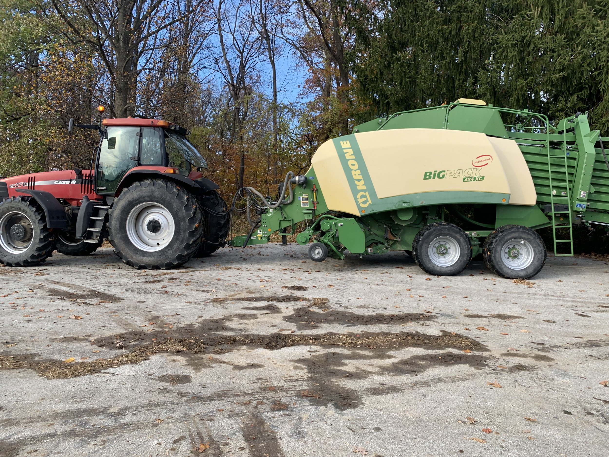

I've seen a number of YouTube vids of tractors plowing snow in Europe. Considering how fast they're moving, they must have a pretty tall road gear
I do know that some brands/models do have a 'road gear' option, generally in the higher HP range models.
Local friend does rural private plowing and all his Kubotas are highway geared.
   / Truck snowplow on tractor front 3 point #66
I expect most full sized utility tractors have a road gear...30-35 MPH, so they can travel reasonably fast between fields
CUTs, not so much...I think my 4052R tops out at 18 MPH (depends on the tire type and size)

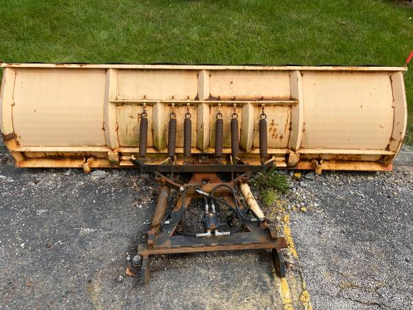

Found this 10’ Meyer plow and it’s local, but he wants $975. Looks kinda rough.
Might go have a look today. Never was a big Meyer fan, but seller says it does have a good cutting edge and a snow foil.
   / Truck snowplow on tractor front 3 point #70
For those that have and those that are considering a truck plow on a tractor....dont forget a crossover relief to protect the hoses and pair of SA cylinders.
Truck plows seem to be cheap. And all the big players like Boss, Western, Meyer, Fisher, etc, etc are always re-inventing their mounting and thinking they have the next best thing. Landscaper/plowers are always upgrading their equipment. End result is you can usually find plows (blade only) pretty cheap. So if you are handy putting a truck plow on a tractor can be done pretty inexpensively.
