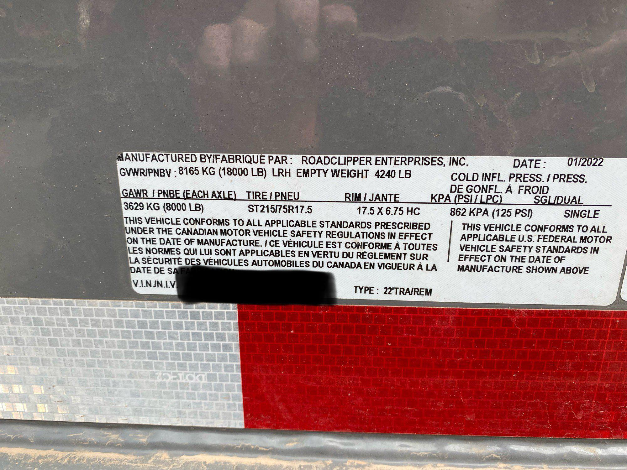

Don’t quote me on this but someone posted their trailers sticker a while back. Say it had two 7000 pound axles, but the gross weight was something like 15,500 pounds, assuming 1500 pounds of tongue weight isn’t on the axles.
   / Truck & Trailer ideas to tow 14,000 and be under 26,000 pounds #157
Like this
   / Truck & Trailer ideas to tow 14,000 and be under 26,000 pounds #159
Totally understandable.
My Kaufman has (2) 16,000lb axles, but is rated for 38,400lbs.
They take the 2) 16K axles, which adds up to 32,000lbs and add 20% tongue weight (6,400lbs) and total it at 38,400lbs.
You just need a truck with a rear axle capable of 6,400lb rear axle weigh (plus the ambient weight already there)
   / Truck & Trailer ideas to tow 14,000 and be under 26,000 pounds #160
20% tongue is a lot. And 6400 is really a lot. I only get 12.5% added to GVWR on my Barbie trailer :ROFLMAO:
