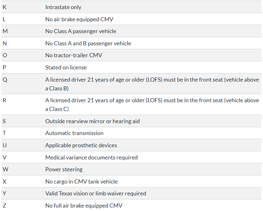

Here is how the federal regs define the restriction if you take the test in a non-fifth wheel combination.
Tractor-trailer. If an applicant performs the skills test in a combination vehicle for a Group A CDL with the power unit and towed unit connected with a pintle hook or other non-fifth wheel connection, the State must indicate on the CDL, if issued, that the person is restricted from operating a tractor-trailer combination connected by a fifth wheel that requires a Group A CDL.
In Texas it is a restriction "O".
   / Truck & Trailer ideas to tow 14,000 and be under 26,000 pounds #214
The training is all the same. Regardless of what class a restrictions you get. The restrictions are simply based on what vehicle you take the test in. Therefore the training organization said spend the few hundred bucks to use their truck so you have no restrictions. Since you are “trained” on it all. It is called edlt training and covers everything. But you can still take the test in your own pickup if you want. But after spending the time and money it is silly to get the restrictions.

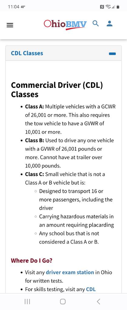

I just pulled this from the Ohio BMV. So does this mean there's no need for a cdl in Ohio with a 3/4 ton? I borrow a friend of mines tandem dual gooseneck (18,000 gvw?) with my 2018 Ram 2500 who's gvw is 10,000 lbs?
   / Truck & Trailer ideas to tow 14,000 and be under 26,000 pounds #219
I just pulled this from the Ohio BMV. So does this mean there's no need for a cdl in Ohio with a 3/4 ton? I borrow a friend of mines tandem dual gooseneck (18,000 gvw?) with my 2018 Ram 2500 who's gvw is 10,000 lbs?View attachment 778935
if the tow vehicle GVWR is 10k or less then no. 3/4 ton truck usually stay at 10k or below. But you never know what the manufacturer is going to do to sell more trucks.
