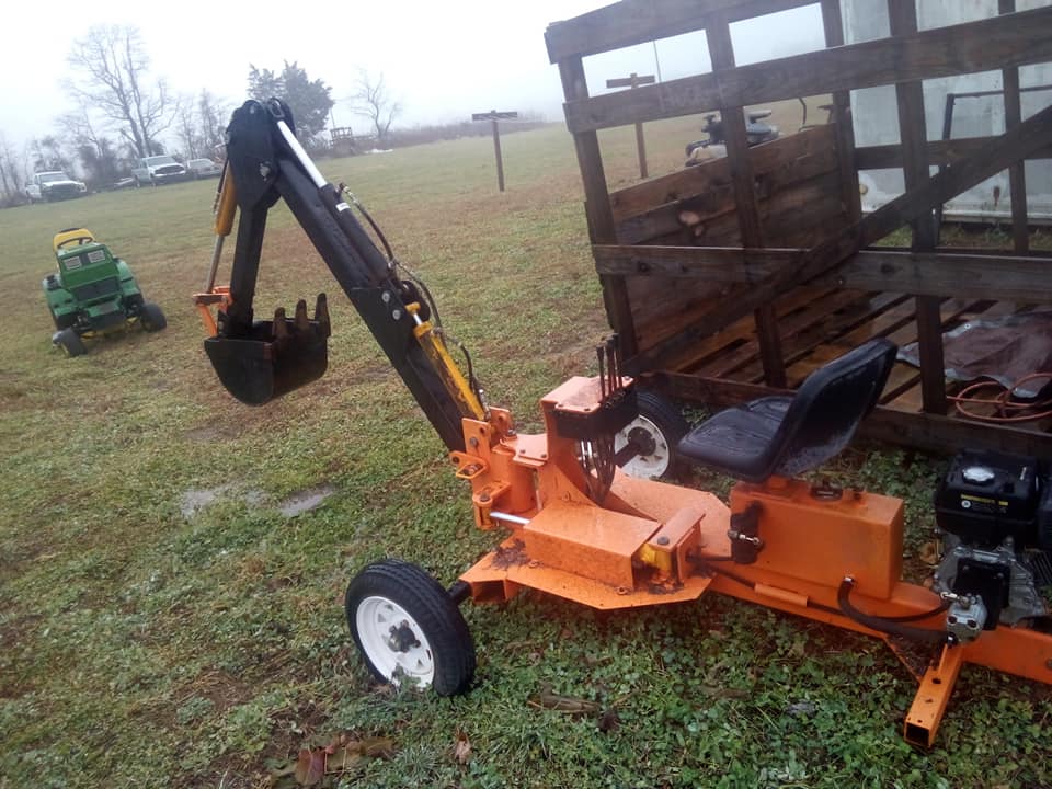

I have an old backhoe boom that I was considering turning into a crane. It wouldn’t have needed a turn table. I think the backhoe would have had enough movement to work.

4570Man I too had considered using a backhoe boom to make a trailer mounted crane. I致e been thinking about building some type of crane for years. I was always hesitant due to how darn heavy it would be though. Other than that and having a limited reach given the weight, I can稚 see why it wouldn稚 work.
