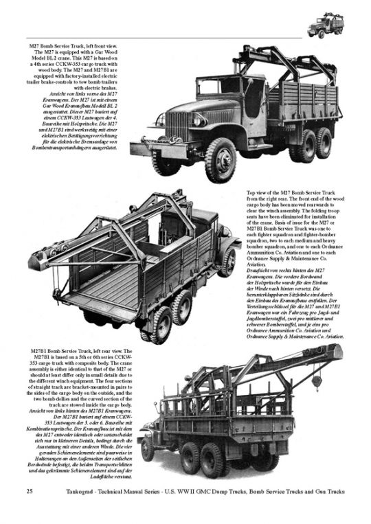

Before cranes suitable for trucks were available, I used to see variations of this system on trucks.
The only photos I found were military.
Bruce
   / Truck / trailer mounted crane #12
Bruce
I’ve seen those for setting septic tanks but not for much else.

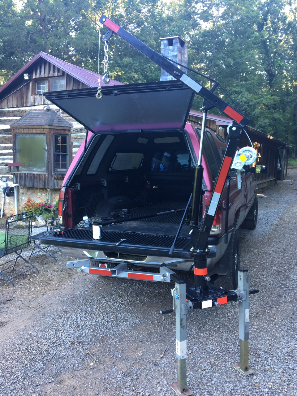

   / Truck / trailer mounted crane #16

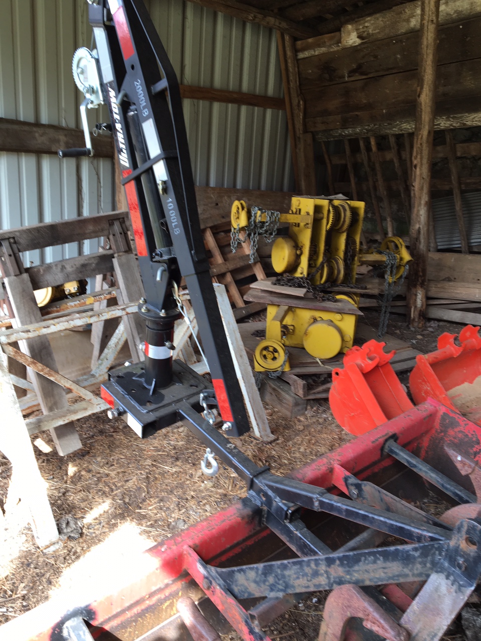

Modified the base of this 2 ton truck crane to work in hitch receivers and allow extra jacks to support/level. Made it where I can easily break it down into three pieces to move. Can load anvils in back of truck or lift heavy stuff onto benches in shop. It came with a nice roller thrust bearing in the base for rotation and jam bolt to lock.
Remember cranes are made for lifting straight up......not side loads.
