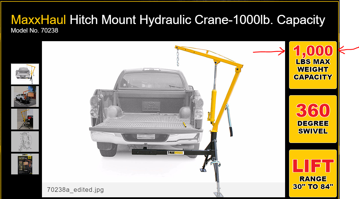

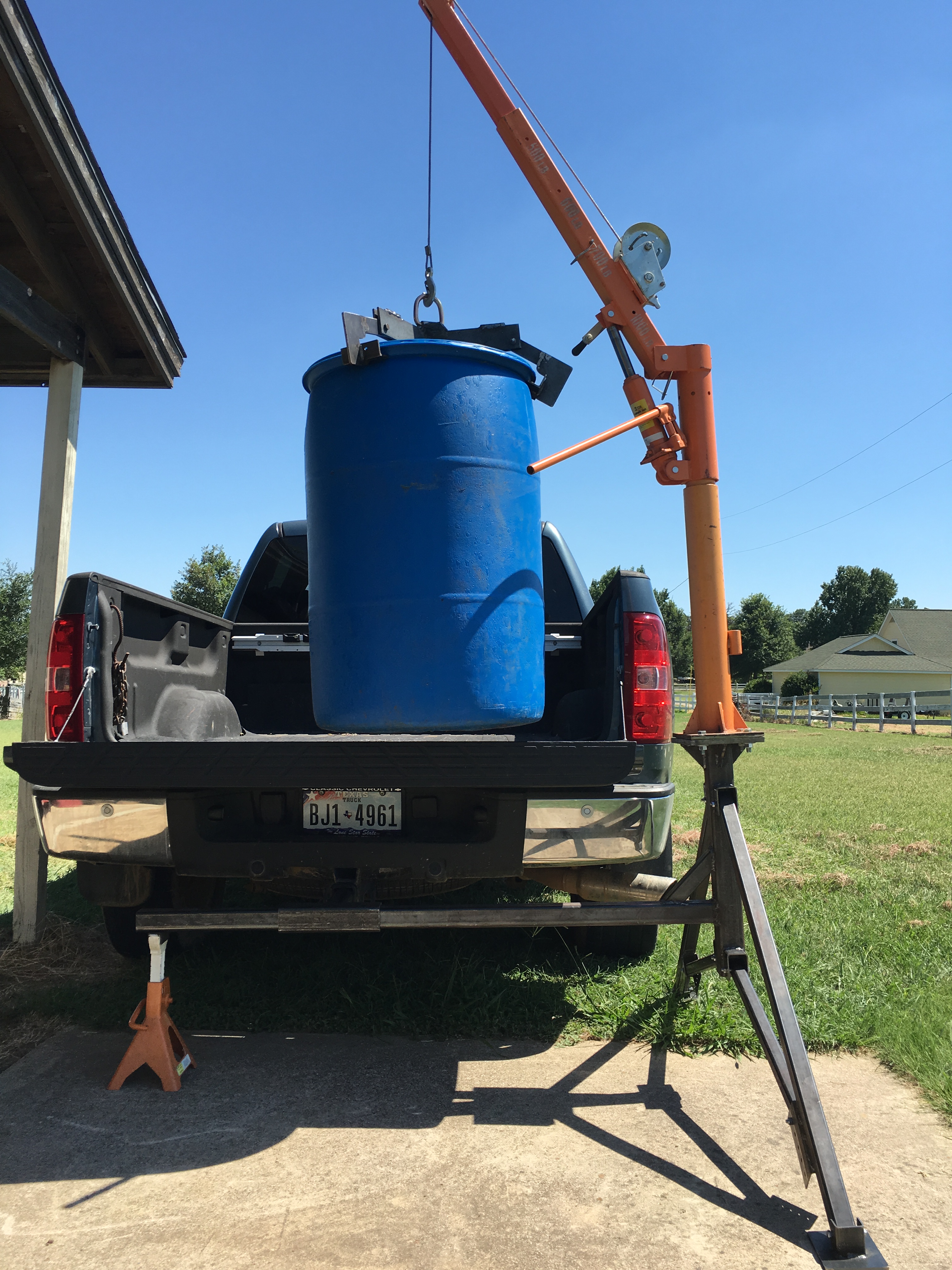

Anyone have that Maxxhaul hitch crane? Will it lift a 55 gallon drum?
   / Truck / trailer mounted crane #30
This is a do it yourself copy of the retail version, has no problem with a 55 gallon drum full of water.
