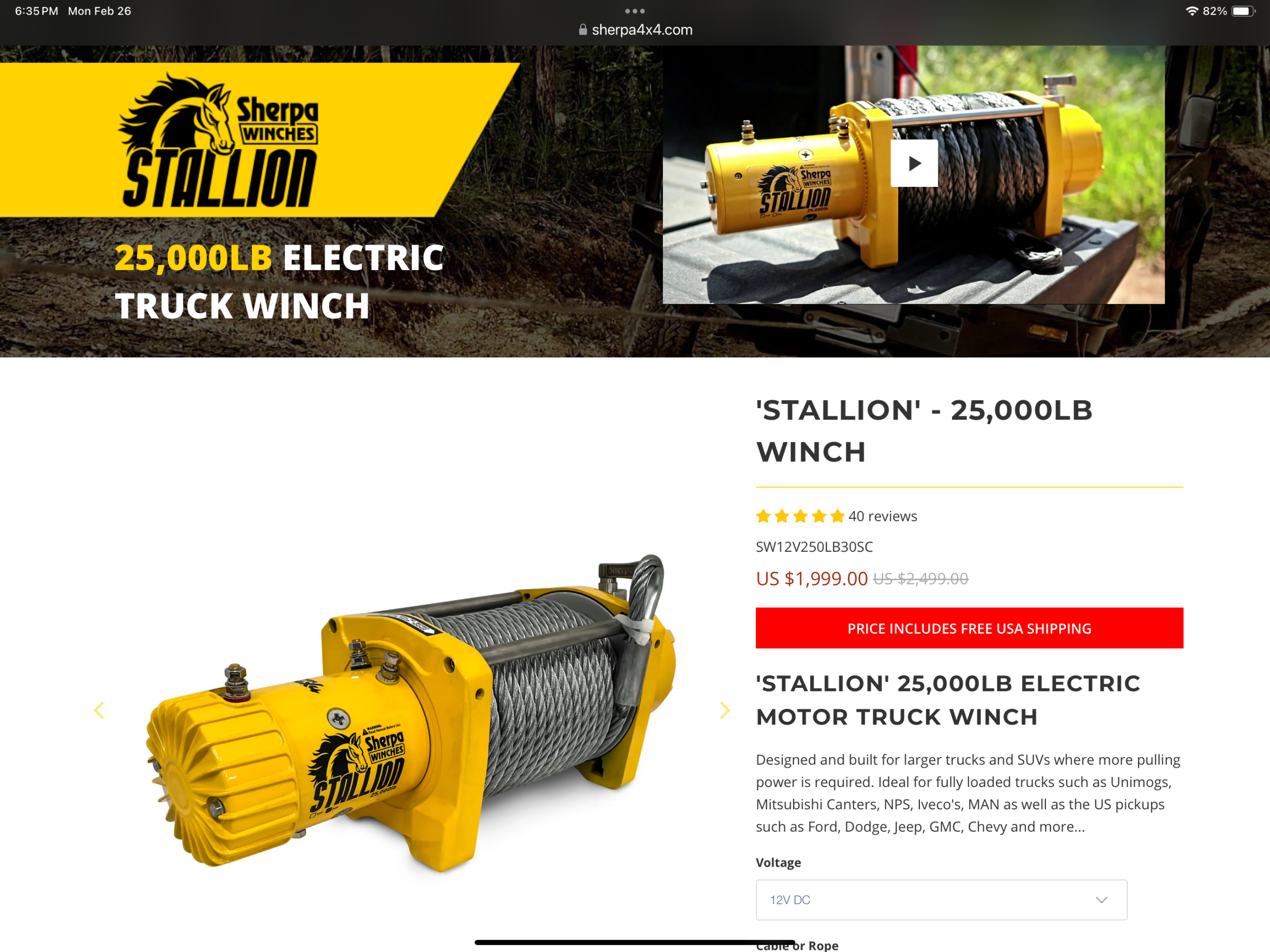

I was all set to buy a Ramsey 15K used off some dude on FBM.
Then I scrapped that idea and went with a new Sherpa Stallion 25K.
Went with the 31K rated rope instead of the cable to save weight & make respooling easier.

I actually got sick of comparing & searching. There were chances to buy Ramseys, but they were 15K LBS and everyone has told me to try to buy a wich with at least 50% more pulling strength than truck weight.
My truck weighs 11,000lbs with typical tool weight, so I needed at least a 17K winch.
I found a few, but they were used with asking prices of ~$1,500.
I haven’t read hardly any negative reviews on the Sherpas, so I went with it based on reviews, 25,000lb pull strength and a reasonable price.
