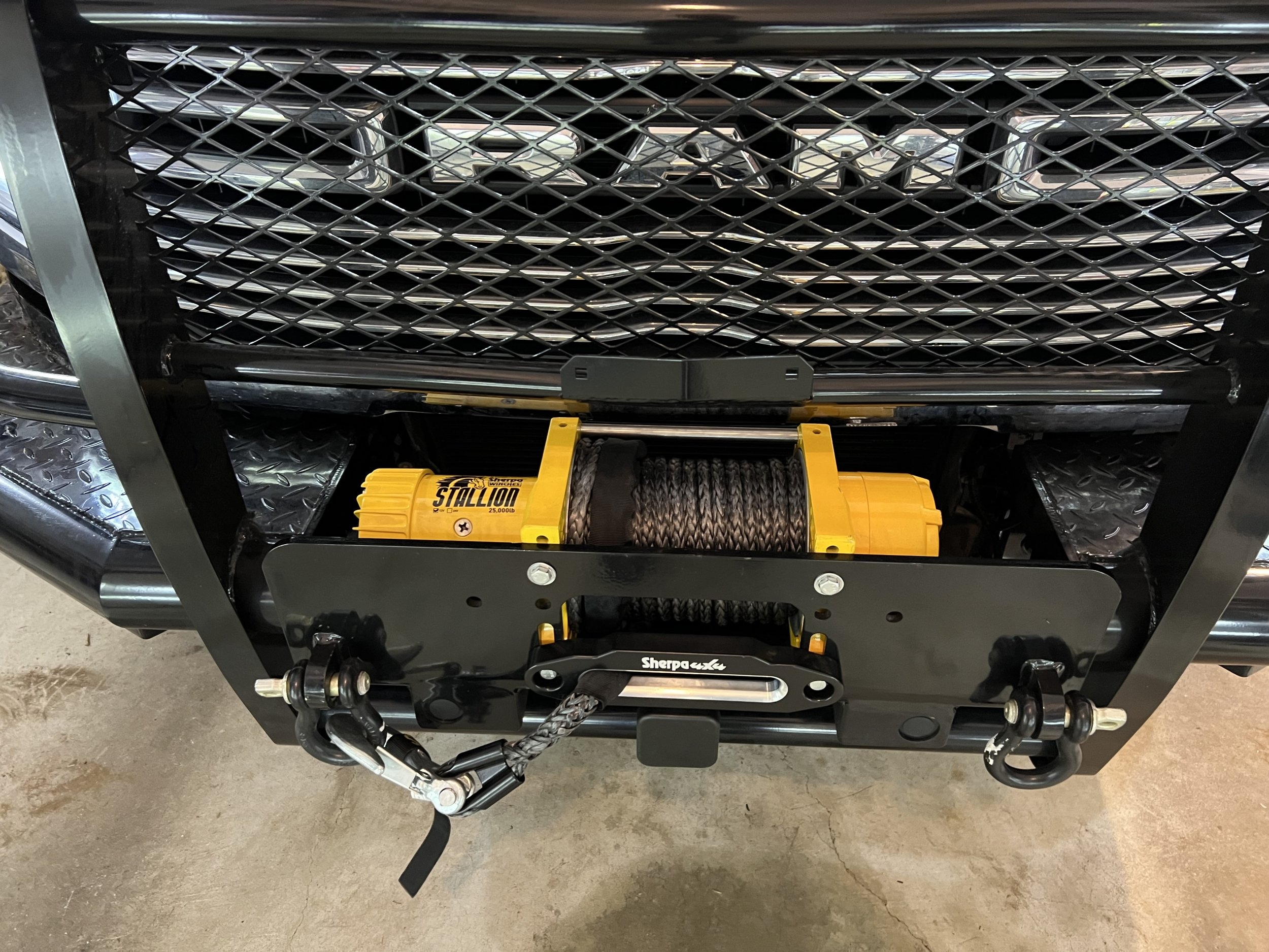

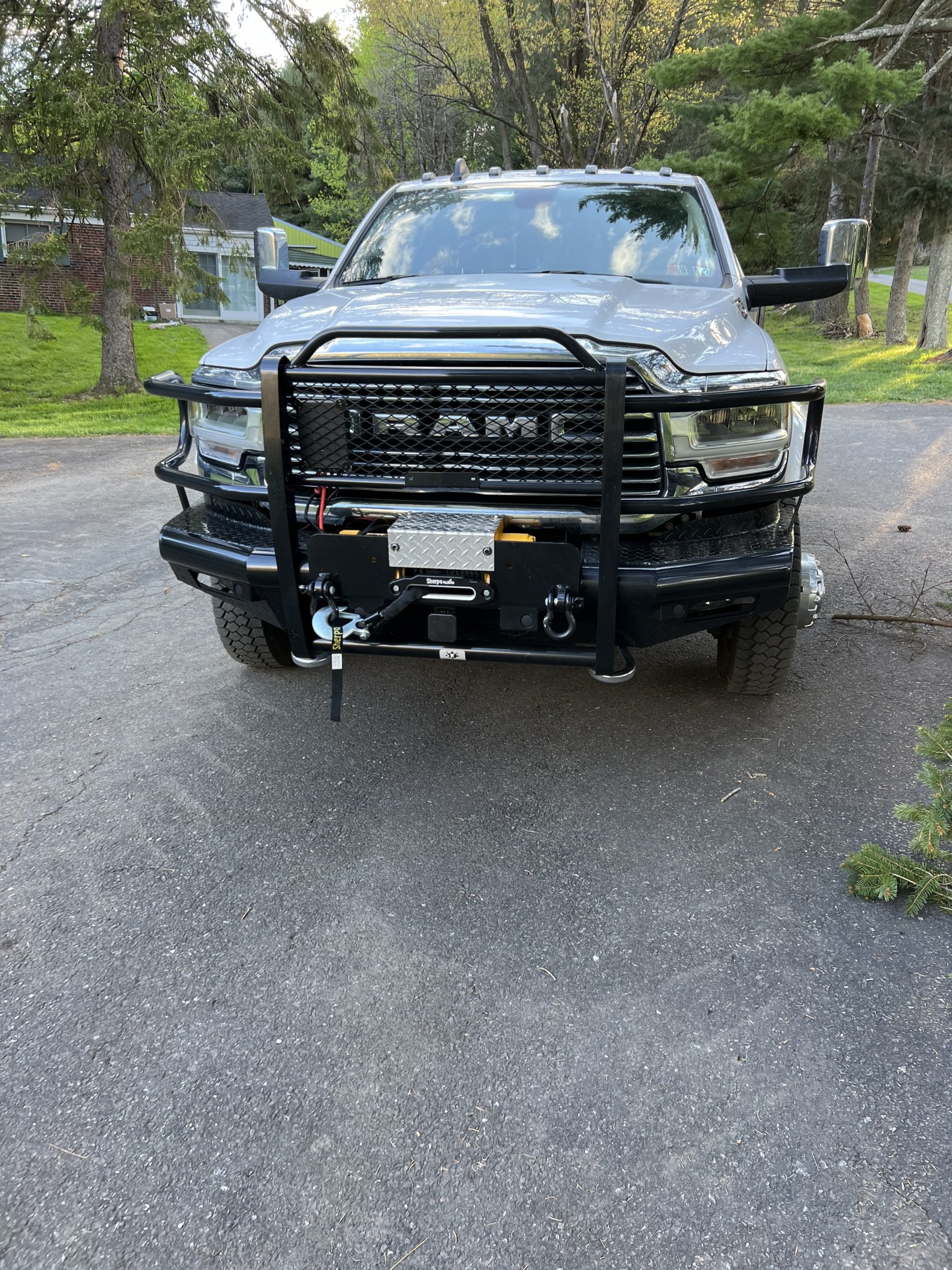

That's a lot cheaper than what I spent on my warm zeon 10k.
450+ amp draw is huge though.
