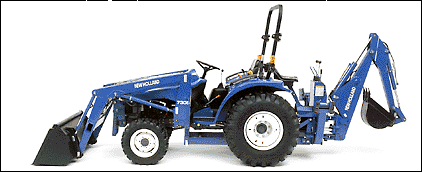

My New Holland TC18 won't run with no one in the driver's seat unless the parking brake is set (safety interlocks). The hoe has it's own seat, not like your TLB (I've used a Cat 416C, so I know how they work, and it's great). I'd have to set the brake, climb down, climb up into the hoe seat, put down the stabilizers, trench for a few feet until the tractor needed to be moved, lift the stabilizers, climb down, climb up into the tractor seat, release the brake, move the tractor, then repeat the entire sequence every time the tractor has to move a little. The tractor is small, so the hoe would be small, so it would have to be moved fairly often....attached is a picture of a typical setup; you can see the small, rearward facing hoe seat.
It's not so bad for digging out a stump or digging a hole to plant a tree, but I sure wouldn't want to do it for long when diging a long trench....
