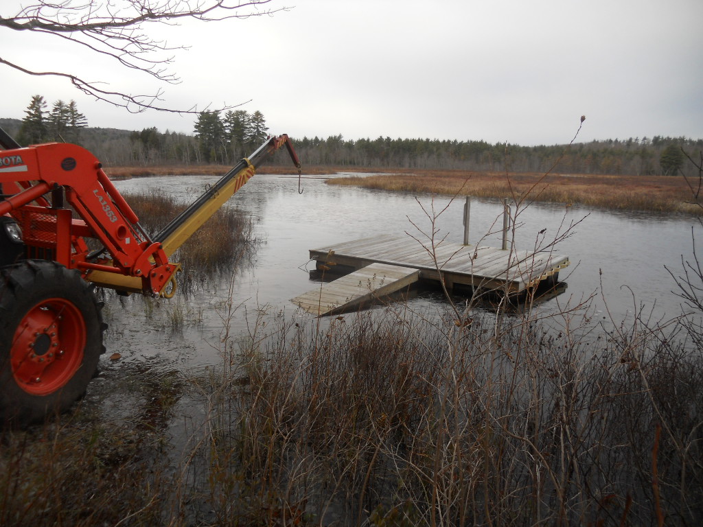

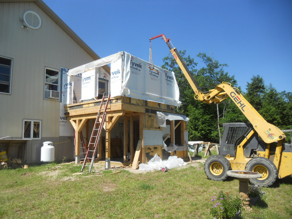

Welcome to TBN Dean, I built a little bigger version of what your describing. A few pics for idea's.

I just put it together with what I had laying around. 4570Man pretty much nailed the details. The outer tube is 6x6 - 1/4" wall and the inside extension is 4x4 with a heavy 3/8" wall. The cylinder was from a guy that "scrapped" out stuff from Grove Crane, he had the best junkyard I've ever seen. It was alway's a several hour visit walking around his place and "hmm, what could I build outta that?" IIRC I gave him about $100 for 2 of those cylinders! Still have one kicking around.
