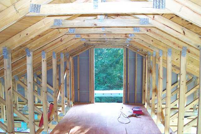

I had the truss guys engineer an open center truss. This gave me 12x45 ft open area with plenty of room to walk around side to side. Load bearing enough for almost anything I would want to store there. Also, the floor is 3/4" "screwed and glued" to the bottom member. I also did the outside storage roof this way and gained 9x20 ft. This also stiffen the building and added to the Hurricane strenghtening!

i wont be putting in a ceiling, only hanging the garage door stuff, wich is a big 16 footer..wonder how much more the open center trusses are than the regular ones? I like the way yours is, thats cool!
   / Truss for pole building question.. #58
The cost difference will never outweigh the convenience of the additional storage space. You are only building this once, so you better make it the way you want it in the first place. A building is like a marriage..... if you mess up it costs you a lot before you get it straightened out....... build it right / marry the right person.... you will have a smile on your face for life.... /forums/images/graemlins/smile.gif Junkman the Philosopher.... /forums/images/graemlins/smile.gif /forums/images/graemlins/frown.gif
