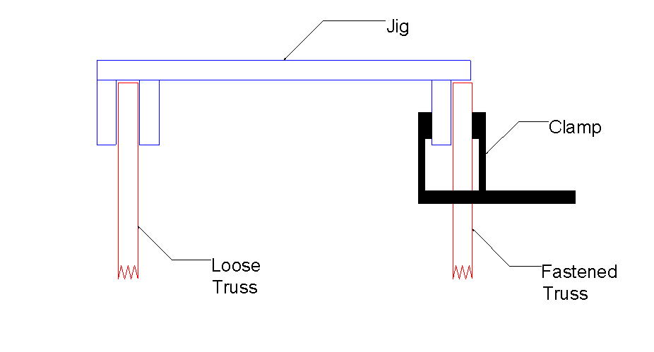

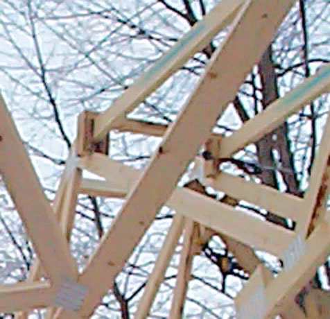

I put up at least 75 percent of my trusses by myself (and my tractor). The attached picture shows the jig that I made up to use to brace the loose truss to the previousely fastened truss. In my next reply I will attach a drawing that I made to give you a better idea of what I am talking about.
   / Truss for pole building question.. #76
As you can see that picture is not too clear so I made up a drawing and attached it to this post. First off let me say that this may not be the safest way to accomplish the task. Please don't use my method if you feel it is unsafe. I started out by wrapping a strap around the loose truss and pulling it toward the fixed truss. I would pull it until it was almost upright and then I clamped the strap to the fixed truss. It is important not to pull it too far towards you because if you pull it until it is straight up and down it could fall towards you. Then I took my jig and I placed it over top of the loose truss. Then I would pull my jig and the loose truss back towards the fixed truss. I would then clamp the jig to the fixed truss.
Edit starts here:
I should mention that I had my trusses on 24" centers. I made my jig for that exact spacing.

One way I have done it by myself with 28 foot 4 in 12 trusses.
Lift all the trusses onto the walls and let them hang upside down.
Put up a vertical brace for one end truss.
Rotate the next truss to a vertical position.
Nail a 2x4 or some such across the two trusses as high as you can reach from the wall. This will hold them vertically.
Rotate next truss and nail another long board accross the three trusses and extending well past them.
Keep rotating trusses and nailing them to the board. Will have to use more than one board.
When all trusses are up Make sure the first one is set square and verical. Then go down the line doing the same for the other trusses. When all are aligned check again for squareness. One can use a sheet or two plywood as a big square when starting out
Now you can install the interior bracing for the trusses.
And then its time for the roofing. And then I find that after all my checking things are just enough out of square to make blue air.
Egon
