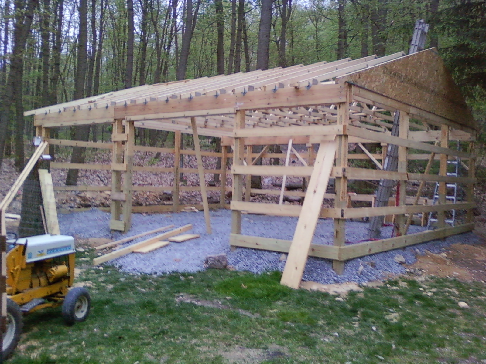

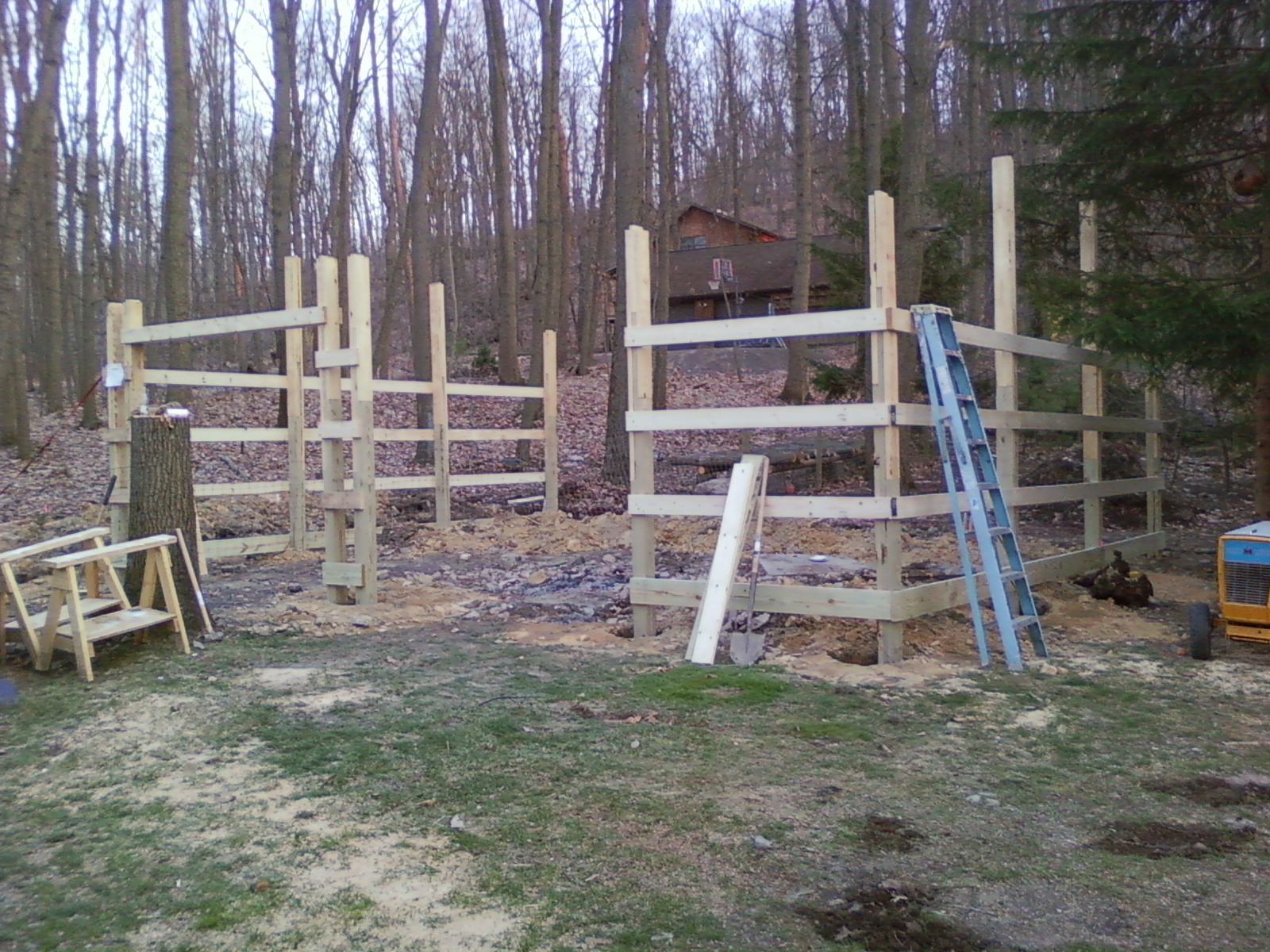

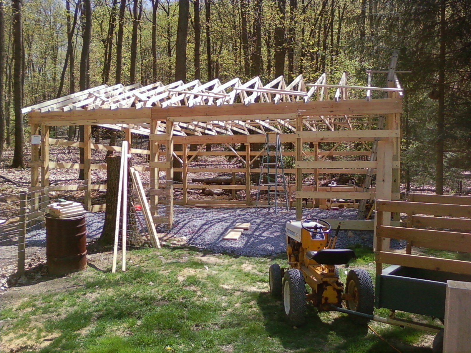

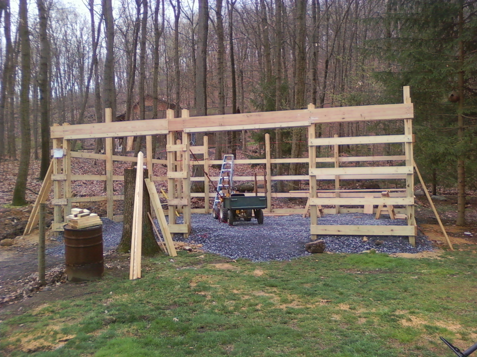

I am still waiting on the official paperwork for the trusses so I thought I would post a couple pics of the progress so far.

Looks good, very sturdy
How come your not putting a metal roof on it?

I am not putting a metal roof on because I want it to match my house and other outbuilding. In hindsight I probably should have used metal roofing to qualify for the tax credits. It will get dimensional shingles and 4" clapboard siding. Picturing it in my head it looks very nice but I will have to wait and see what reality is. Got very concerned yesterday morning when leaving for work I noticed a very visible bow on the gable end truss. After worrying about it all day I came home and pulled a string only to find out one pole is just 1/2" off 9' up. Amazing how bad 1/2" out of plane can look to the builder/owner and probably no one else. thanks for the sturdy comment Duffster...That was my main goal...I do not want to worry about this building come any foul weather. I put 45* bracing on the long walls and will probably put some on the gable walls as well. Although I think sheathing alone will brace it enough. With all the surrounding trees there is not much ground level wind here.
Anyhow I will post more pics in a couple days when the roof should be done.
