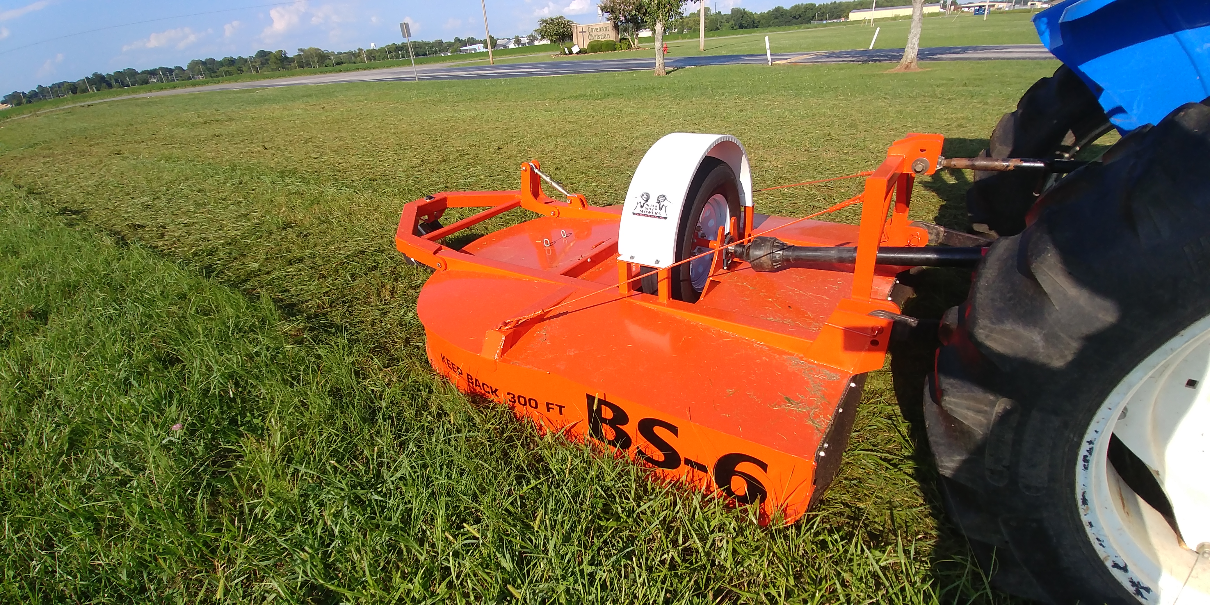

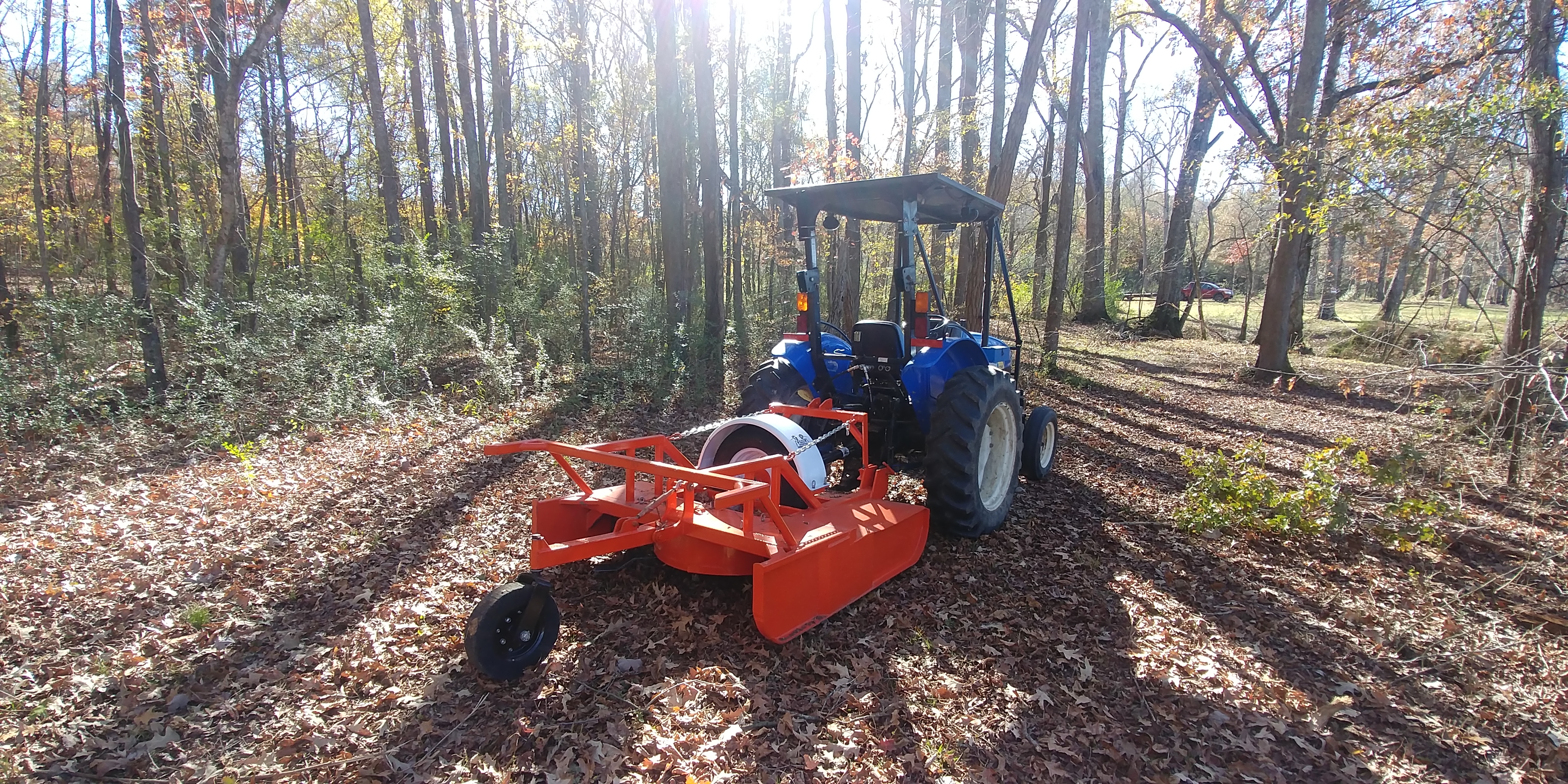

1513225546984.jpg If you're serious about brush cutting. Get a Black Sheep Mowers! 😀
   / Trying to decide on brush cutter. #12
First tire drive mower I've seen in years. I didn't know any were still made.
