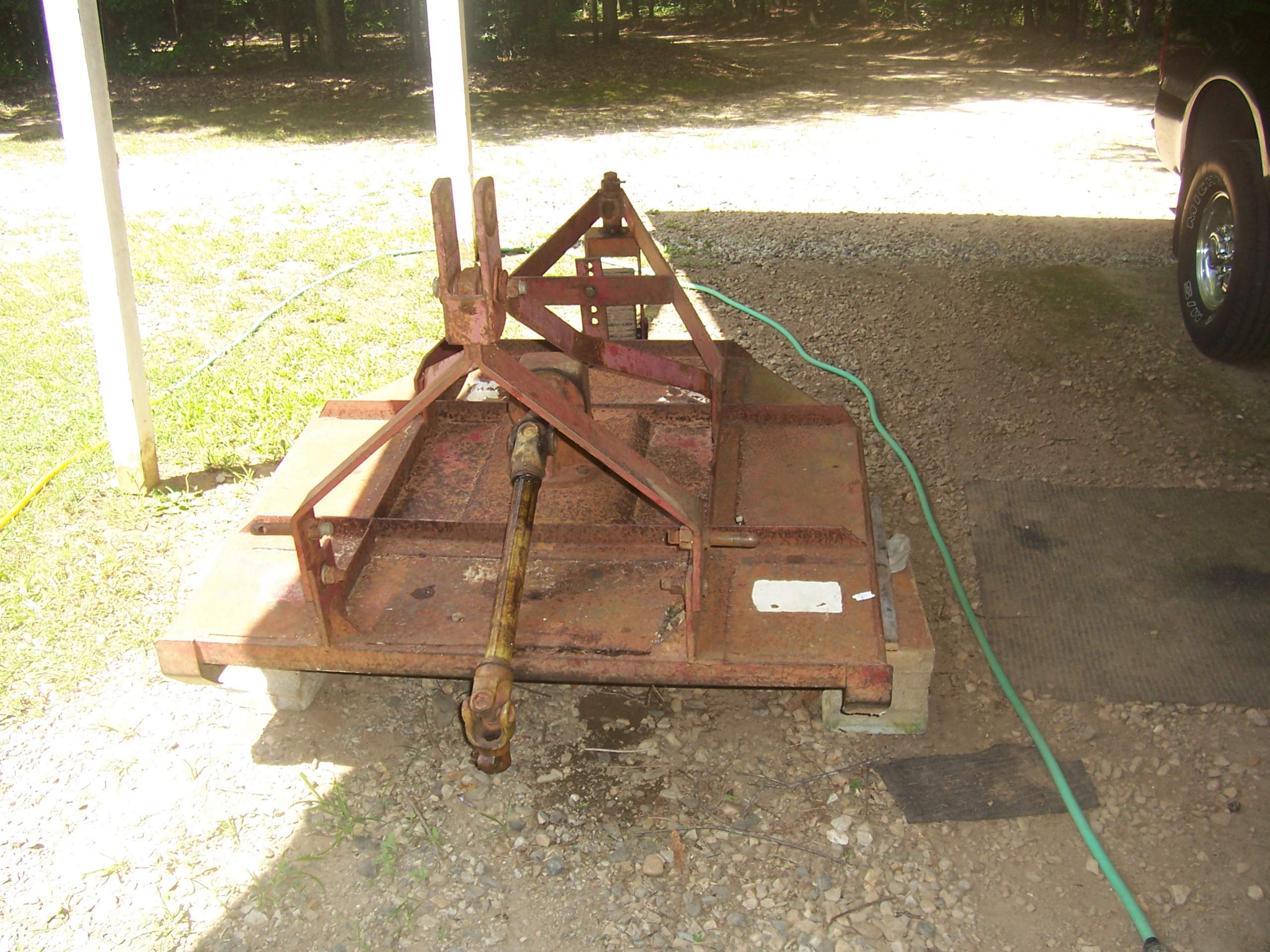

I also have a 24Hp. Ym2000 the same as the 240. I use a 4Ft. BH. and a 5ft. FM.. The 2000 handles them both on my property easily. I mostly use the Rear Discharge Fm. but have 8 acres of wooded area I use a BH.. It's a old International I believe that's built like a Tank! And have no problems using it. My Woods Manufactured JD. Fm. I never Run my Eng. much over 2000rpms.. Now that I have my 2nd. gear on he PTO. working I only run about 1400-1500 Eng. Rpms.. It fits great behind the 2000!!! I mow at least 2.5 acres with it weekly and use maybe 1.5 gal of Diesel a month. :)
Here's a pick of the BH. since I had it out.
