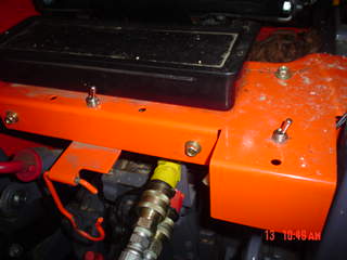

I took my BH off for the first time a few days ago to tryout my PHD. Now I tried to connect the hydraulic lines from the BH to the tractor and I am unable to get them connected. I slide the retaining ring back to put the line in but I can't get it to go far enough to lock. So far I tried it with tractor on and off, made sure all hydro stuff was resting, and tried moving the AB lever in different positions.

You may have developed pressure in lines, was it out in sun or hot weather? Take a rag and a small drift pin to push in on center ball to relieve pressure, make sure you use rag so Hyd fluid does not hit you or eyes, then retry connectors, good luck but that should do it.

I have had the same problem. I have used a hammer, again make sure you put a rag over the end as suggested by devildog1, and give the end of the hose fitting a tap with the hammer. You are trying to relive pressure that may be present. I also put colour tape on both hose and tractor fittings so you don't have to try and guess which hose goes where. Good luck in getting the fitting to work. :)

It's not a stupid question. I remember asking the same thing on here. The method I use is a pair of channel locks and rag. I've removed and mounted my BH 20+ times leaving it sit in various ways and 90% of the time, it's gonna have pressure on the lines. Good luck.

It seems to be fairly common to have trouble getting the hoses back on due to pressure build up. Until you can relive the pressure it's almost impossible to get them back on. Just saying :)

After putting a rag over the end of the hose coupler I TAP the end. I may have to do it a few times. There is what looks like a slightly raised ball in the middle of the end, all you need to do it have it go a bit down and the hydraulic fluid under pressure will squirt out, it only takes a little bit to be successful. I am not banging or whaling away at it and having the rag over the end you are not damaging it. Most of the time I don't have to do this as I do like you, move the different backhoe cylinders to relive the pressure. :)

I had used the hammer and rag method the first time I had these problem and it worked pretty good.. It was a tad harder to connect then I thought it should have been but I got it on ok. Well I used the PHD again and when I went to put the BH back on no amount of hammering would work. I remembered someone mentioned channel locks, so I gave that a try. Piece of cake. It only need slight pressure on the pliers to get the hose pressure down. Then connection was easy.
