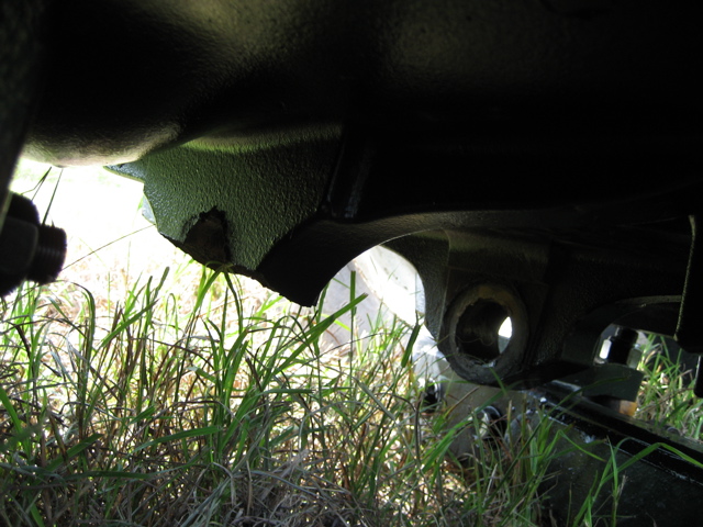

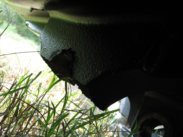

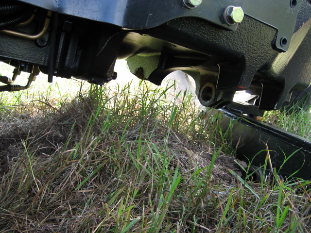

finally got some pictures.

Wow! That almost looks like the type of damage that might happen from dropping the tractor while unloading it or running into something. It makes me wonder if the damage was done as the pin came out or if the pin came out because of a crack/weakening of the "saddle." Does the crack show any signs of rust or having been there for awhile?
   / TSA115 Tractor Axle broke #13
Ok.. here is my CSI impersonation...
Jinman.. take a look at pic #2.. now.. look at the unbroken ear, bottom right.. there is a mark.. like a pin might make as it backed out of the bushing, under load, and them made a scrape down and to the right.
Could be the keeper for the pin died.. pin backed out under load, allowing the axle to roll over, in forward direction ( top front begins to move down, while back rear comes up ), with the axle possibly also deflecting slightly to the right, as in the case of a possible left turn.., pin makes the mark on the bushing as the axle is rolling, then the rear ear gives way under torsional stress and leverage from the back half of that hardened pin, being acted on by the large front axle.
I'm not psychic and i got nothing to back that up.. it's a shear WAG.. but seems to fit the facts that we know..
Any other guesses? Also.. a pic of the shear face on that rear ear would be great.

i believe the pin came out sometime during the 5 to 6 hours i was mowing that day which caused the weld to break, which then sheared the other pin.

Soundguy should change his name to "pictureguy" after reveiwing the picture in question I agree, pin came out of the front, angled and loaded all the weight on one "ear" I cant remember the last time I looked at the front axle on my tractor but you can bet when the next time will be,,,, TODAY.

Yep! And a picture of the bolt/pin would also help. Either way, can you imagine how Bwhite must have felt when the front of his TSA115 dropped to the ground? He is darn lucky to have not been injured. No CSI needed for that analysis.;)
