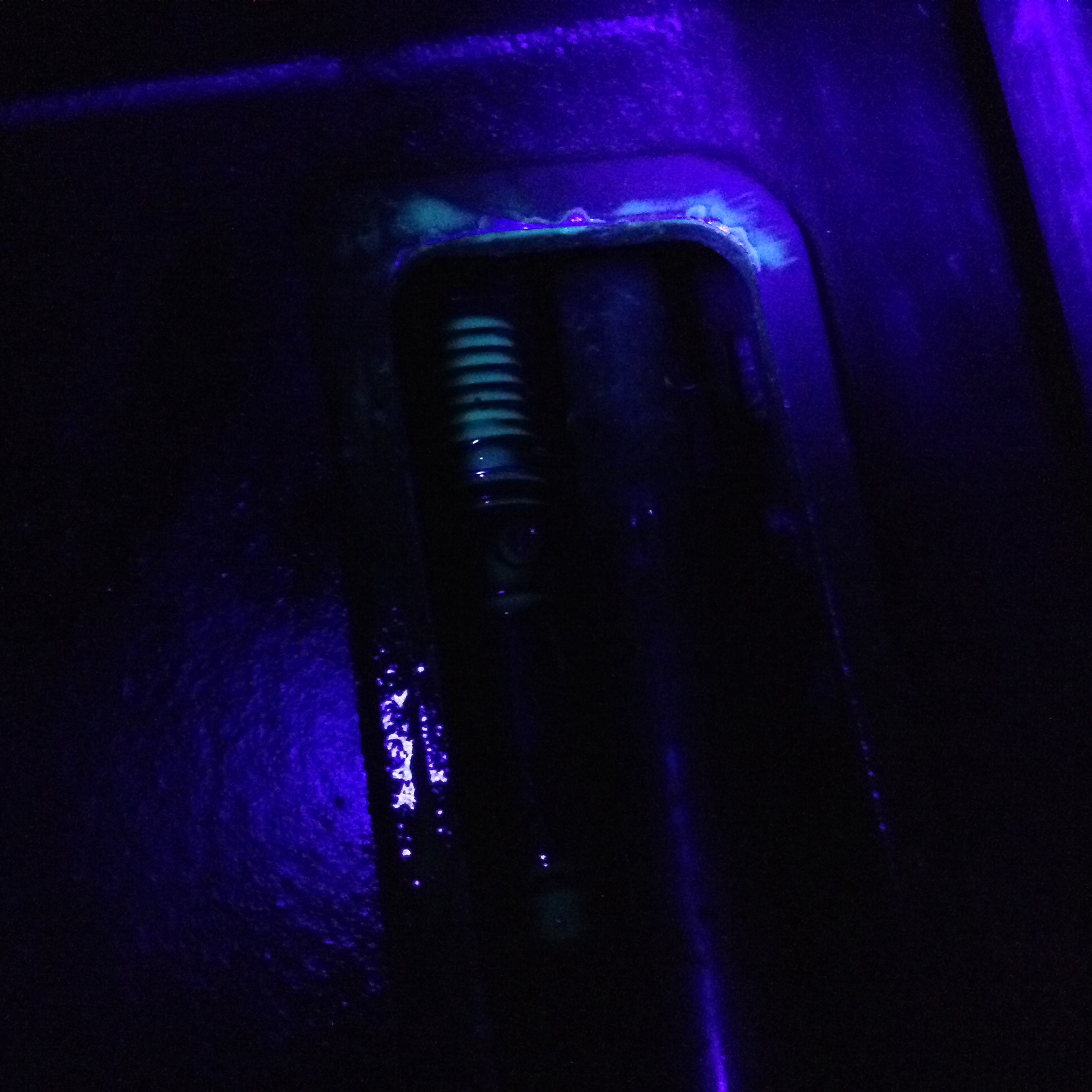

Well, the HST seal kit is on order (and bearings, springs, clips, o-rings, etc) and we will be splitting the TC24d next week. I believe the problem is at the HST pump part of the transmission atline attachment or first seal and it will not be possible to pinpoint that location until the case is off. The rear universal and spline are bone dry, no dye showing but the front is dripping and faster when the machine warms up. Trying to attach some UV photos.

The rear universal shows a UV pink which presumably is an assembly mark, possibly an anti- tinkering mark? The rear area is bone dry. The UV green showing on the Forward/reverse damper is the newly dyed & leaking hydraulic fluid. It then falls on the drive shaft and down to the forward boot.
