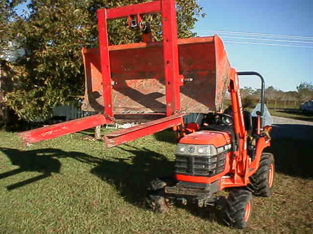

I've been using one for the past year, it fits the BX2200 fine, and I have even adapted it to fit on the FEL to use as forks.as was posted by another member a while back.
see photo

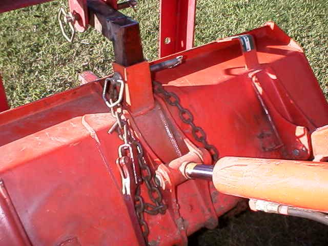

JimC... Thanks for the information. How did you attach it to the bucket?
John
   / TSC Carry All, BX2200 #9
I welded a plate that goes under the lip of the FEL and the carry all sets on top of the front edge of the FEL,

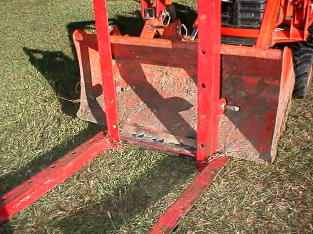

Then I use a chain and a small boomer to hold the bottom of the carry all to the FEL
