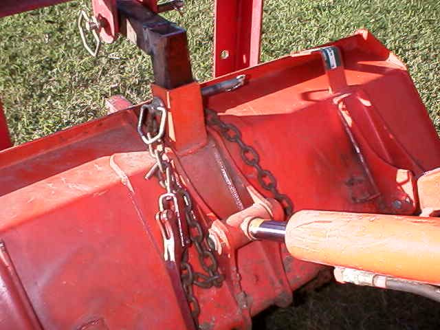

And the top of the carry all attaches to the trailer hitch socket I attached to the back of the FEL
I discribed the trailer hitch in a previous port under atachments a few months ago.
see photo

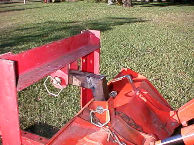

   / TSC Carry All, BX2200 #12
A better view of where the chain to hold the bottom of the carry all attaches
JimC

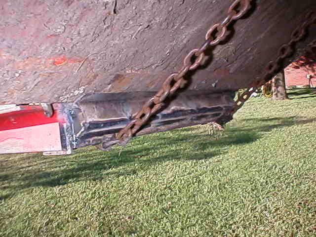

   / TSC Carry All, BX2200 #13
There are two plates added to the carry all that fit above and below the FEL lip.
JimC

JimC... Thanks for all of those photos. I can see exactly how you attached the carry all.
John
