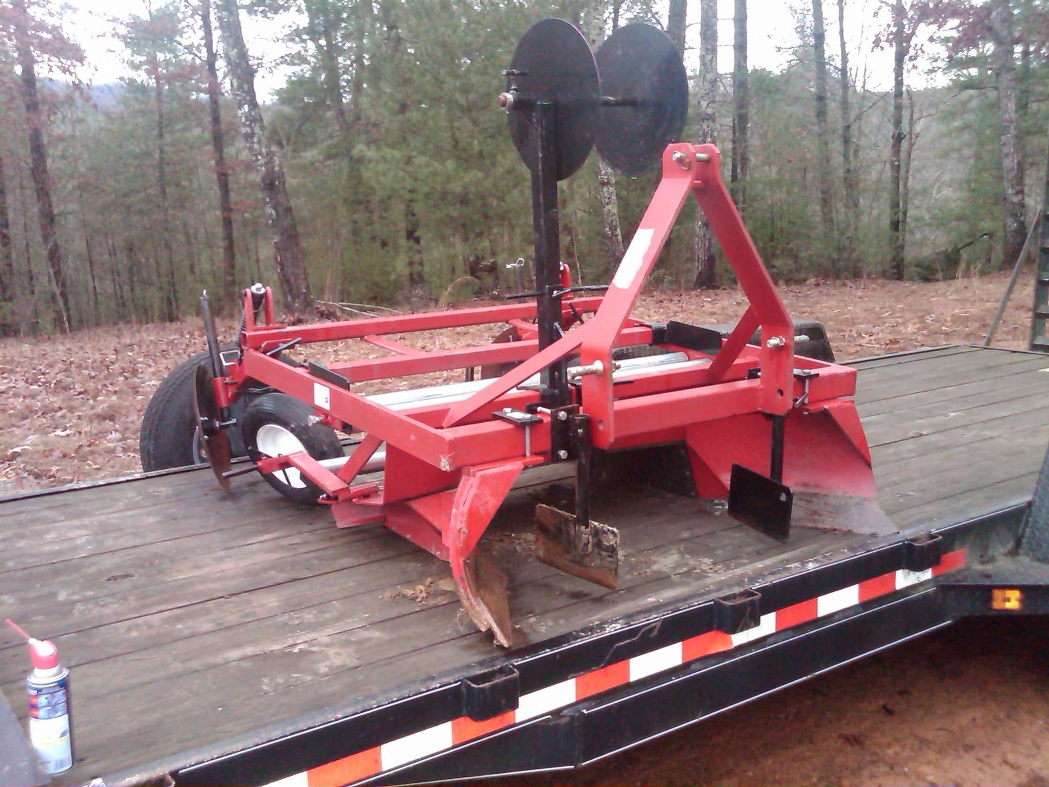

Yea, I was kind of proud of my hand filing when I only had 3 teeth where the angle was a little off.
I would have tried it out the past Saturday but I spent the day picking this thing up.

Now you've got my attention...... I have no idea..... Maybe an attachment to fill a trench???? The spool would indicate that it lays some kind or cable or wire??? Again,,,,, I have no idea!!!! :confused:

Is that one of those gizmos that lays agricultural fabric down and covers the edges with soil so the wind does not catch it?
